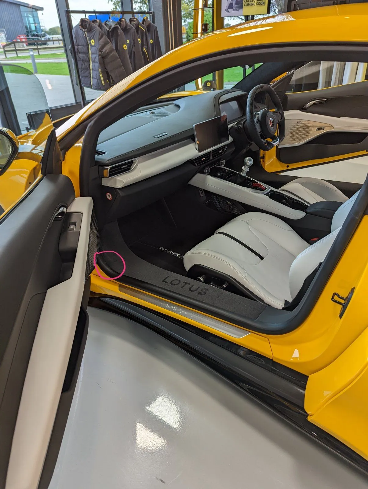

To my understanding we have one more to add to the list:
I am lacking the appropriate wording to explain it in English, surely anybody here will help.
On the Demo car that arrived this week in Bilbao I spotted on both sills what I consider a bad fitting of the rubber strip on top of the carpet. I forgot to take pictures, you can barely spot it on the video I took of the inside, I also saw on the video of the Japanese car, and on one of the yellow demos in UK, and I thought may these cars where not final custom version, but I just saw it also on the customer car just delivered in Hethel.
Confirmation from members in here with customer cars delivered would be appreciated, and if Lotus is aware and solutions to this issue for both existing and new deliveries
Picture of !st Hethel collection: @shaank could confirm if he sees this as an issue
