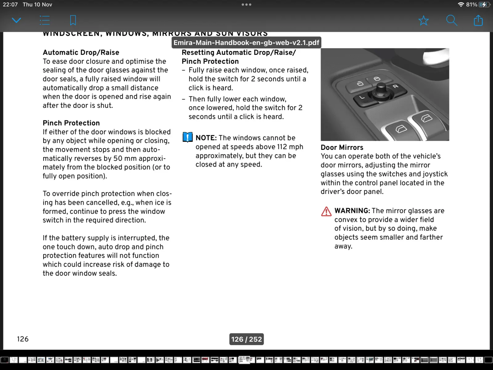

Have you tried the window stop reset?Has any noticed a wind noise at high speed? you might not notice in ‘Sport mode’ as there is too much else going on. I think it’s from the door seal. Is this issue unique to my car? I can hear it on driver and passenger side. I’ve tried folding in the mirrors so see if that improved things, which it didn’t.
wind noise on car I tested today, looks like door window not sealing or pressing into seal sufficiently. Dropped both windows down and closed but no difference. Same as in my Evora400 which had seals replaced but still an issue. I think it maybe a door location issue. Good luck in getting it sorted, I never did.Has anyone else noticed a wind noise at high speeds? Please can people on a test drive listen out?
Thank you for the info. I’ve advised CS of the issue but explained I don’t want to book in until there is a fix. I don’t want to make loads of journeys back and forth trying to resolve the issue.wind noise on car I tested today, looks like door window not sealing or pressing into seal sufficiently. Dropped both windows down and closed but no difference. Same as in my Evora400 which had seals replaced but still an issue. I think it maybe a door location issue. Good luck in getting it sorted, I never did.![]()
If it continues after replacing seals, Sounds more like a door adjustment problemThank you for the info. I’ve advised CS of the issue but explained I don’t want to book in until there is a fix. I don’t want to make loads of journeys back and forth trying to resolve the issue.
