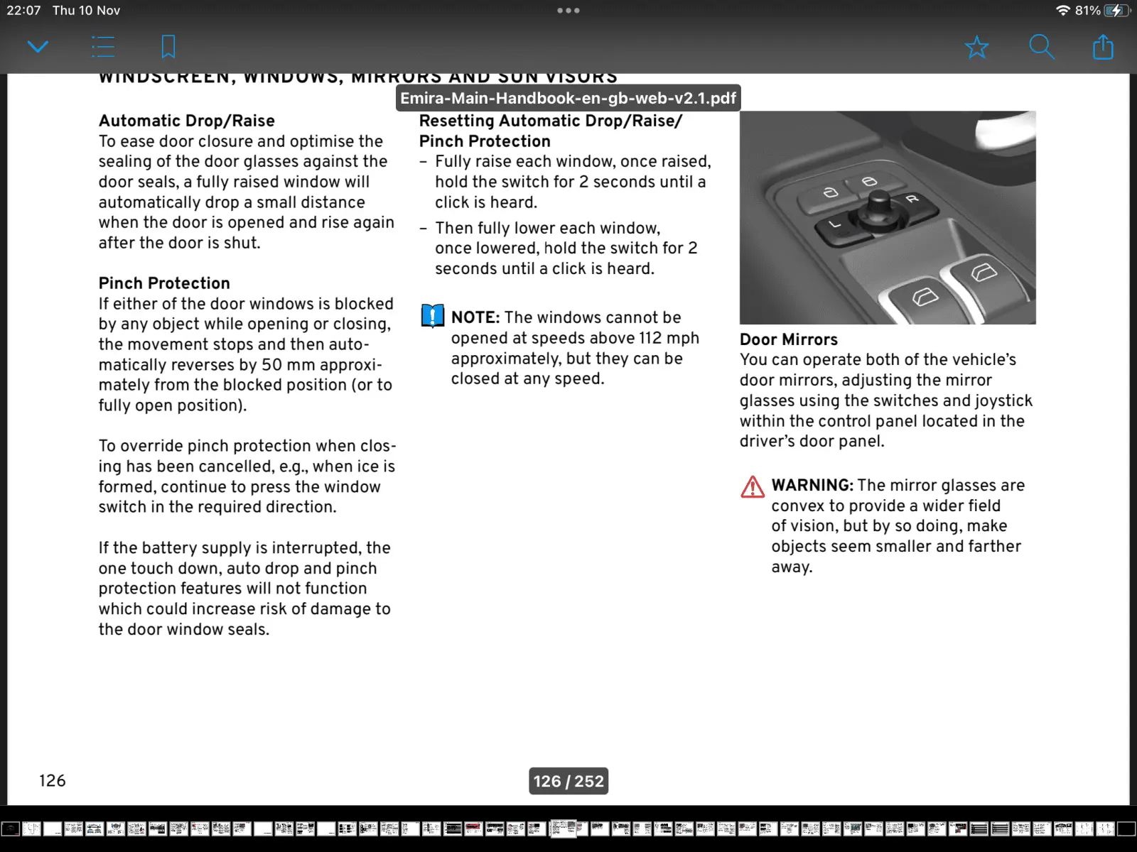

I get some whistling on the drivers side window at higher speeds. It seems to go away if i ever so slightly drop the window from it’s upmost position. Need to have a better look at it, see if there is anything obvious.
Yup that's how my Tesla windows were doing. Slight drop of the window would eliminate the noise. I'm really thinking the window tracks needs to be pushed inwards if windows gaskets are good. Try putting a suction cup with a handle. When you hear the noise try pulling the window inwards and see if makes a better seal?
I’ll give that a try.
Now where to find my trusty suction pads…

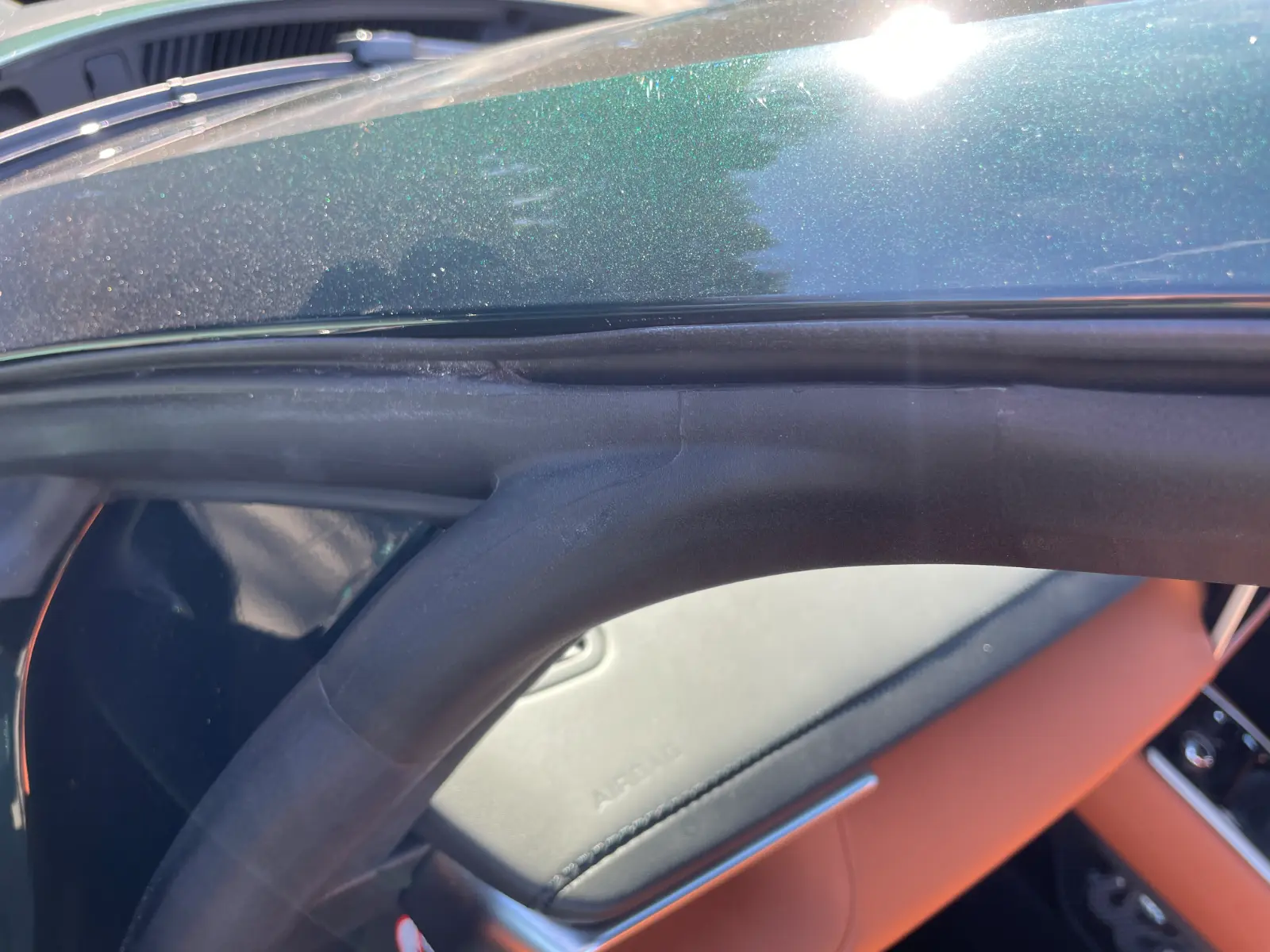

Have u got wind noise? If so check the door window seal is seated correctly.
Again this wasn't done when car was in transit mode on the Central demo car. And someone had to come out to seat it correctly (just pushed in I believe)

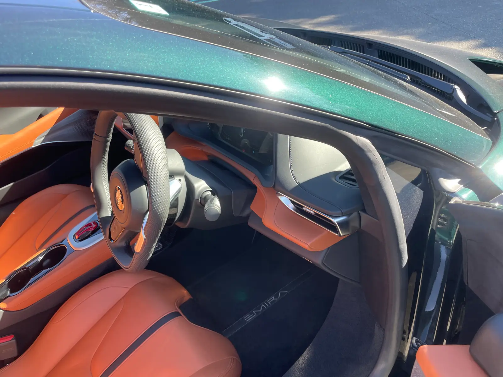

I had the same problem with my 2024 Emira, the passenger side and the driver side were obviously different shape, the passenger side had some kind of glue on it.
