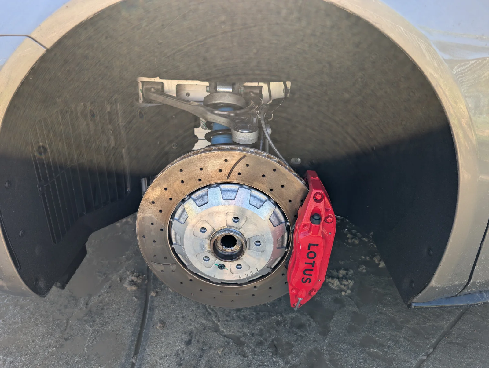

Obviously late to the party but the rotors can be pretty sus. I haven't actually had any noticeable issues from mine but if you look this picture of one of my front rotors near the caliper youll see where theres some extra grinding that happened on it. I think someone dropped the rotor at some point and they had to grind that bit off to correct it. Also of note the paint for the calipers is really thin and fragile.
Obviously late to the party but the rotors can be pretty sus. I haven't actually had any noticeable issues from mine but if you look this picture of one of my front rotors near the caliper youll see where theres some extra grinding that happened on it. I think someone dropped the rotor at some point and they had to grind that bit off to correct it. Also of note the paint for the calipers is really thin and fragile. View attachment 78848
No, that’s how they are shaped. Everyone has flats on theirs.
That's how rotors are balanced.
That makes a lot of sense. Thanks for the knowledge drop. Ive edited the original post to account for my lacking.
