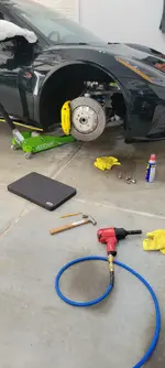

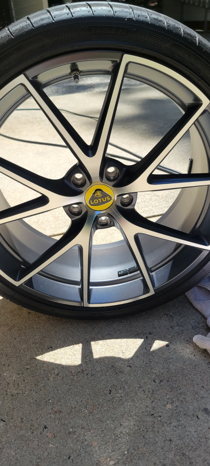

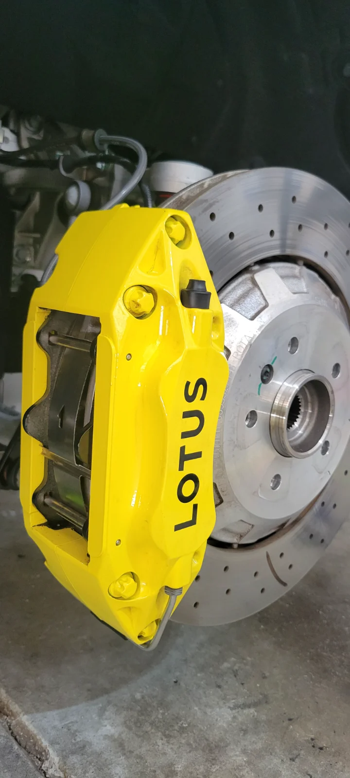

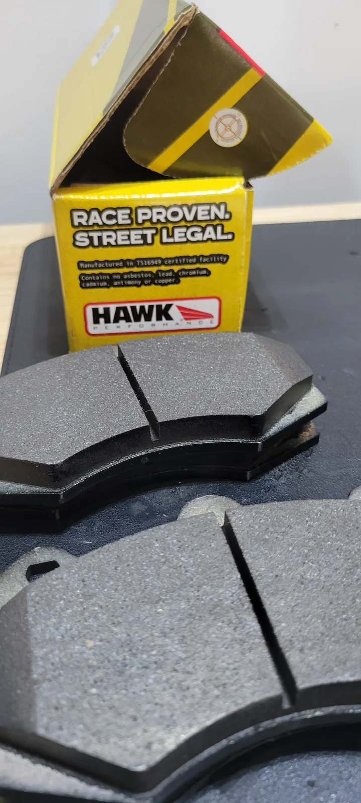

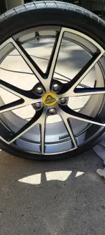

I'm nearing 5K miles on my '24 Emira and just installed my Hawk ceramic pads. Serious kudos to AP Racing for the most excellent caliper design ever -- 100% easiest pad change I've ever done! I had to remove the shims from the Hawk rears, they were just not going to go in without a fight -- we'll see how they do without them. I did one side (front and rear) at a time, took about 40 mins each side including cleaning up the wheels. Still need to go drive and bed in.

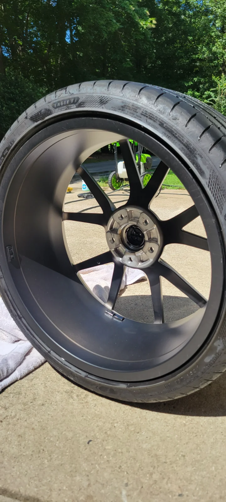

Perhaps you're already aware but maybe it'll help someone else out, if you change tires in the future and they don't have such a thick rim guard on the sidewalls, really think 3 times before placing the rim 'face down' onto the ground.
Look closer, there's a big towel underneath it ;)
Initial report -- like others have mentioned before, these cermic pads provide excellent feedback and a progressive feel from first grab onward, I can absolutely say this was an improvement over the stock pads. I've driven about 60 miles so far and have had zero noise, even during the first break in session. Additionally there's what I would consider a major improvement in the deposit of brake dust at the wheel, caliper, and rear of the car....money well spent!
Following up on my install --- it's been a few weeks and plenty of driving -- even an "OH SHIT" I just got cut off emergency slam on the brakes ---- Flawless, excellent pedal feel, not a single noise from any pad, even the rears with the shims removed, and of course a lot less dust (still some, but much less!) Highly recommend!!!!
