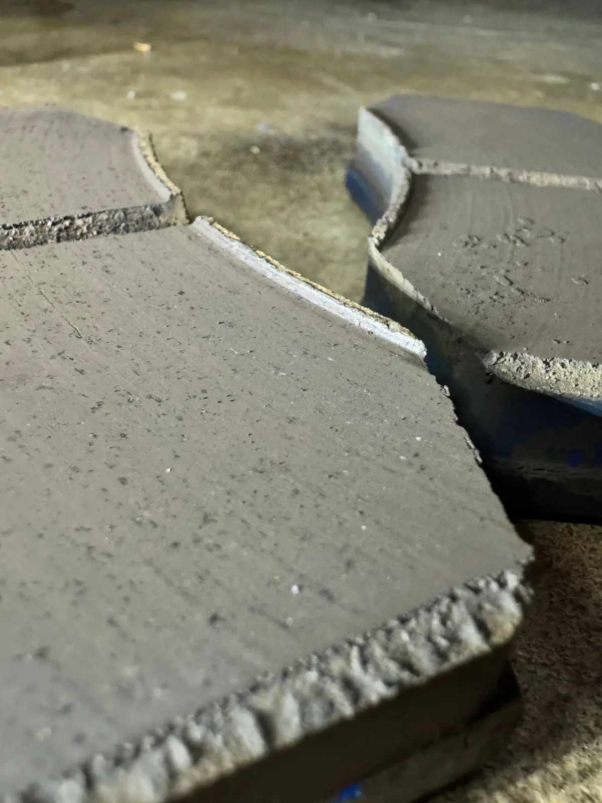

Got the Hawks in the car last night, street bedded them in today on a short drive. I like them and even with the bedding process the dust was minimal. The initial bite is grabby - in between EBC Blue NDX and OEM Brembos I had. Since this is a pad slap I cannot attribute brake noise to only the pads but when the brakes were warm/hot after the bedding process, it would be quite loud braking under 10mph coming to a stop. Once things cooled, I the noise diminished to nothing.
The photo attached are my set of rears for the EBC Blue NDX. As expected a lip formed on the pad as the are not the correct size nor the correct location of the holes for the retaining clips to ensure the pad material sits squarely on the face of the rotor. I guess EBC found an additional surface to grab onto...
1 track day, 1 very short autox day over the course of 800 miles...I say the EBC Blues wore quickly, dusted terribly, and the noise was not bad most of the time (silent actually) and randomly horrible. They seemed to hold up on track but just wear out faster - the front pads were more worn than the rears (as mostly expected).
Going to see how the Hawk pads do on the street and report back if there's any surprises.

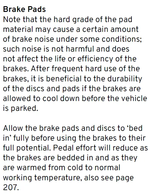

I've noticed the stock pads on my 2025 (no idea what brand/model they are - the manual specifies brake fluid brand but no mention of pads) don't make noise when cold, but squeal embarrassingly loudly at every traffic light stop when they get warm after a modestly spirited drive, or even just regular around town now that summer is here. Many here have said their OEM pads don't squeak. Looks like most people say the Hawk Ceramic don't squeak and will initially bite less.
I'm wondering if the 2025's have a noisier brake pad, or it noise only when brakes are hot is not a pad problem at all and I should be troubleshooting something else?
Interestingly the manuals of both the '25 (page 196) and '22 (page 163) just basically say to expect noisy brakes:
