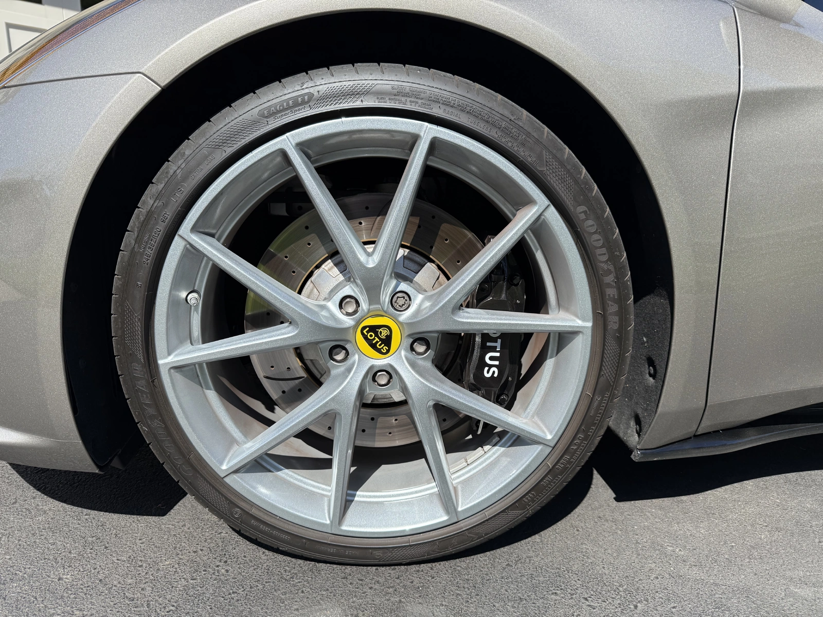

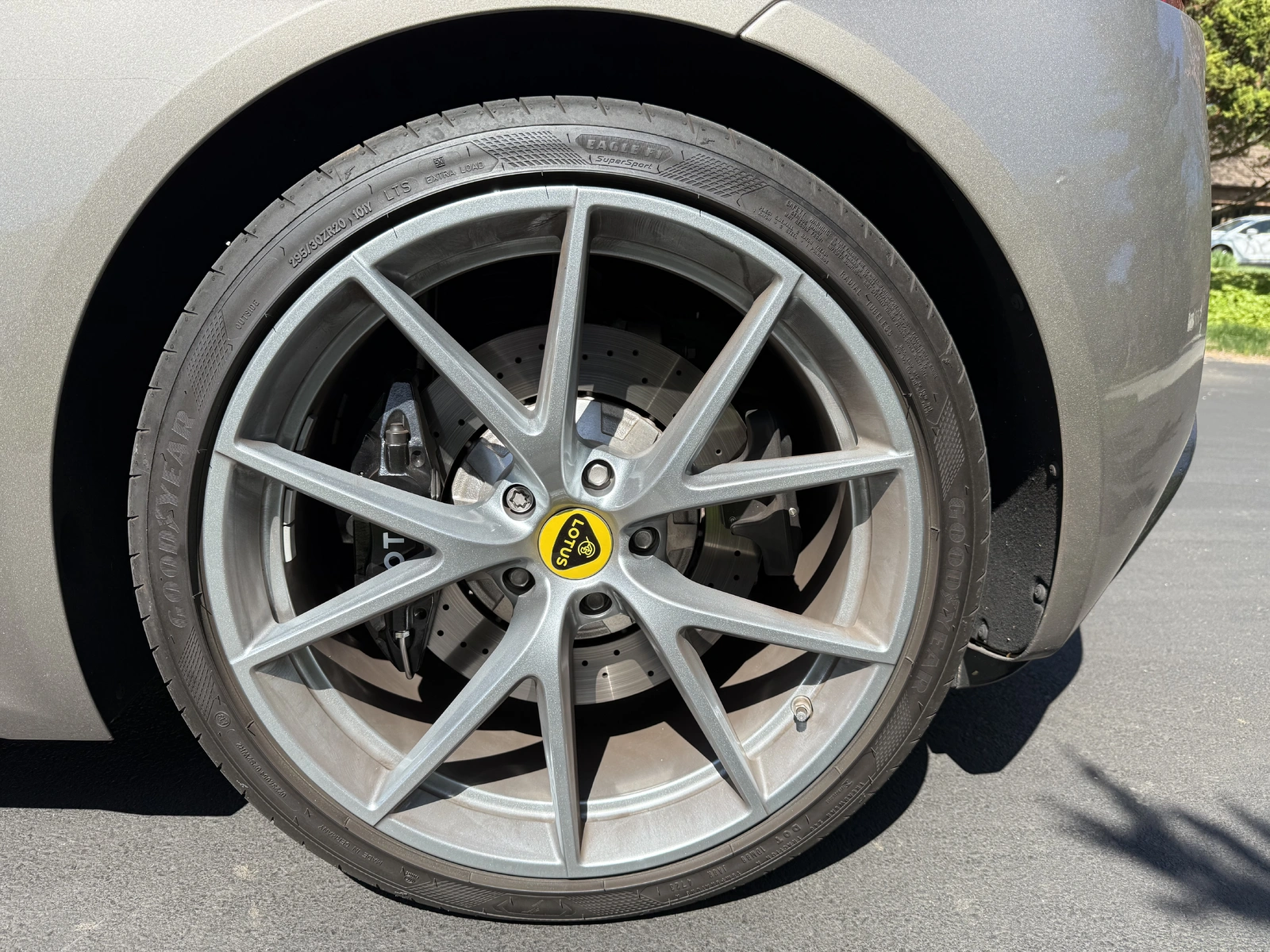

So I still only have the Hawk ceramics on my front but I am still very happy with them. Just much better feel and not grabby. Sometimes a little noise when coming to a stop but I think it’s just when they get too cold. They are definitely less dusty than OEM. See pics of front vs rear.
Same for me. Went out for a long spirited drive and when I came back, it had significantly less brake dust than the OEM pads. Really like these
