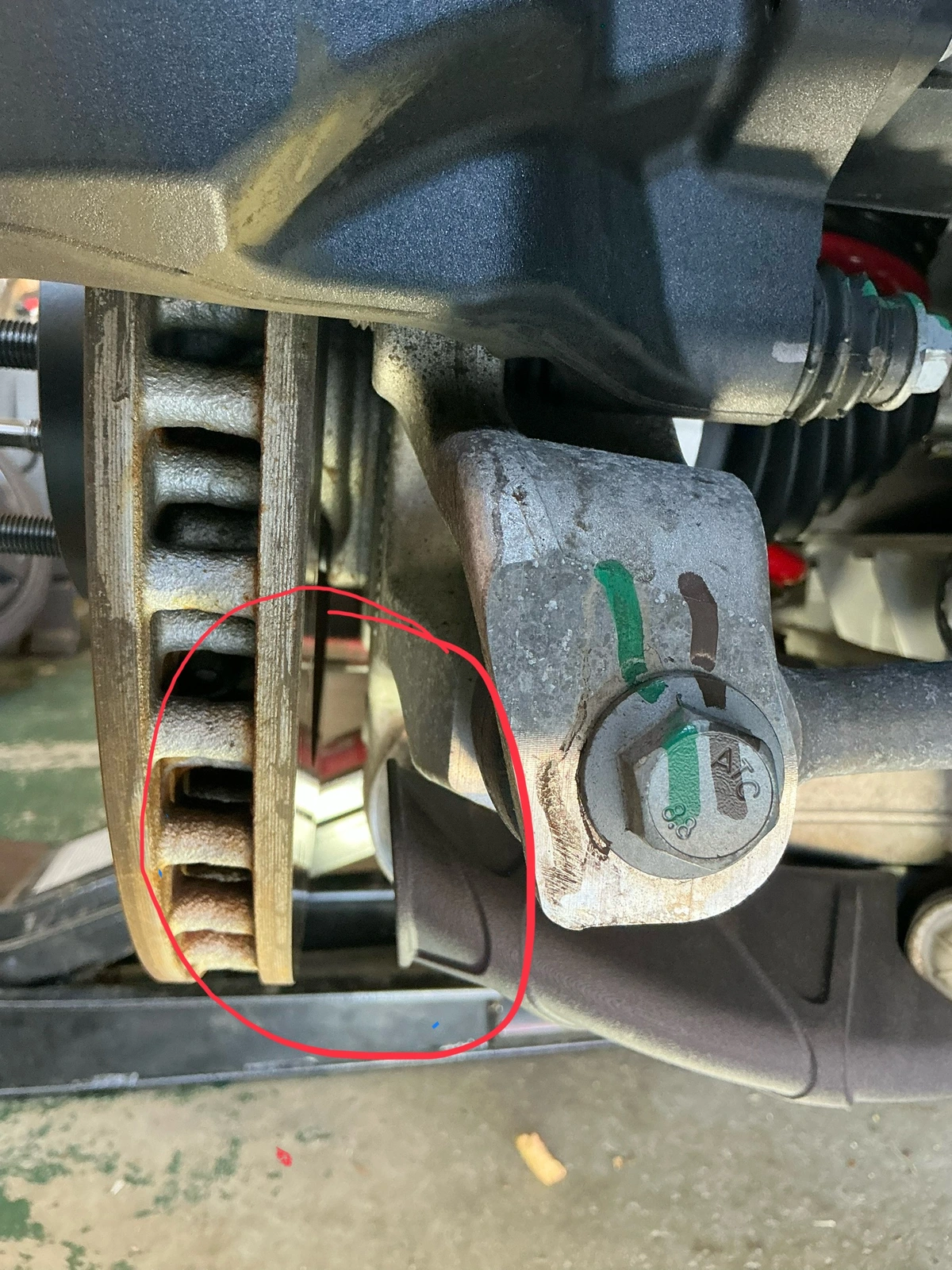

I drive pretty aggressively so brake cooling is important to my upgrades. Hence, eventual Ultradisc rotors and Tarox Corsa pad conversion.

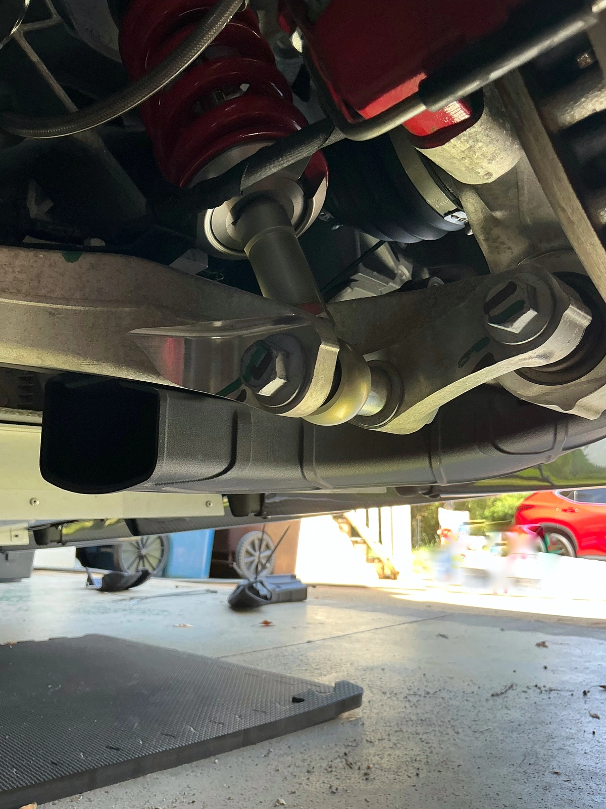

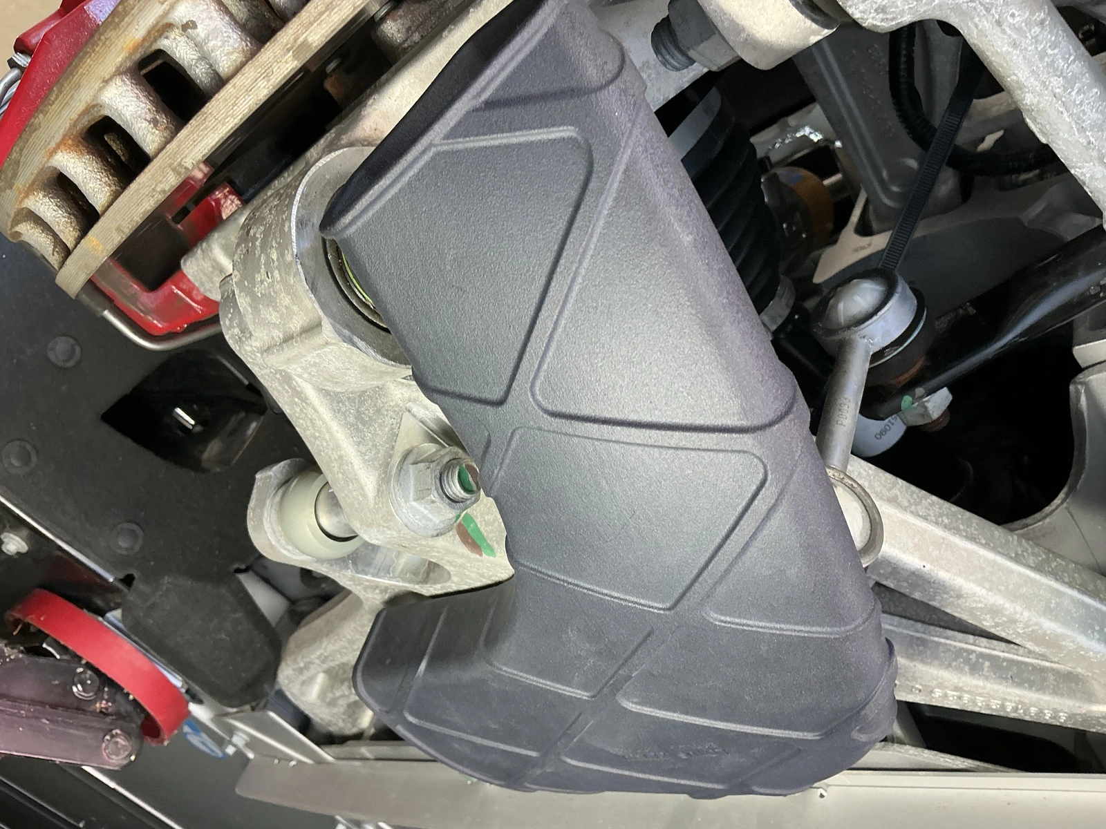

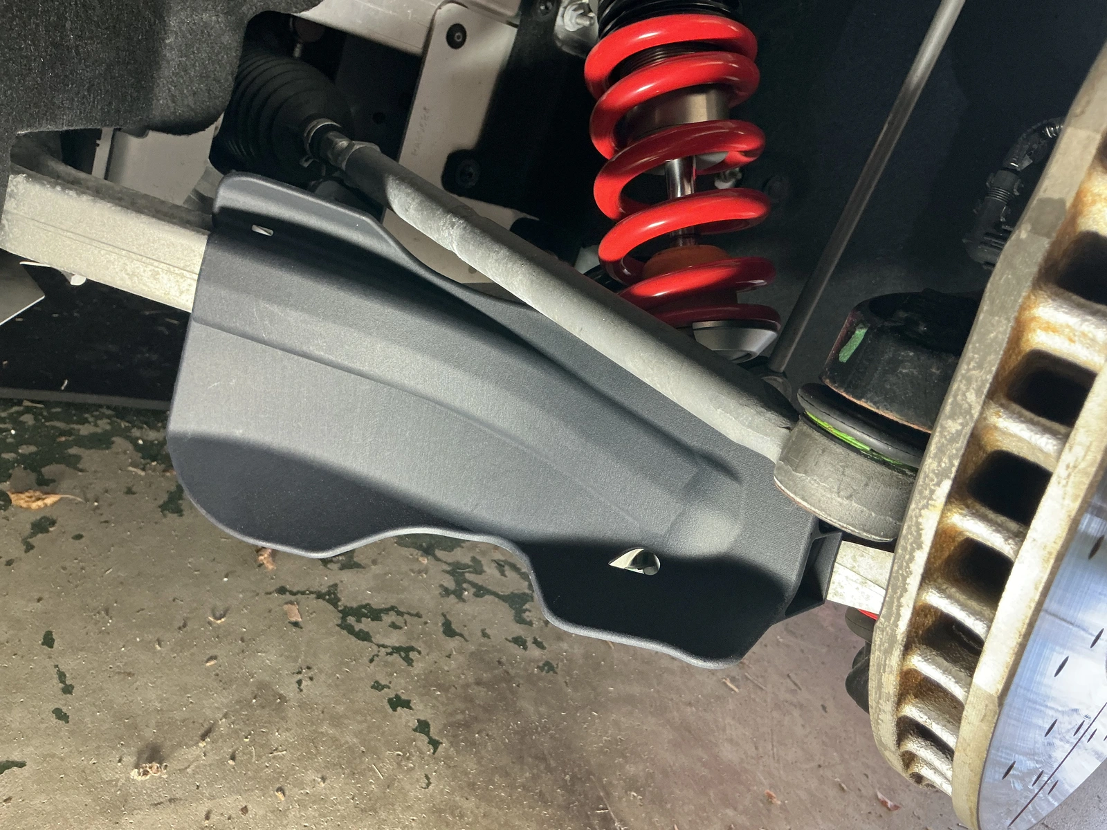

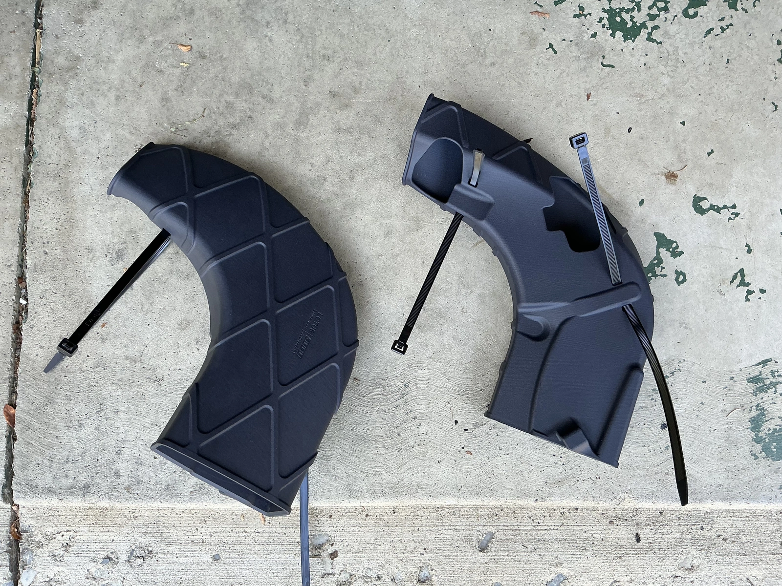

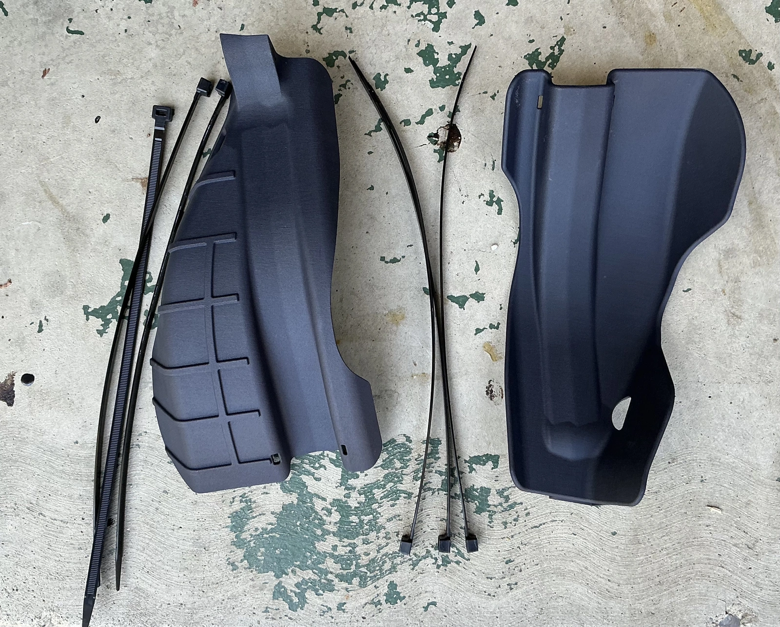

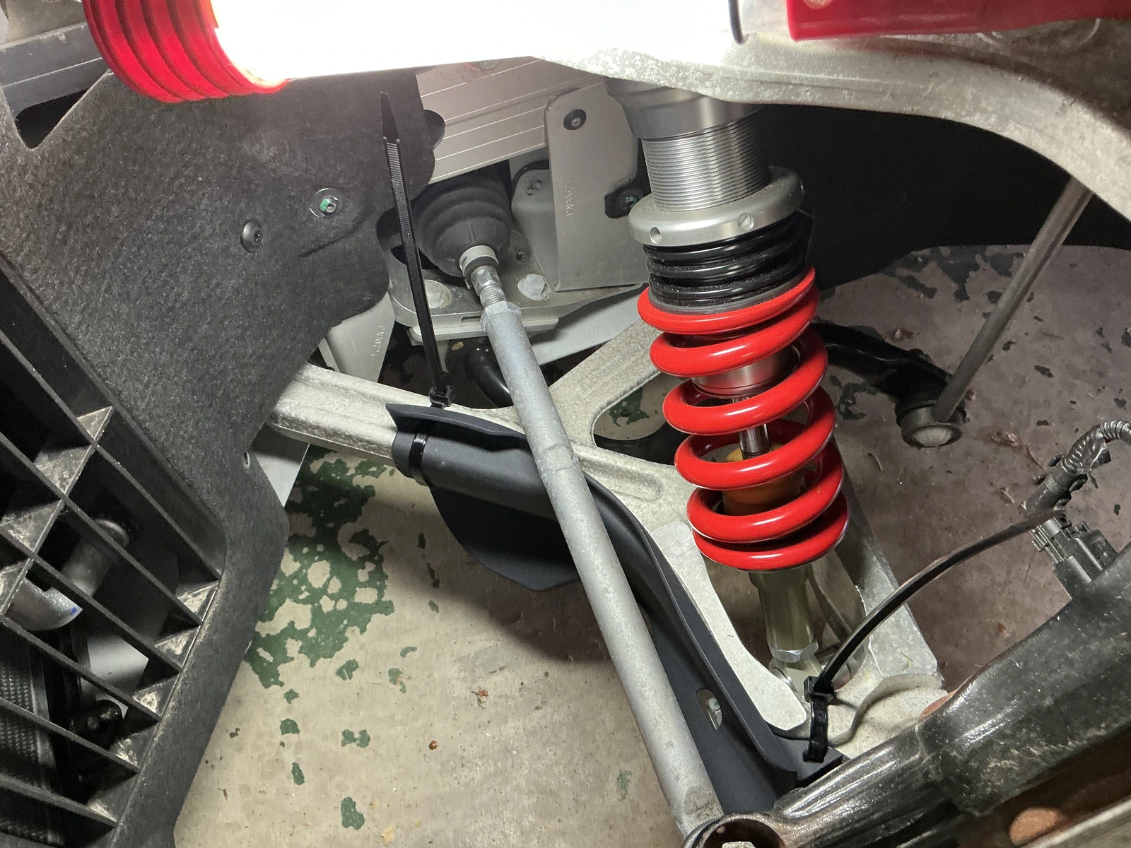

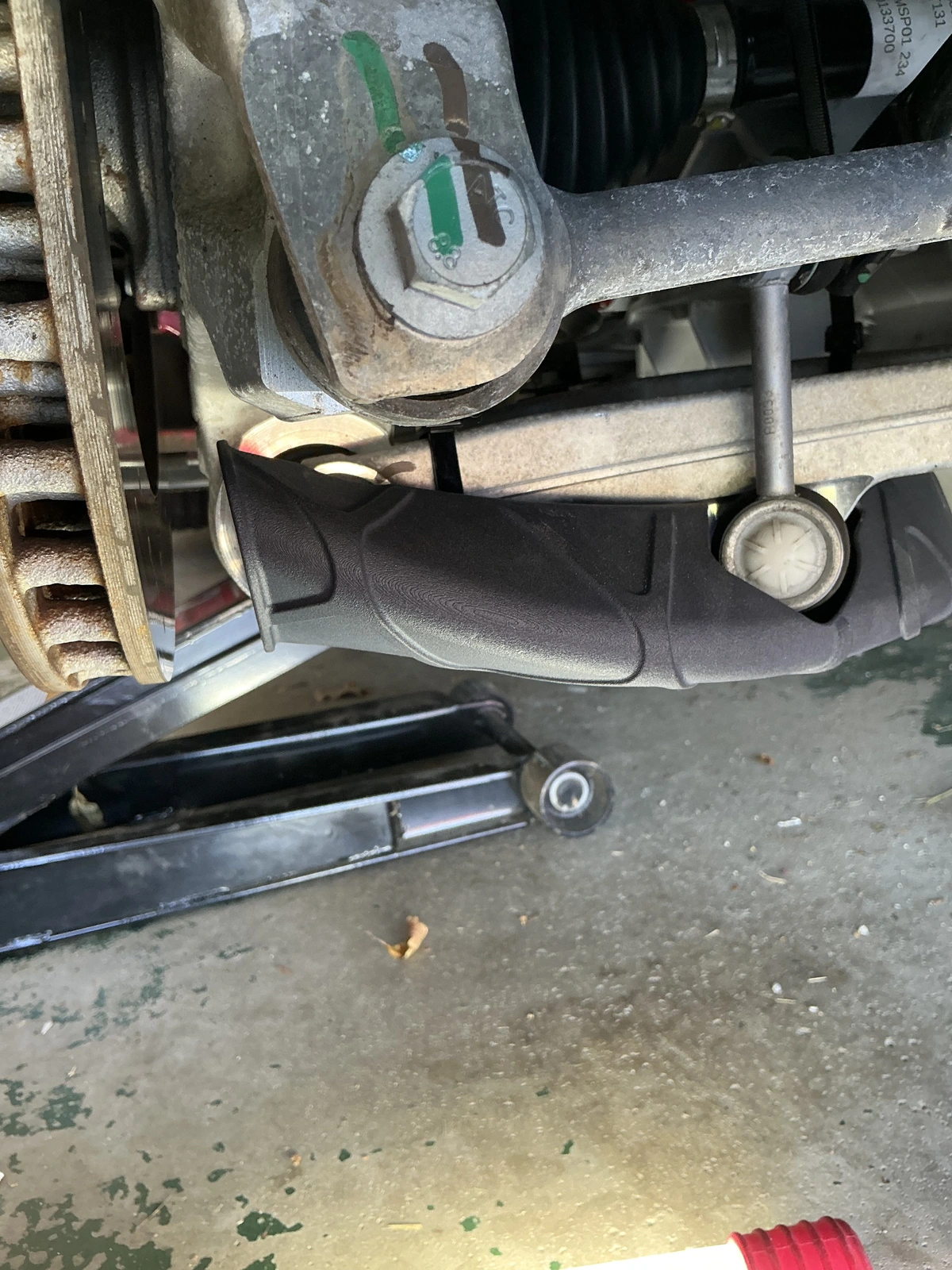

I have to say that these cooling ducts are very high quality, injected molded plastic thick and sturdy precisely fitted. I was hopeful that it was not going to be the very thin plastic duct type we see generically. It was a quick 5-10 minute install for each duct once you remove the wheel (or lift the car). Left and right sides were labeled on each duct to help ease of installation. Cut outs for swaybar endlink bearing and adequate clearance for endlink movement were spot on.
FRONT ducts sit and conform snugly on the lower wishbone and are secured by two supplied thick zip ties. The lowest point of the air scoop sits no lower than black triangular piece on the front bumper. So even if lowered, air scoop is clear.
REAR ducts mount below the lower wishbone secured by the 2 thick cable ties. Again swaybar endlink cutout and adequate clearance for movement were spot on. Lower edge does not sit below lowest point of metal undertray vents.

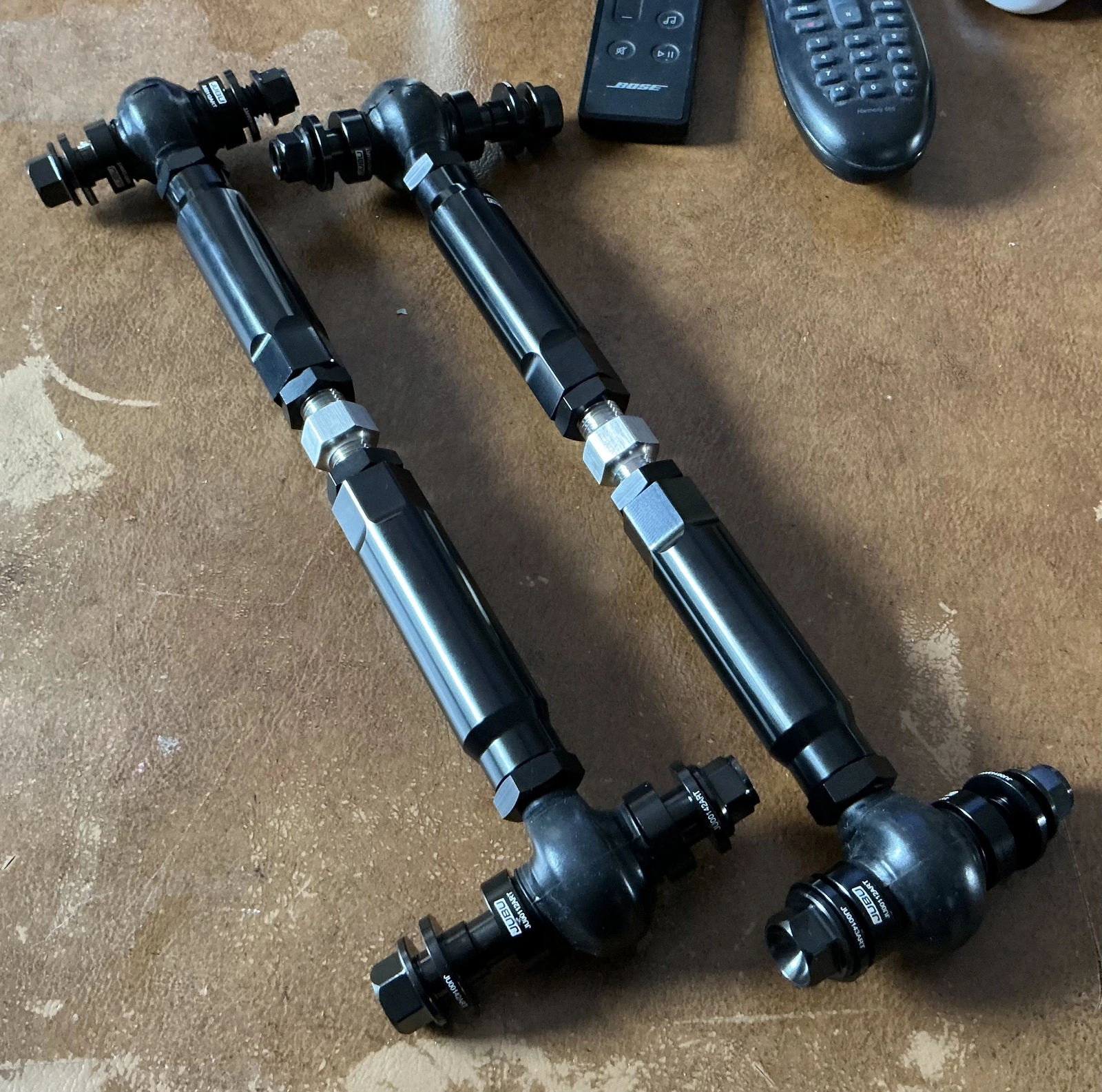

Next up are these…i thought maybe i could install these without removing rear diffuser and metal undertray but would have been challenging for cheater bar and torque wrench.
