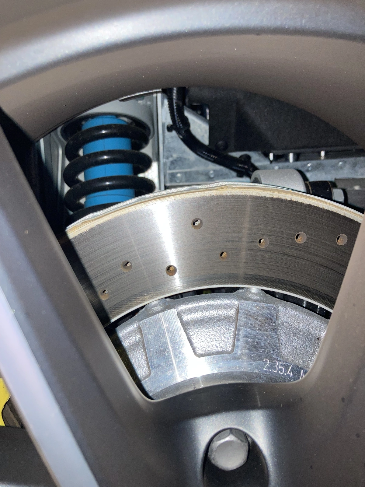

Not a race issue, but Anyone happen to notice scoring at the disc edges on the rear or any scalloping of the disc?
Ordered new. Have only put 260 miles on since taking delivery last week. Was doing some cleaning and noticed what looks like scoring at the rear disc edges and also an area that appears slightly scalloped.
Any thoughts?
Any thoughts?
I didn’t notice this issue before. Just checked my rear brake and it looks fine for me. But I have a new brake pad on the way. I’ll install and see what going on with new pad.
Any thoughts?
Asked many times, my understanding is that it is done during manufacturing to balance the discs...
Interesting.
It makes sense that they would balance the discs, I just had never noticed this on any of my cars before
Thanks for the info!
