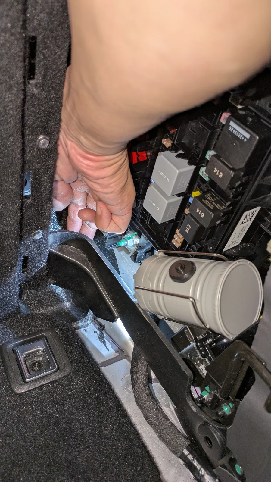

You approach the Rear Quarter Insert Trim Panel, a stubborn guardian of secrets. With a firm grip and a steady pull, it yields, revealing the Rear Quarter Trim, a shimmering wall of mystery.

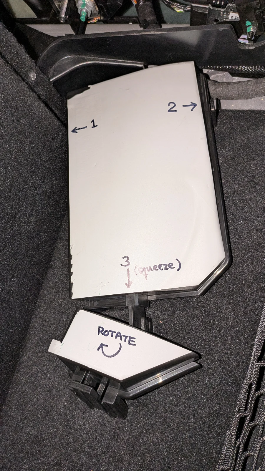

Next, the Fuse Box Cover, a two-headed puzzle. You unclick the Lower Piece, push it toward the rear while rotating it clockwise — an ancient dance of dexterity. Then, with the precision of a lockpick master, you undo the three sacred clips of the Upper Piece.
The chamber breathes open.

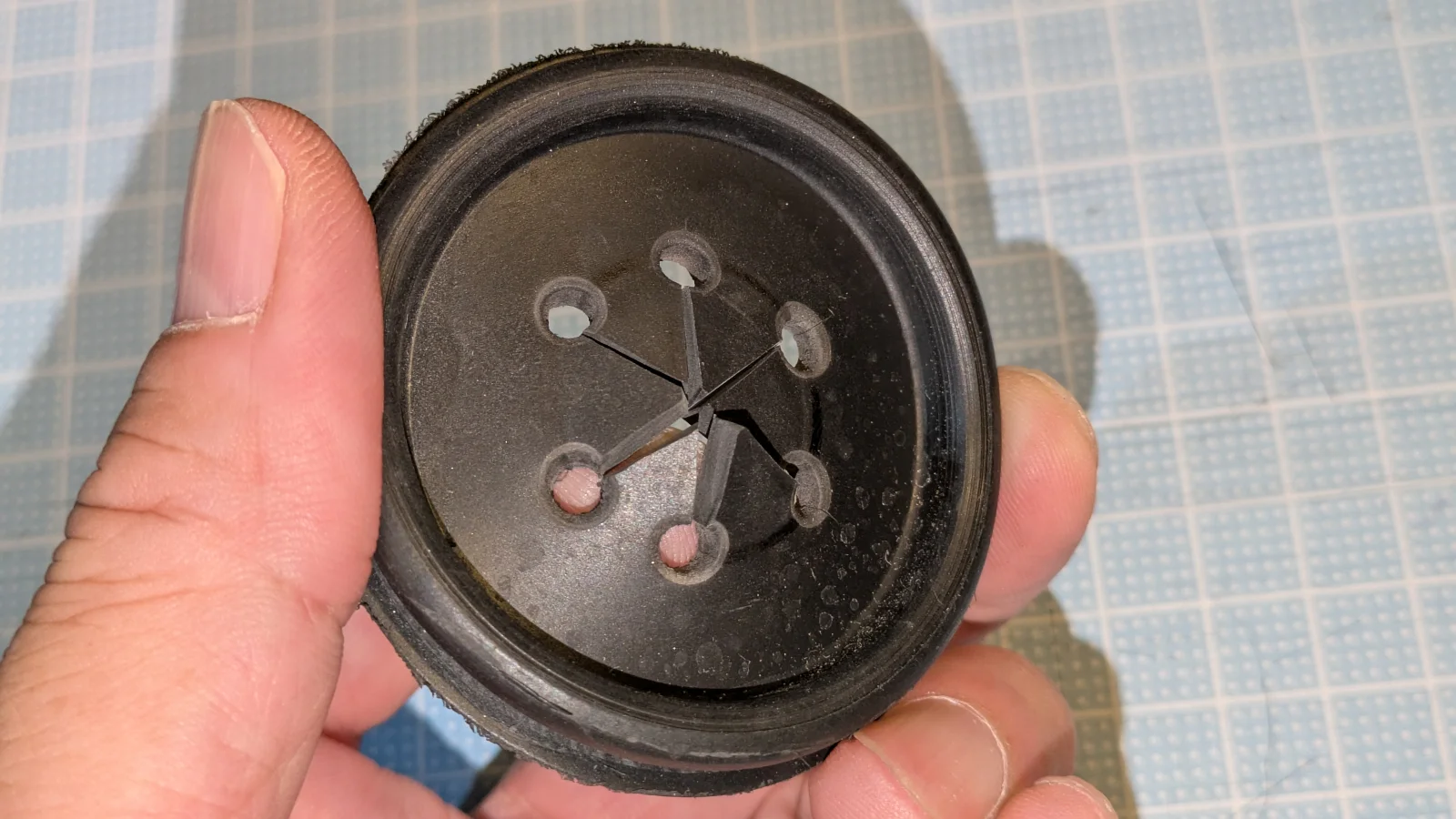

You slide your fingers into the shadows and grasp the rubber beast. It resists, but you are resolute. With a twist and a pull, and maybe a flathead screwdriver, you remove it from its lair.

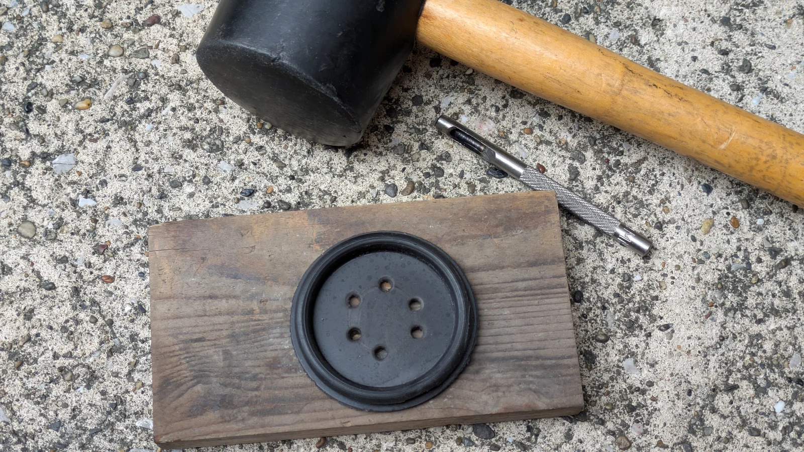

Now comes the forbidden act: the Slicing of the Grommet. With your blade of precision (a utility knife blessed by the gods of insulation), you carve sacred slits into its flesh—just enough to allow the Harness of Unity to pass. Ancient scrolls show mysterious round holes at the end of the slits, perhaps to protect against evil spells.

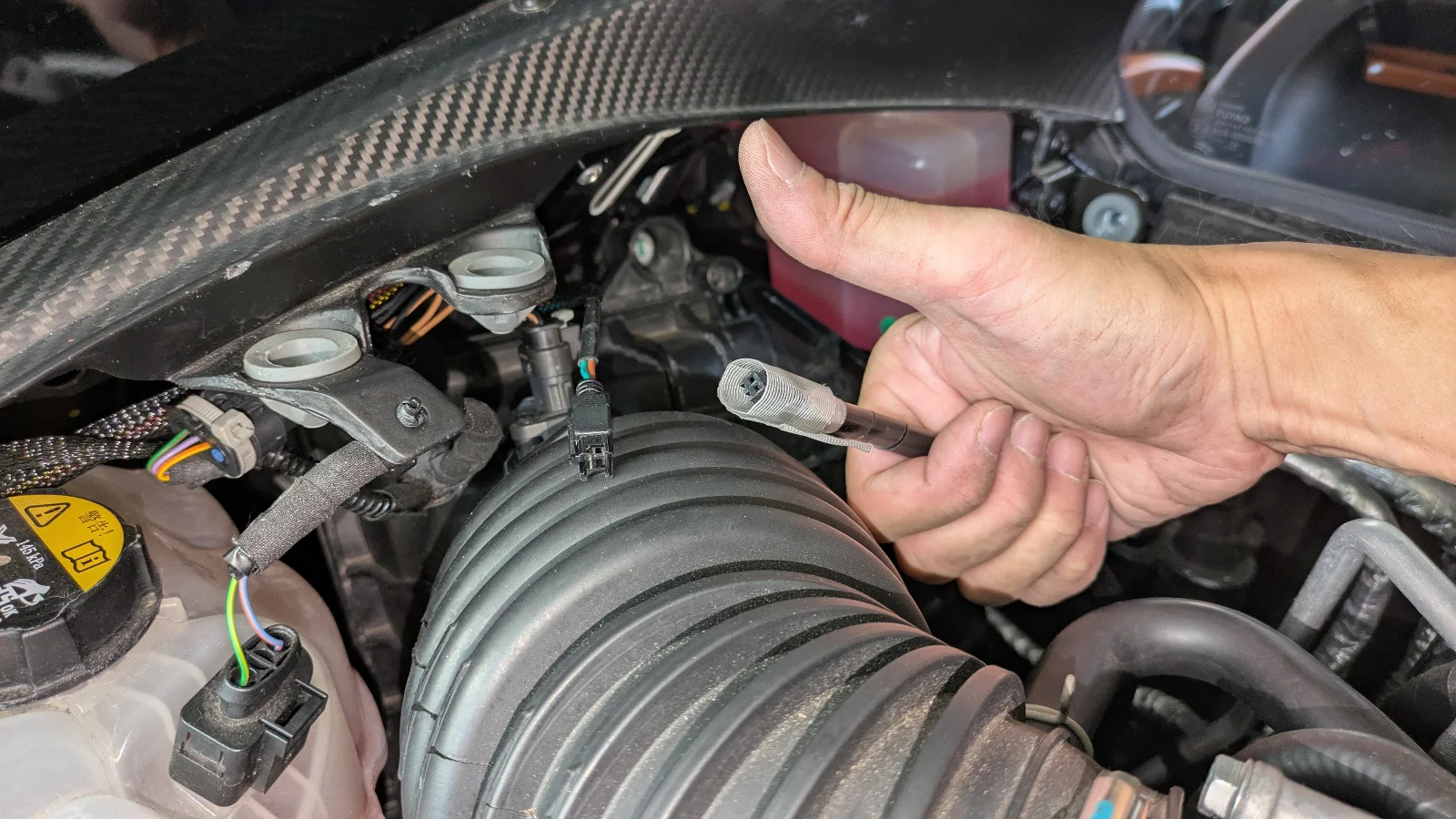

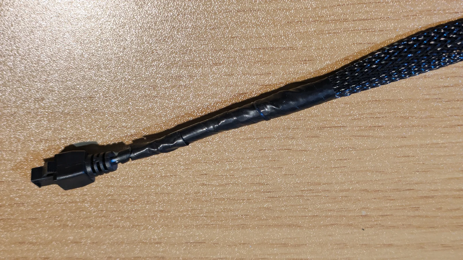

You thread the harness through the wounded Grommet, guiding it through the Firewall's portal. On the other side, in the Engine Bay, you fish it out—like drawing Excalibur from the stone.
You route the cable away from the volcanic vents and serpents of heat, connecting it to its Mating Cable, a twin long lost to time.
