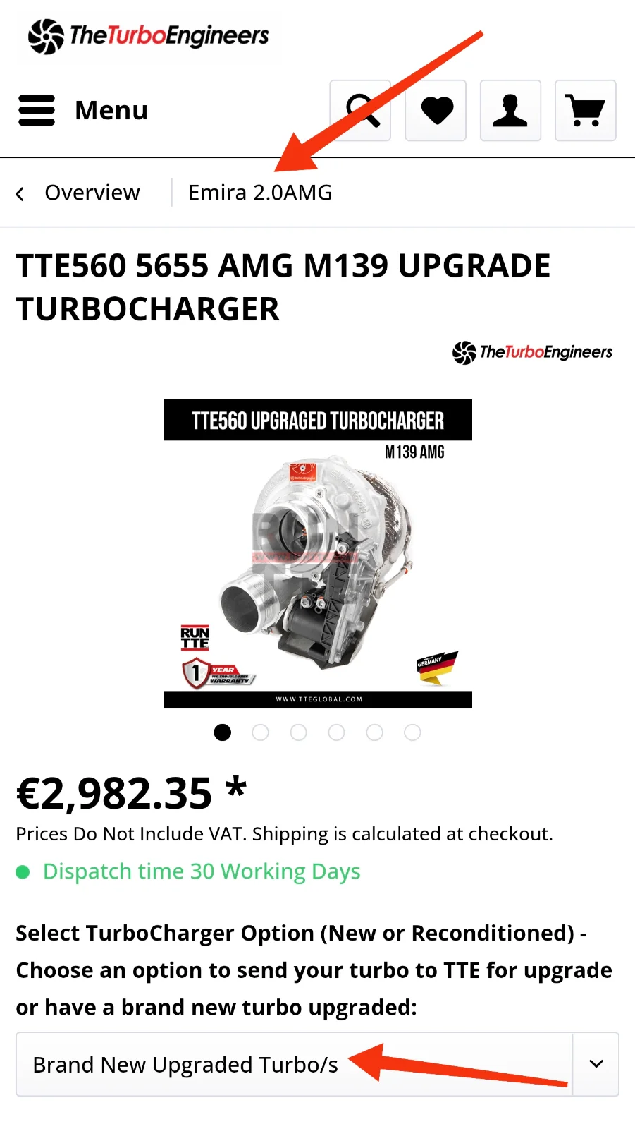

Sounds like a uprated turbo is coming soon.
He brought an uprated turbo when he took delivery of his Emira, which was like 2 years ago lol

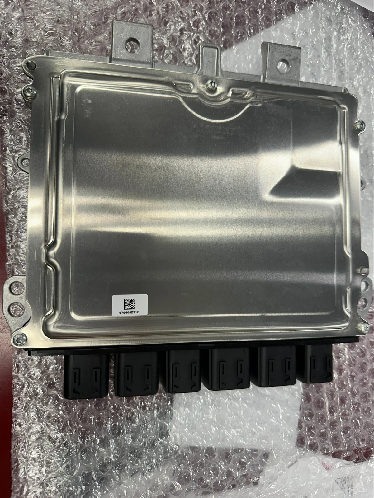

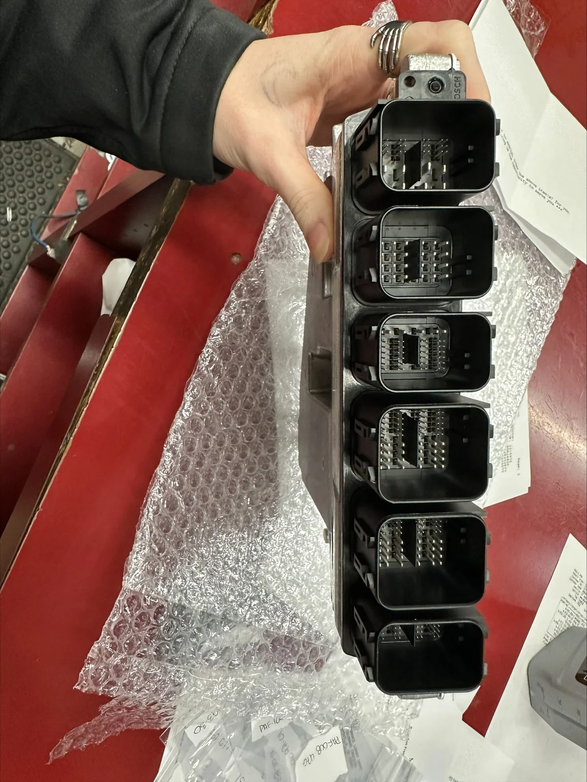

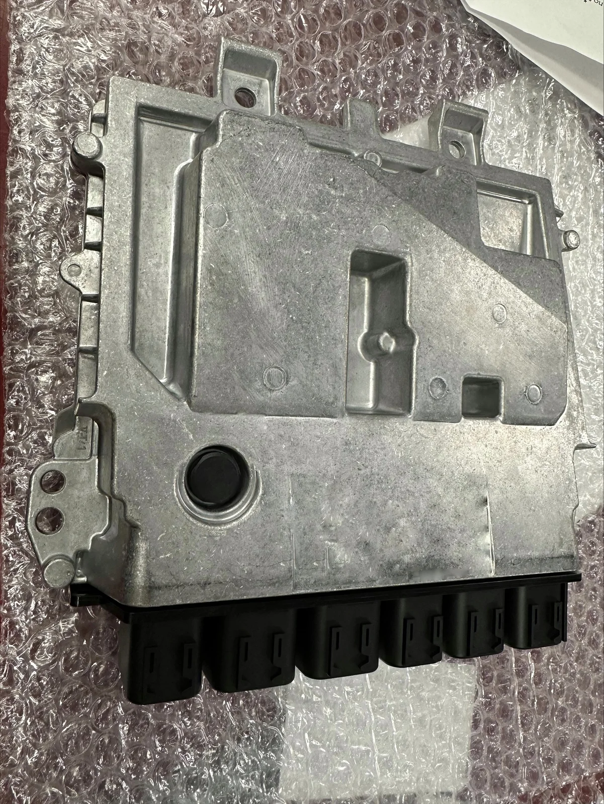

My Parts Manager finally received my new virgin OEM ECU spare from Lotus UK mothership… already shipped to tuner in Oklahoma to be read without/before car specific programming and then will sent back to marry and program to my car at local Lotus Service.
Tuner already has the 2019+ MG1CP002 ECU I sourced from ECU Store. Will post updates for people interested in this adventure in a separate post. Plan to transport my car to Oklahoma for Dimsport dyno and road testing since colder weather coming anyway.
