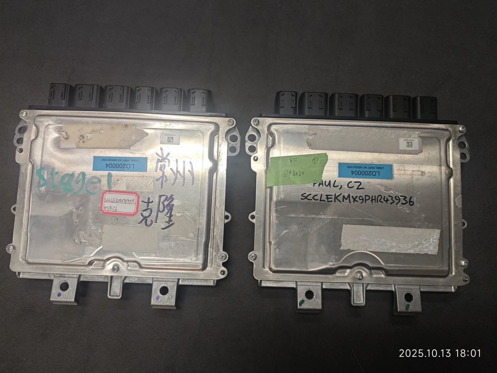

I see VIN in the image of the ECUs above. If no one cares... carry on!

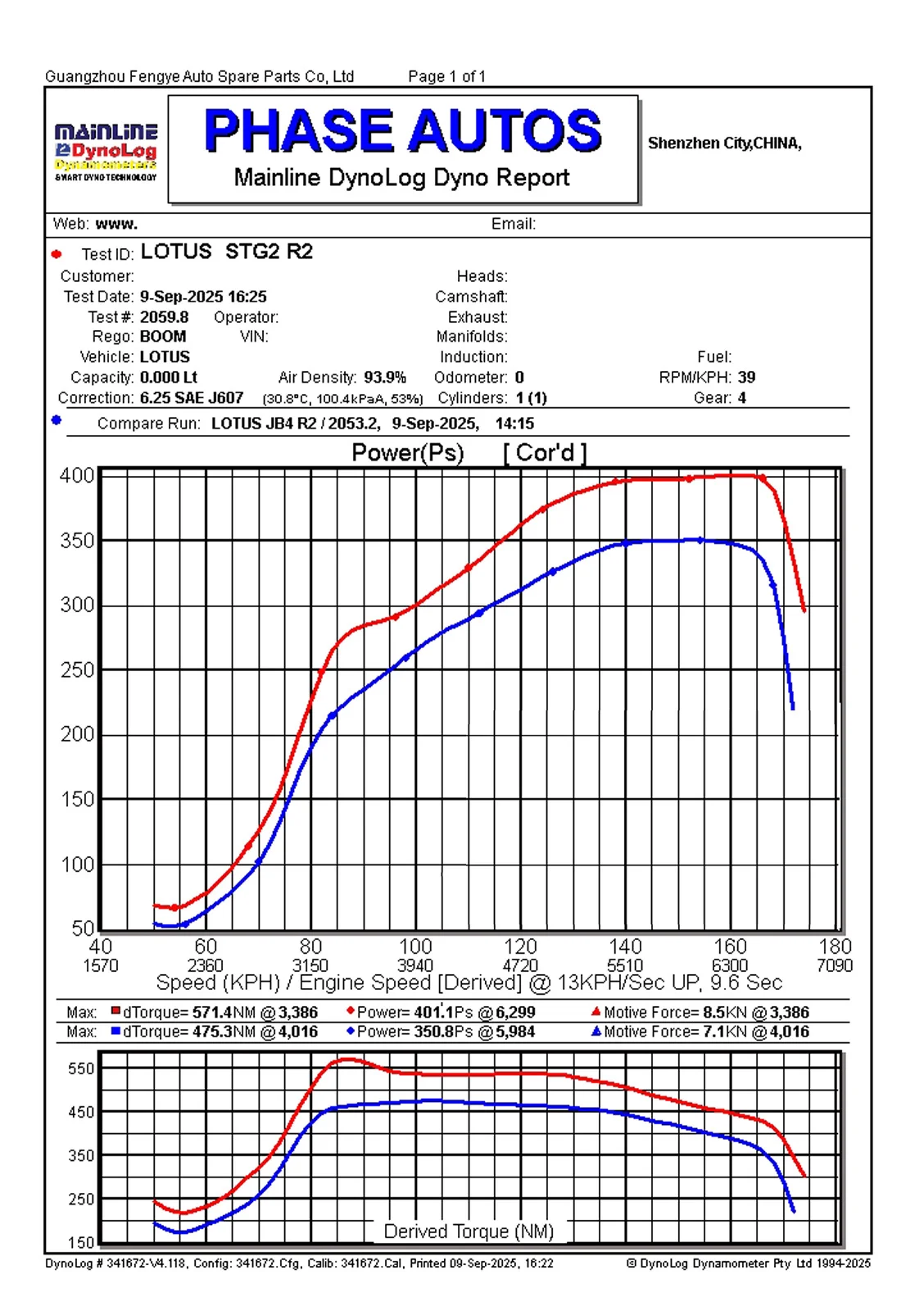

I believe your 93 is equal to China's RON 98, just a different measurement. To be honest I dun think JB4 will give you an extra 65 hp, more like 40-50 hp the most with regular fuel. I have a JB4 myself and did a back to back dyno comparing the output with JB4 and my flash tune, the outcome and the log has no comparison. Plane ticket from Taiwan to China is cheap. Stay a week and go back to be the first 365hp Emira with a flash tune.
Lovely, a dyno chart comparison would be very helpful. Do you have the chart comparison between JB4 and ECU HACK?
Load map for range below 3000 rpm has been updated and now much smoother ride than the setting from factory.
This Emira with the stage 2 must be pretty quick. Looking forward to seeing some real performance figures.
Me too, whenever I thought the weekend would have a nice weather then another typhoon or heavy rain.

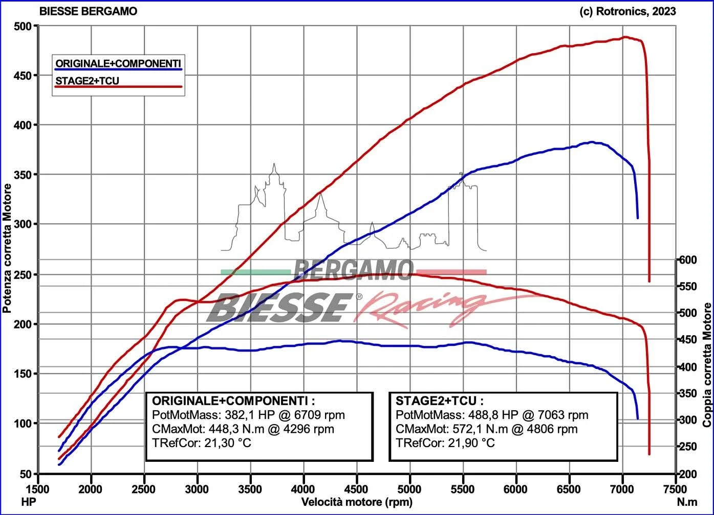

Tuner from Italy:
LOTUS EMIRA 2.0L STAGE2 engine and transmission —> 488 HP, 572 Nm
