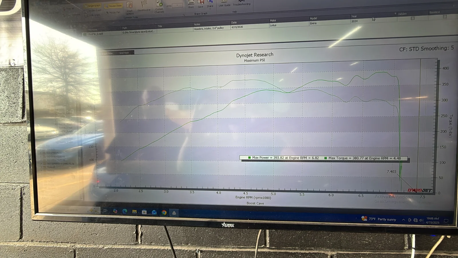

The other test vehicle we have been working with us fully bolted (practically every bolt on and the smallest pulley available).
the *current* dyno results for that vehicle is posted below.
ending with 450+whp and nearly 400ft lbs of torque.
Now, immediately I'm going to expect "why the results are low" or direct comparisons to JB4. Lets sort that out and explain what we discovered (and are fixing through custom code). First, this vehicle did test with a JB4 and could not produce anywhere close to JB4s advertised gains. So we did verify vs a competing tool.

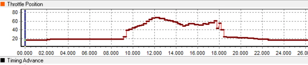

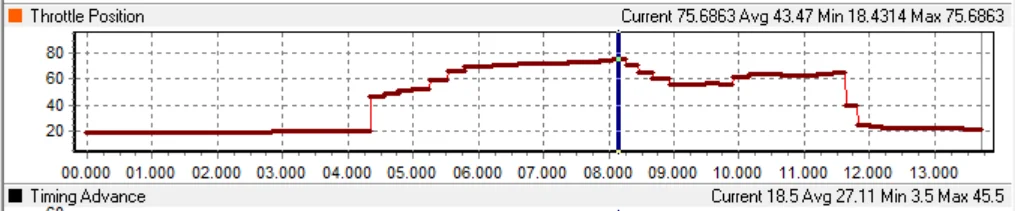

Secondly, A new discovery was found after we retuned and unlocked throttle. The car is now making so much boost it looks to be maxing out the MAP sensor and the ECU is limiting power as a result. This is new territory, as we have never seen this on evoras (they can't get the throttle open as much). This was confirmed by the car posting DTCs for the MAP sensor.
before: you can see throttle limiting overall (pretty standard)
then, with our changes, you can see throttle CUTS back and limits once we hit overboost
How we will fix this:
We are rewriting the entire Throttle control code. not trying to patch around it, or mess with lotuses stock code, we are designing our own complete throttle control code from scratch. This new code will come with some neat protection features

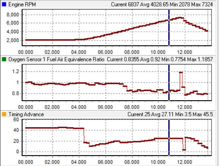

now, as for the tune, our OTS map is clean, AFR is well controlled, ignition is also excellent. (see below)
with AFR between 12.5 ~ 12.2, (this is temperature controlled, so as temps rise it will enrich further)

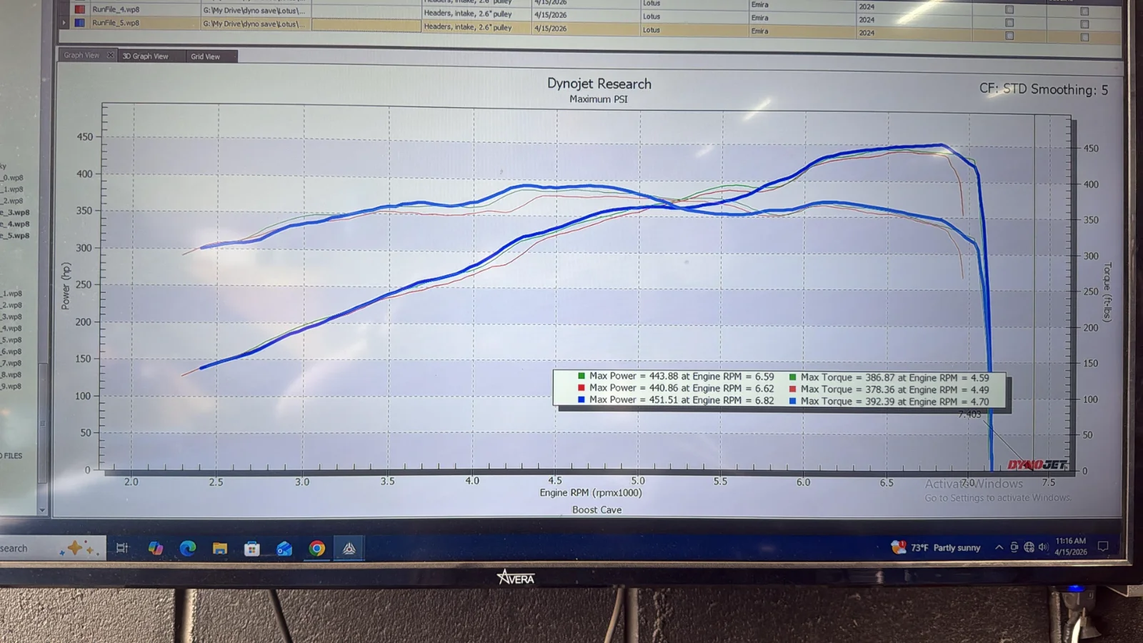

Car before throttle control updates on dyno and further tuning:
vehicle after cleaning the tune up, and hitting boost/throttle limiting due to hitting max on the pressure/map sensor
as a reference, this vehicle is hitting over 400/gsec on the MAF. (equivalent to over 520bhp roughly). that is with throttle cutting down above 5000 rpm. We are easily missing 50-60 more whp up top due to this.
Note, this is NOT an issue on stock vehicles / bolt ons but stock pulley. Only on much smaller pulleys where boost can hit the limit of the sensor.
Important details about this vehicle:
This vehicle was tested with a JB4 on 91 octane, 93 octane, and a custom map from JB4. None of the available maps were able to produce the numbers they advertise. (not even close, but I will let the owner decide if they want to provide that exact info)
So, we have some real data here, and it is excellent data due to the car being fully bolted (which is the inevitable path for most folks looking to maximize power). We are happy to have this info very early in the game so we can refine our product to maximize power out of these modifications.
before: you can see throttle limiting overall (pretty standard)View attachment 80175
with AFR between 12.5 ~ 12.2, (this is temperature controlled, so as temps rise it will enrich further)View attachment 80177

I’m confused so Please educate me.
Are these the dyno results after your tune?
What horsepower and torque numbers did you get with the JB4 on 91 and 93 octane before your tune?
And what were the false claimed horse power and torque numbers you are referring to that they made?
And could they be different as a result of them using a different dyno?
Which type of dyno did you and which type of dyno did they use to compare apples to apples?
Yes these are the results after stock ECU tuning, and running into throttle reduction due to maxxing out the MAP sensor.
The owner of the vehicle can produce the JB4 results if they wish. I am only saying it was tested. The results did not produce what they advertise. I never said anything is false claimed.
