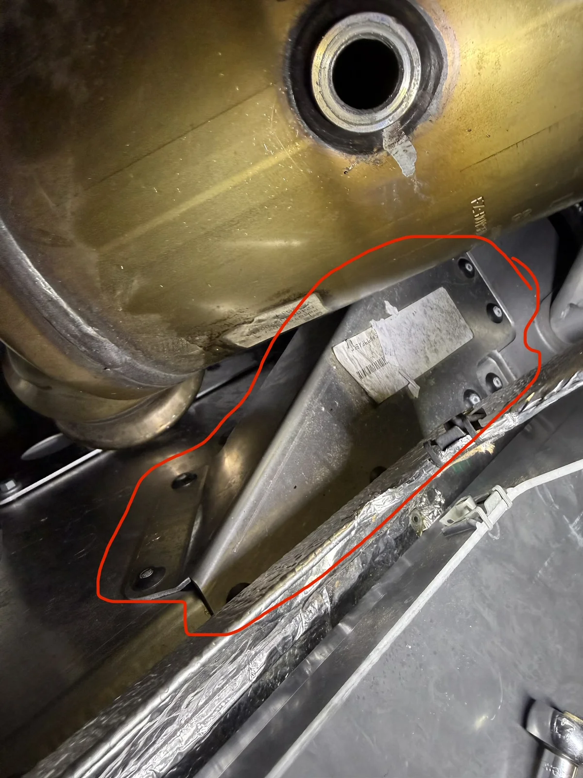

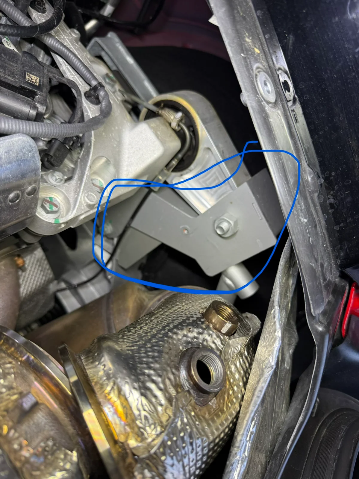

I’ve been struggling trying to get the damn OEM cat out from the top. I read someone removed additional brackets to make room while others had to remove the exhaust manifold (seems like a lot more work). Any tips guys, is the items I circled in blue near the top or red near the bottom the correct brackets to remove? TIA

I haven't personally done it, but several have reported it's the bracket on top circled in Blue. If you have already loosed everything and have been playing the wiggle game with the downpipe, you should be able to tell if that top bracket removal gives you a few extra centimeters of clearance. Just know, it'll still be a knuckle scraper tight removal regardless (again, according to others).

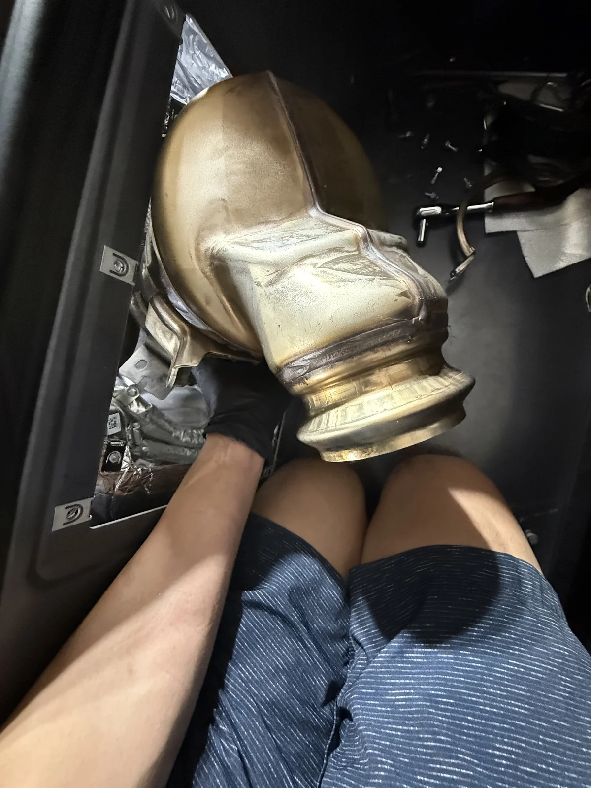

I was able to remove it after I removed this bracket. I had to take off my rear right wheel and wheel liner to get to that brace. Also make sure you remove both the diffuser and the middle rear aluminum tray. After that, I just had to keep moving it in every direction until I found one that worked that let me get it out of the service hatch (that took awhile)
Thanks Guys, that bracket is key. Hardest part is over!!! I did weight the 300cell DP against factory. 14.75lbs vs 11.05lbs
