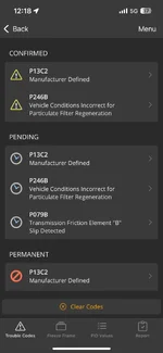

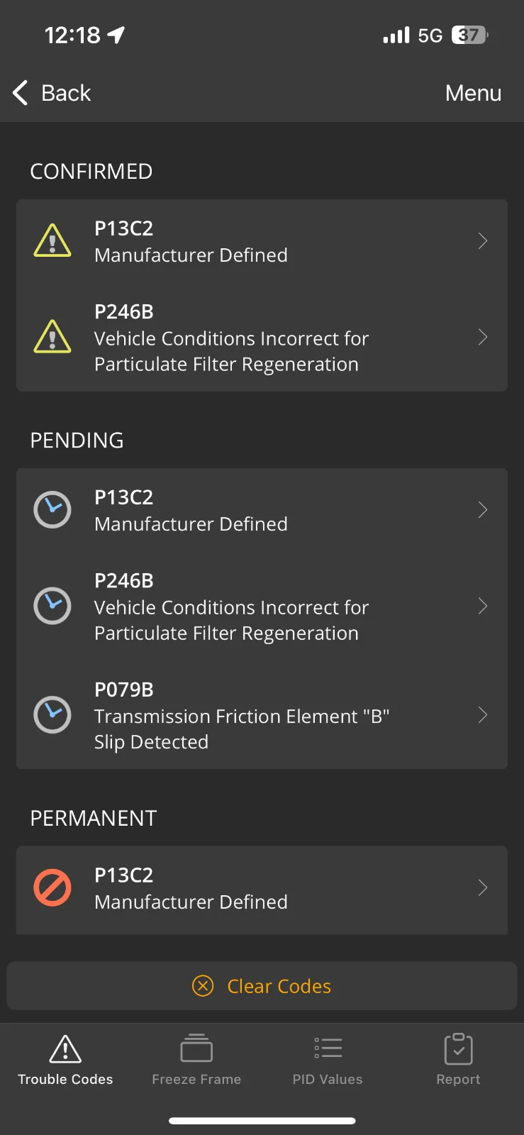

I’ve had a clutch slip error on track. I’ll probably get the boost turned down a little when I get a chance.

btw I was seeing 2.4bar in my car with JB4+meth and got overboost code a few times. Lowered boost a tad didn't see the code again

2.4 is fine for street driving but for track with multiple hot sessions when the tranny oil got hot, 2.3 is a safer bet until someone solves the cpc.
