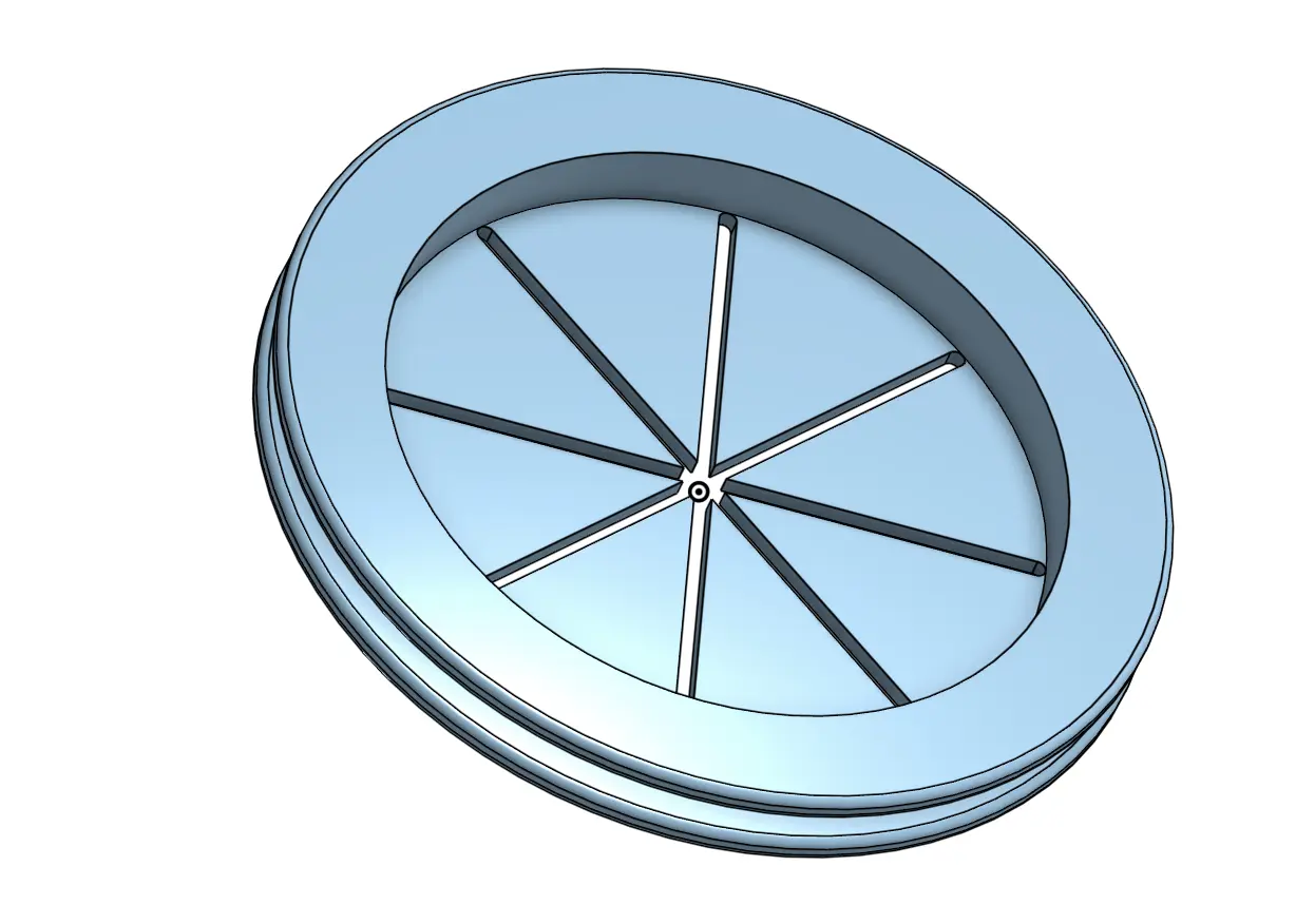

I have to figure out the OBD2 cable, I'll be removing the rubber blank plug on the firewall and printing out a new one out of TPU. I have an idea of what it will look like but I still have to pull it out and take measurements. It's a problem because I think my carbon buckets might have to be removed on the driver side to get at it.
What about just slicing the stock one with a razor?

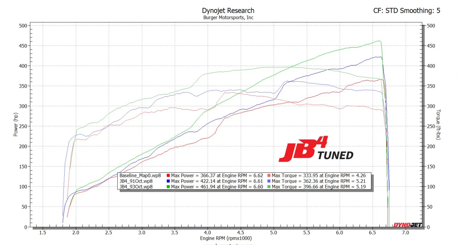

@kitkat Correct me if I'm mistaken, the tuner doesn't seem to offer any benefit in power or torque until you cross roughly 5300 RPM on the V6?
I’m not sure how you’re interpreting this — but even at 2,500 rpm there’s a 25 ft lbs difference in torque.
Well your affirmation is partially true in regard to the map1 on 91 octane gas.
The torque is a bit better at lower RPM like kitkat said but the major gain is between 5K and 6.8K. So the map1 is going to feel similar for cruising around but at wide open throttle the difference should be noticeable. My guess is that if you run the map1 with 93-95 octane it should be even better.
Now in regard to the map2, the gain are noticeable at every RPM but especially from 3 800RPM and higher.
If we could get a 7200rpm limit we could stay into the best powerband for longer period of time and it would be very beneficial.
