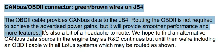

It’s a bit confusing as the product info says you don’t have to route the OBD for advertised power gains. I’m writing back to them.

Why can't the manufacturer just be specific. Even their guide says you don't need the OBD connection to achieve stated gains.

I agree and their guide states that the OBD2 isn't required beyond data logging and tuning of maps. I've sent an email asking for exact clarity as this is far too ambiguous for my liking. GRP also stated it's only for logging.

I accept your comments but that’s not what the two sentences state
