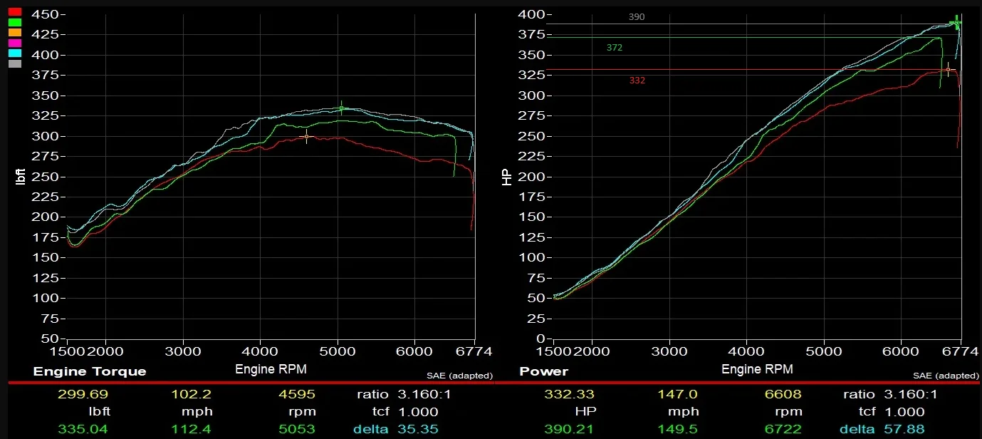

Yes. This was with Map 1 and actual 91 octane gas. It looks like some or most of the people posting dynos of Map 1 still have 93 in the tank, which would allow Map 1 to operate right to its limit due to the extra headroom against knocking the 93 would have. I don't have 93 available so I can't do a Map 1 - Map 2 comparison.
The JB4 dyno I got showed what I felt when switching to Map 1; a definite increase in torque at the lower rpms. What it also shows, is that through multiple dyno pulls spread out over a year with several different mods, once the rpms get close to 5k all the lines pretty much join together. That tells me the exhaust is the bottleneck. I believe all the people showing bigger gains have deleted their 3rd cat which would reduce back pressure and allow for more performance. Most people also seem to be using Dynojets while I'm on a hub dyno which are known to be more conservative.
In order to give you some reference data, the dyno showing meow’s +57whp gain was on pump ACN91 with a bottle of Boostane shot — the tiny little bottle. He only has a valve controller no other modifications. Ambient was around 85F and it was on a hub dyno as well. The numbers were similar without and with the boostane shot.
