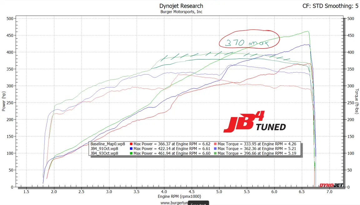

Up to 95whp increase on the V6 powered cars!
Up to 69whp increase on the I4 Powered cars!
Does anyone know if these numbers are with bolt ons (headers/3rd cat delete) or bone stock car?
The V6 car they dynoed it on had a GRP 3rd cat delete and a GRP blue air filter and I think that's it.
I don't know anything about the I4 car.
So its possible of getting over 100hp with Full bolt ons (headers/exahust)

IDK what else to say other than its a lot faster.
I THINK, not speaking for him, but I would also like to know..
Does it change the driveability of the car? Is it all over the place? Is the power "too much" (it's never too much, but is it manageable)? Is there considerably more pull one way or another? Is it linear? Is it "jerky" or smooth? Do you find that you have a hard time managing the power output now vs stock performance?
