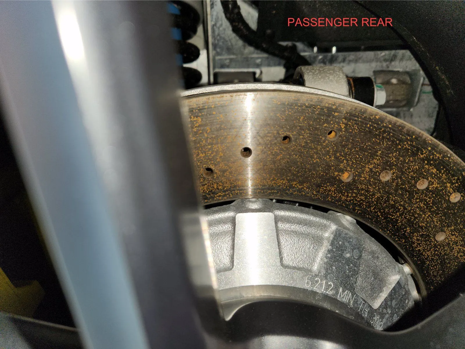

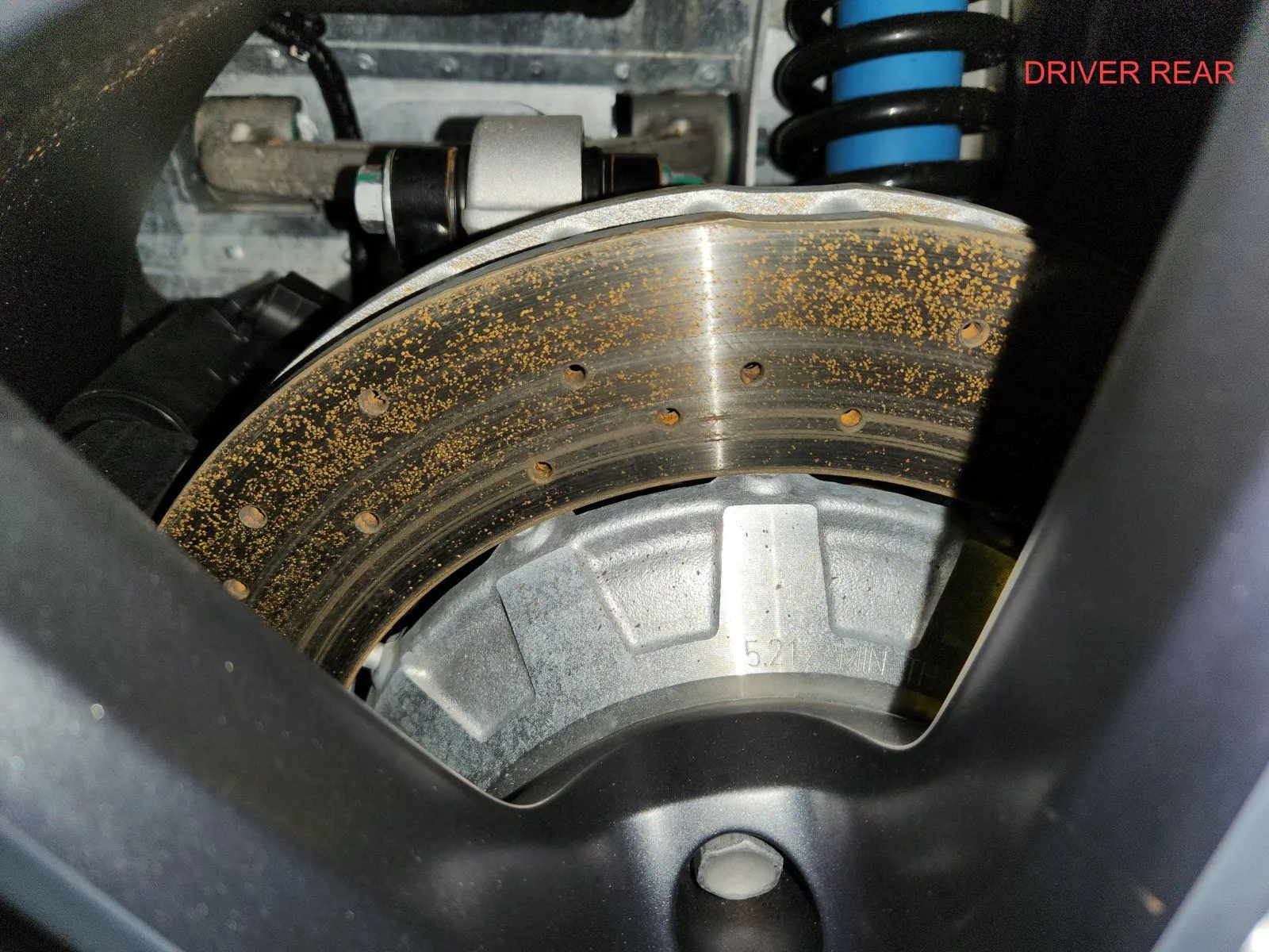

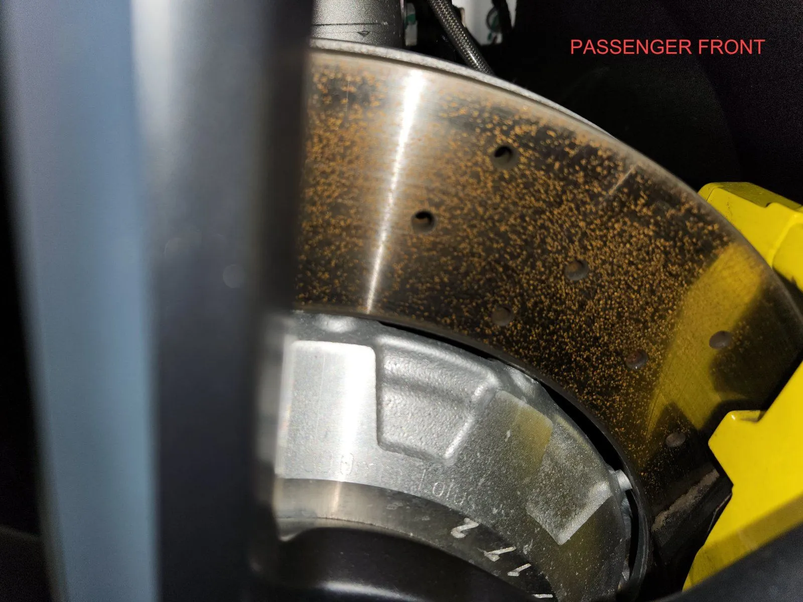

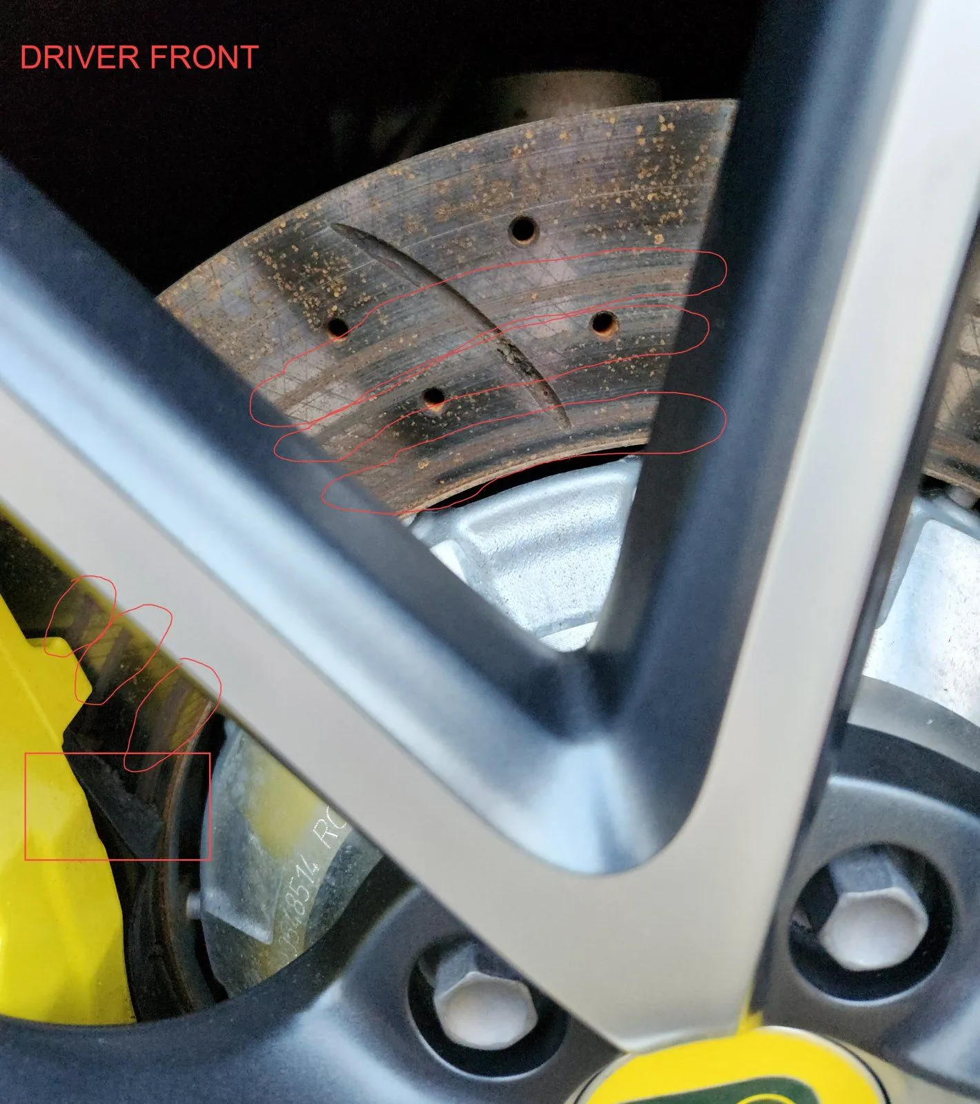

The rear looks like it may work itself out. The front definitely looks like there are three distinct grooves where the pad is not touching the rotor. You can kind of make out that there is a chunk of pad missing on one of the grooves:
I'd be curious what the other side looks like because they looked nice and shiny in the photos.
Closeup photos of all four wheels - as you can see passenger side both look fine, it is just the drivers side which look dubious, just not sure if this is something that will sort itself out once driven more / bedded in, or if needs rectifying? car has only done about 5 miles as is awaiting PPF / ceramic before being driven further.

That's suspect. It's not as bad as some of the other cars we've seen, but I would get this checked out once you have the PPF done.

We have now seen multiple new cars with the brake pad issue. I am a bit flummoxed that Lotus has somehow managed to remain unaware of this issue, or worse, is releasing cars with this issue on what is a rather important safety feature.

Seems like possibly it's cars that were stored outside while awaiting production parts. It might not happen at all for cars that went straight through production to delivery.
