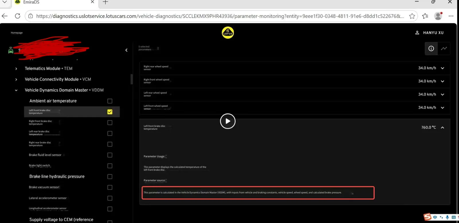

Correction to what I said earlier, the brake temperatures are estimated, not measured values (Lotus diagnostics can display that estimated number). So if you upgraded the brakes and cooling, the estimation wouldn’t change but the actual brake temperatures would be lower. My brakes still seem fine when the warning occurs.

So here is a screenshot of the lotus diagnostics, including the estimated brake temperature (translated from Chinese to English)
Very interesting. So in theory, the systems should still function correctly, but based on perceived temperatures, it's warning that they won't be as effective, and thus, full potential has been theoretically "disabled?"
I don’t know how it actually works, but yeah, their estimate is based on the performance of the standard discs/pads and whatever cooling comes as standard. So yeah, if you upgraded discs/pads, cooling or even callipers, then the’d run cooler, the limits of the brakes would increase and the’d have the ability to run at higher temps, but the car still thinks it’s running the OEM setup and give the same warnings.
I’d be surprised if the car would actually turn off traction control when it determines the brakes are too hot. More likely the car functions as normal but the algorithm will expect the ability of the rear brakes to limit slip is reduced, so you get a warning that TC is unavailable. The V6 has a proper LSD, so the algorithm will be different so I doubt you would get that traction control warning. Good thing you can just select track and the warning goes away (it might come in at a higher estimated temperature).
Interesting that there's a calculated brake pressure, I want that for datalogging.

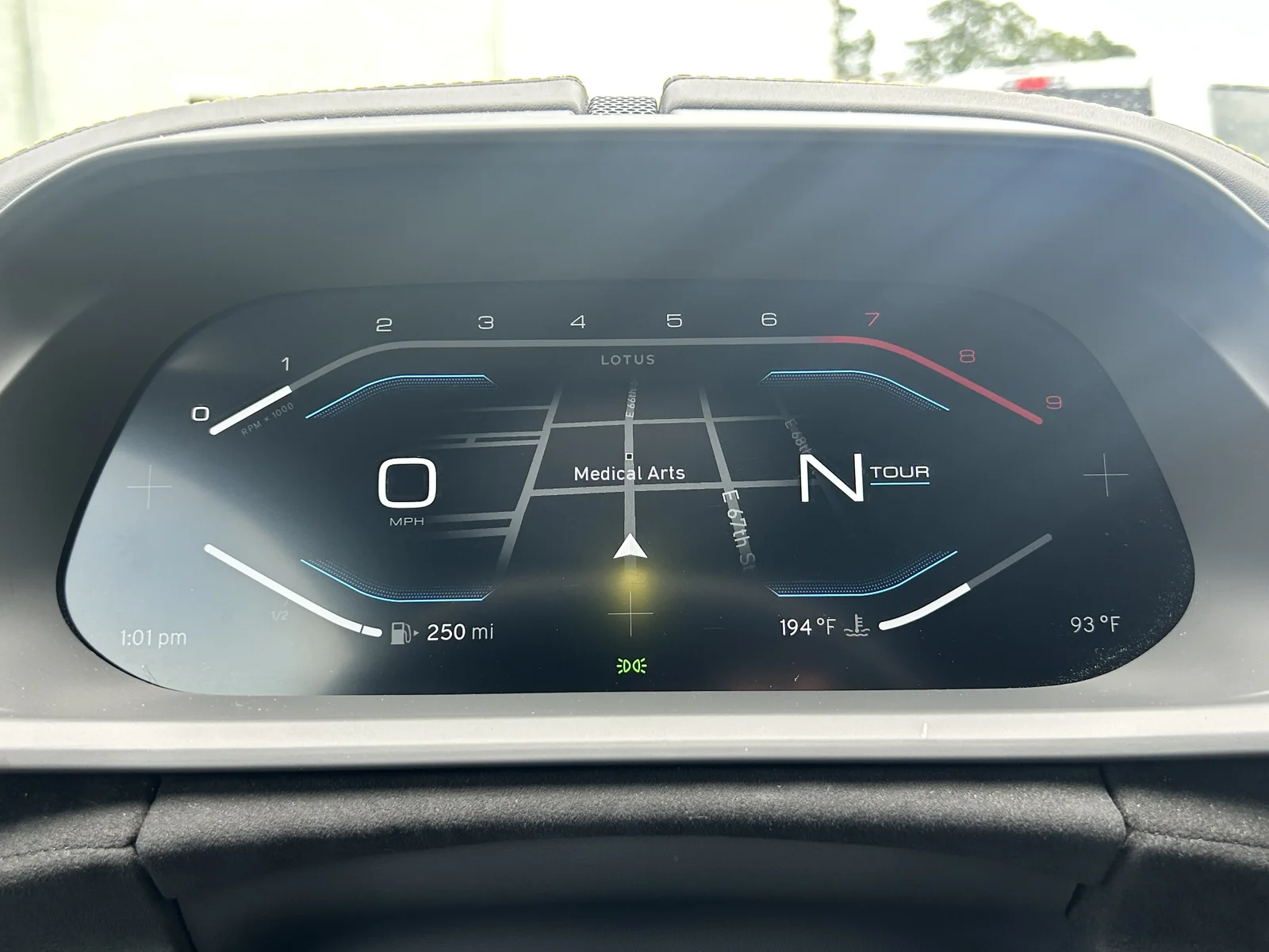

I was pumped. It took me a while to realize the lights were even off! I was driving around trying to uncover a noise I had been hearing when I eventually noticed less warning lights lol.
