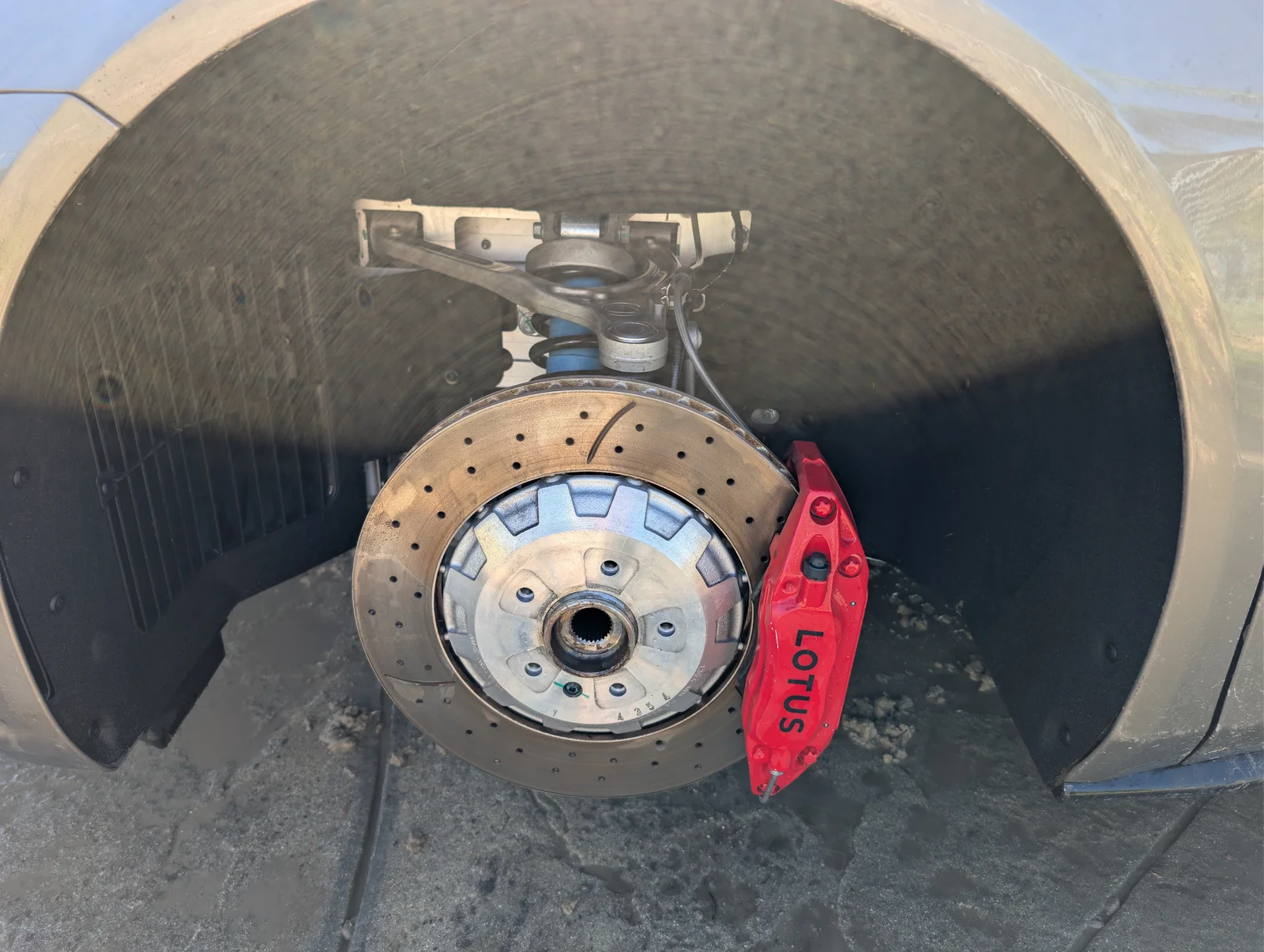

Obviously late to the party but the rotors can be pretty sus. I haven't actually had any noticeable issues from mine but if you look this picture of one of my front rotors near the caliper youll see where theres some extra grinding that happened on it. I think someone dropped the rotor at some point and they had to grind that bit off to correct it. Also of note the paint for the calipers is really thin and fragile. View attachment 78848

Girodisk will fit like stock but you won’t have the warble issues since these are fully floating. The oe are semi floating and can expand unevenly which causes the warble when hot. Girodisk or paragon if they have fronts. Can’t go wrong.

I think the OEM discs are a major part of the issues, once they have been cooked, they seem to have issues that can't be resolved. I had my factory front discs skimmed as they had what seemed like pad residue, ran them with Endless Pads. Was never able to get good braking, without some sort of vibration once the brakes got hot.
I'm now running aftermarket discs front and rear, with matching pads and do not have any vibration issues like i previously had, and it brakes better.
