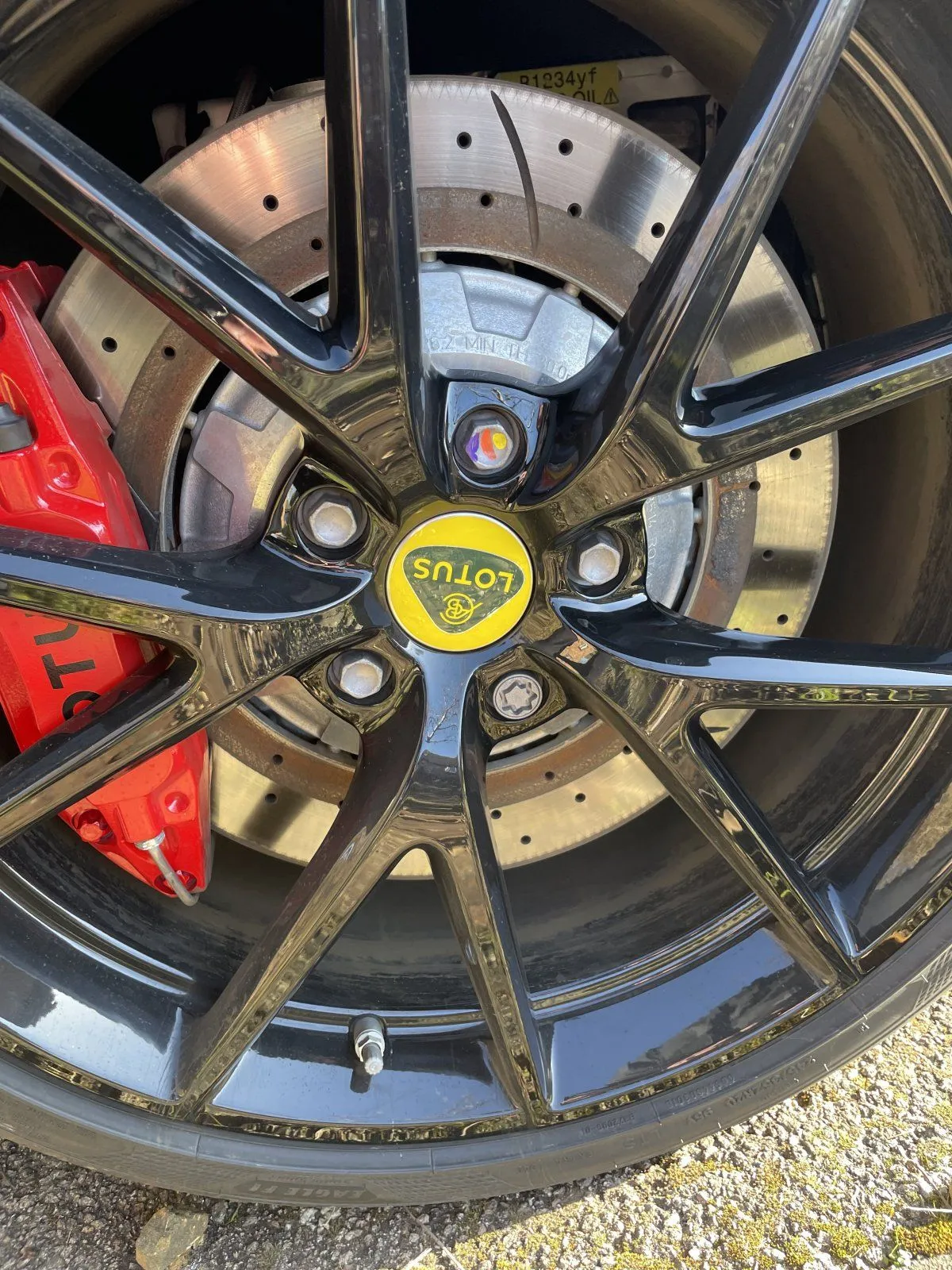

Front Brake disks were corroded (a shock to me and the lotus engineers at the dealership) and the pads had fractured in places. Very alarming as I hadn’t noticed and wouldn’t have if it wasn’t in for the above issues. This is what took over 2 weeks to resolve. After week 1, central said they’d take some from the production line and send them to the dealer. The dealer got a call the day after to say they’d changed their mind and now had no idea when they’d send them. Another week later, they had arrived and promptly fitted. 15 days without the car though due to a lack of consumable parts that central were not prepared to take from stock.
Needless to say I’m not overly happy but I’ll leave the emotion out of it with the above simply to let interested folk know how it panned out in case similar technical issues occur for others.
FYI cars sent over ocean (by any manufacturer) have cosmoline or a similar rust inhibitor sprayed on their exposed steel and iron parts for exactly this reason. On unprotected brand new metal without significant heat cycling, exposure to weather while sitting is a recipe for potentially significant corrosion.
It may be that they haven't been doing this on cars bound for UK customers since it's a domestic delivery without an ocean voyage... if so, I think it's a mistake. Cars end up stored in weird places for long periods for all sorts of odd reasons. Without appropriate protection, most steel parts will quickly rust.
Just washing some vehicles or leaving them outside during heavy fog can cause rust to appear. It is no reason to replace the rotors. Why would the Emira rotors be any different?
Yeah, after washing, drive your car for X number of yards and break. it will remove that light rust-like film and you will be okay. The danger is that rust build up sticks harder and may damage the brakes the first time you use them.
When rotors are new and not yet heat cycled by use or deliberate bedding-in, corrosion is a far greater concern. It can cause pitting or damage to the surface, particularly if it's a "clean" uncoated/unprotected mild steel surface and is exposed to the elements for long periods. This is also true for brake pads, if they have any sintered metallic content.
Once a braking system has been repeatedly heat cycled, the steel becomes far more resistant to moisture corrosion and typically results in surface rust only. This also applies to brake pad materials.
You'll notice if you buy new rotors for almost any vehicle, they come coated in a sticky substance that should be washed off prior to first use. This is a protective coating that's been applied and should be washed off with soap or degreaser just prior to installation. In the case of a major manufacturer like Lotus, it's possible that they are receiving brake parts directly from the production process and bypassing any destined-for-retail coating and packaging process. Parts manufacturers generally assume that vehicle manufacturers will spray-coat with a corrosion inhibitor on the suspension and brake parts after assembly, prior to any vehicle storage or transport.
Thanks for the info. For about a year and a half, I designed stainless steel auto and motorcycle rotors that were coated with chromium. They had no problem with rust.
Now I think if I were to buy replacement cast iron rotors, I'd look further into coated versions. This video describes the main benefits of such rotors. I am also partial to slotted rotors such as the AP Racing J-hook style.

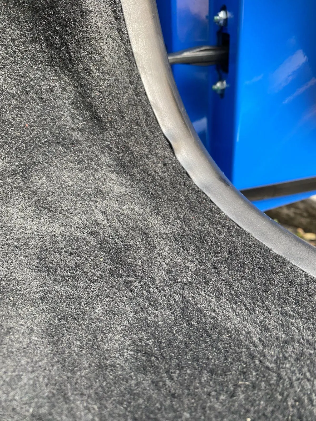

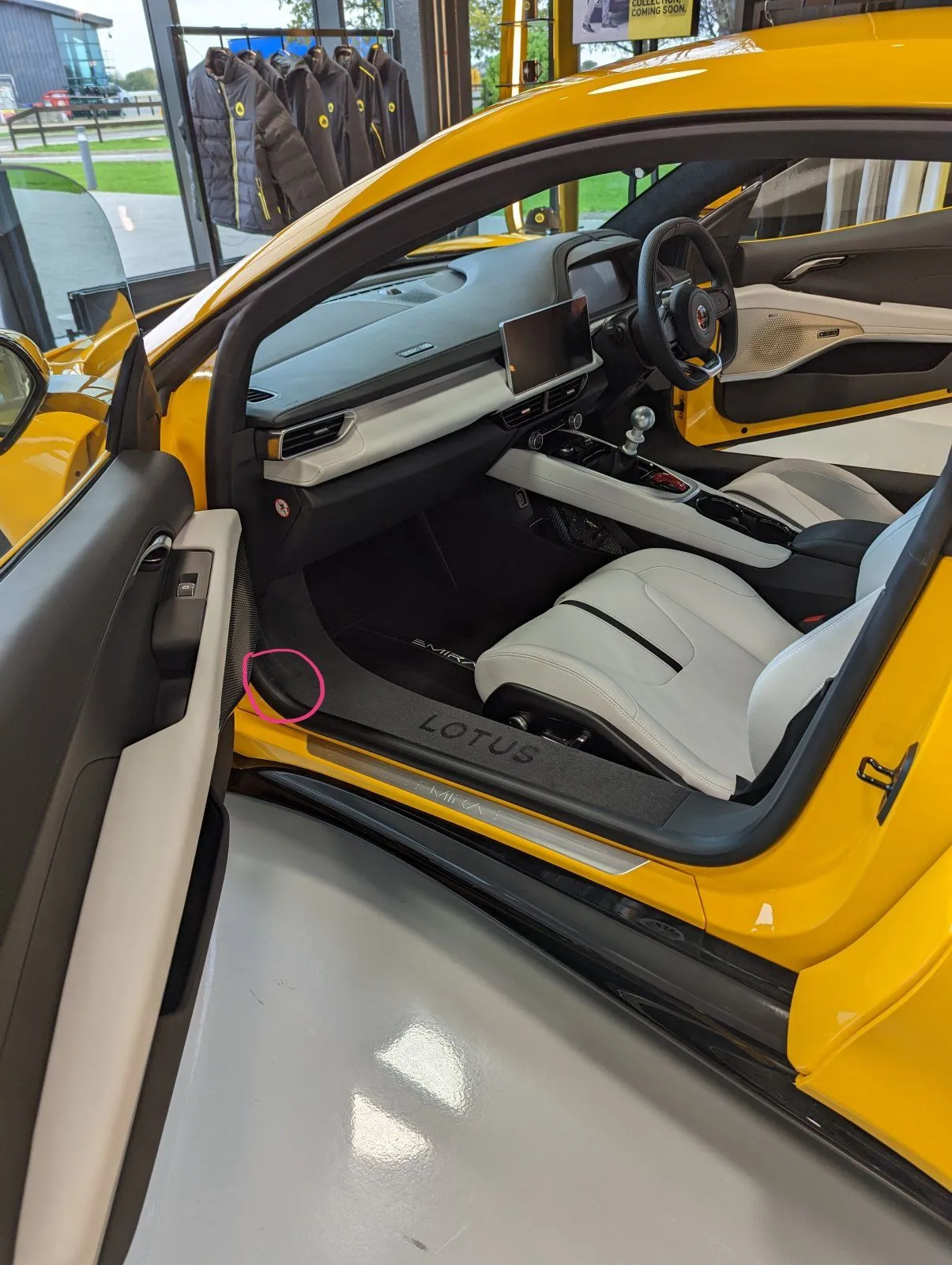

On the Demo car that arrived this week in Bilbao I spotted on both sills what I consider a bad fitting of the rubber strip on top of the carpet. I forgot to take pictures, you can barely spot it on the video I took of the inside, I also saw on the video of the Japanese car, and on one of the yellow demos in UK, and I thought may these cars where not final custom version, but I just saw it also on the customer car just delivered in Hethel.
Confirmation from members in here with customer cars delivered would be appreciated, and if Lotus is aware and solutions to this issue for both existing and new deliveries
Picture of !st Hethel collection: @shaank could confirm if he sees this as an issue
Absolutely right its a problem. Its a double "dog ear" flap that should not be there on a quality car. Original problem was on Rover cars which even they managed to sort by slitting & glueing. Every car has this issue. Factory aware but nothing done about it.

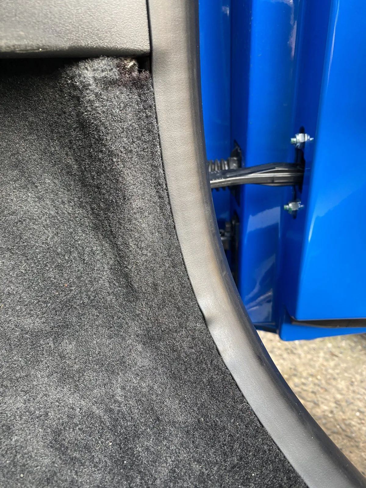

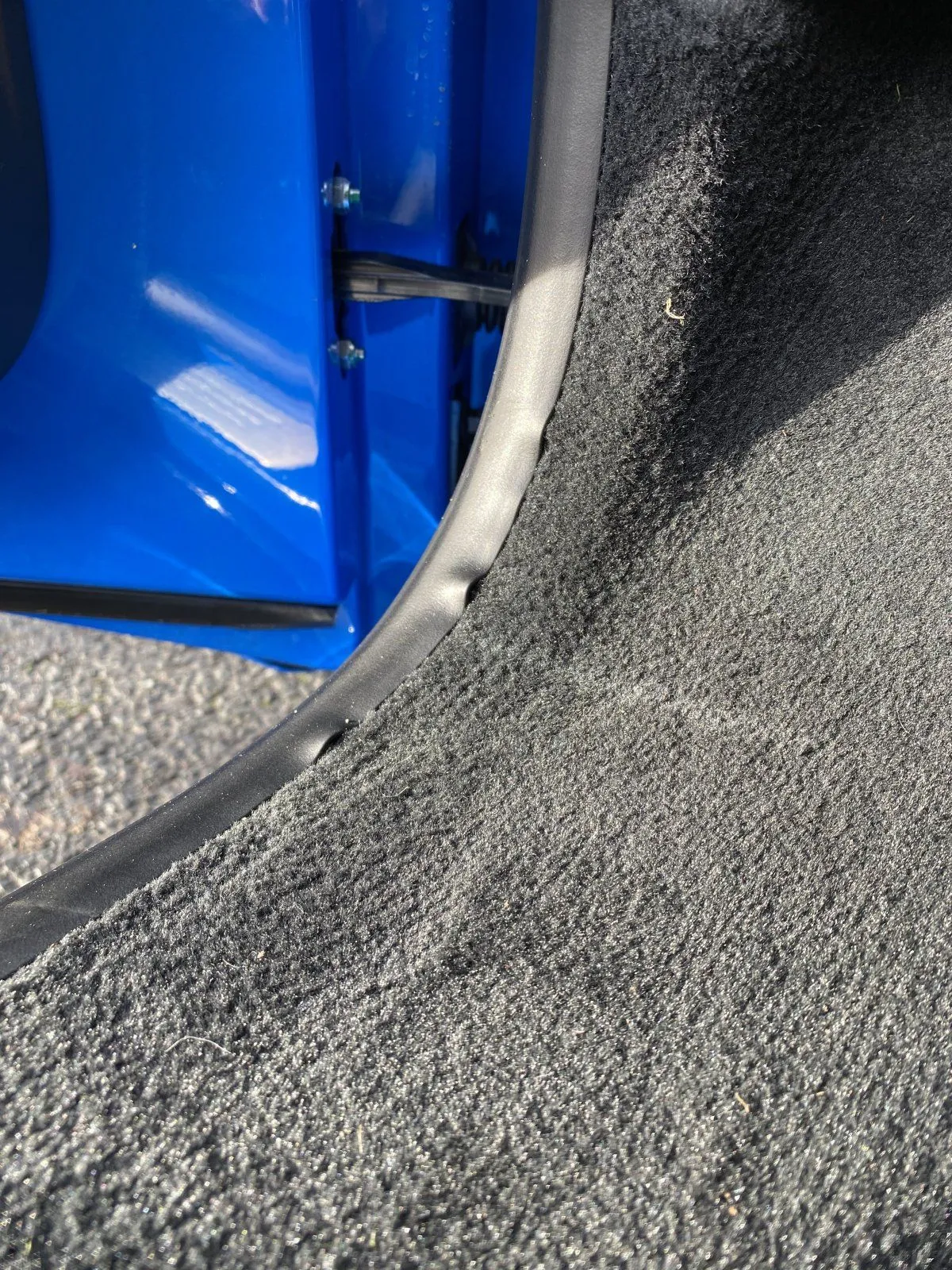

This is on my car too. Only minor on the drivers side (with a rough bit of carpet finish in the corner which also isn’t ideal) but a bit more pronounced on the passenger side.
I suspect it’s a DIY fix but to be honest, I’ll likely just leave it as is.
You’re not alone. Mine too

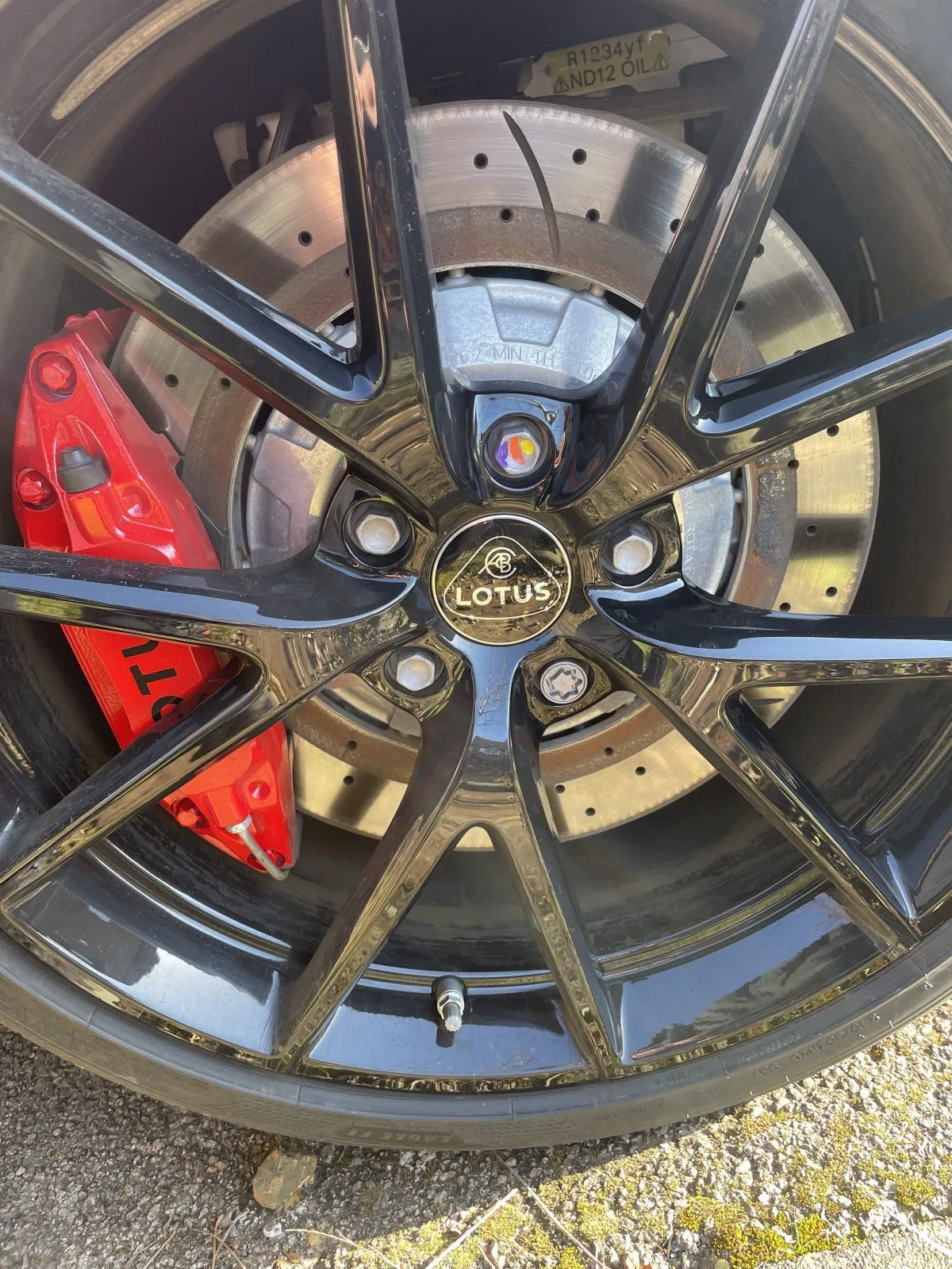

I'm waiting for the Black/Silver nose badge, already got the wheel hubs. Looks nice on the Nimbus. (still waiting for Black Wheel Bolts)
