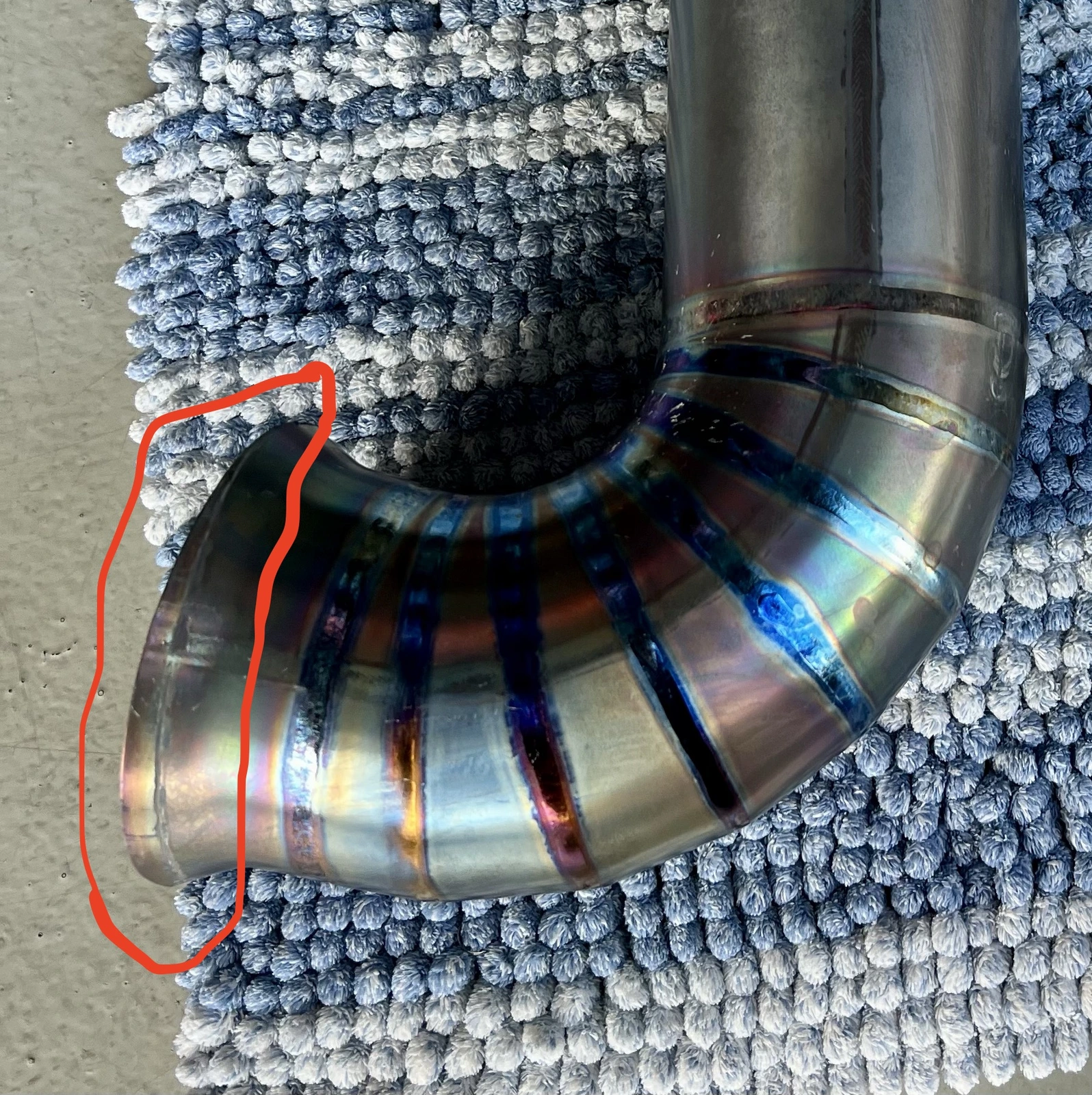

To be clear, this was "TOTAL USER ERROR" at install. In the photo below (see red outline of the original clamp mark at an angle and not cleanly going evenly all the way around), you'll see that because we struggled to even get to it from under the car with the diffuser off, we clearly didn't fully seat the mid-pipe onto the downpipe, before torquing down the clamp.

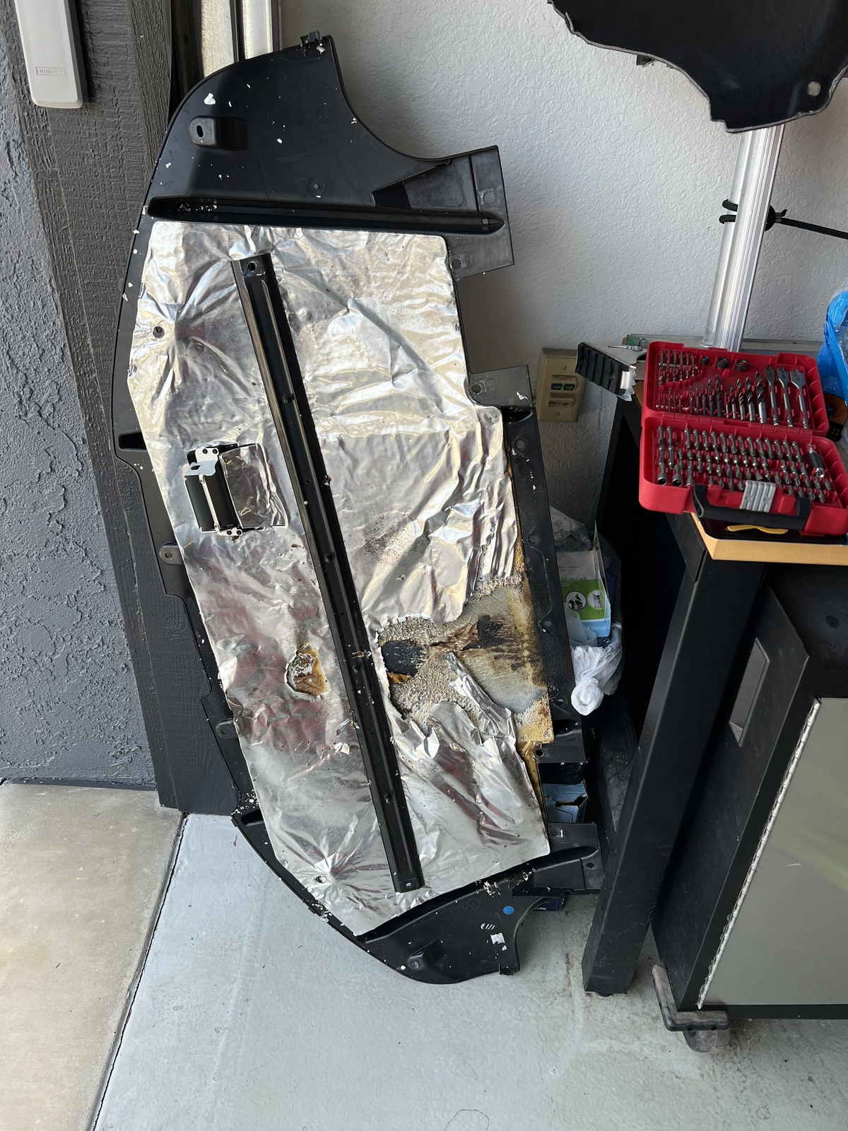

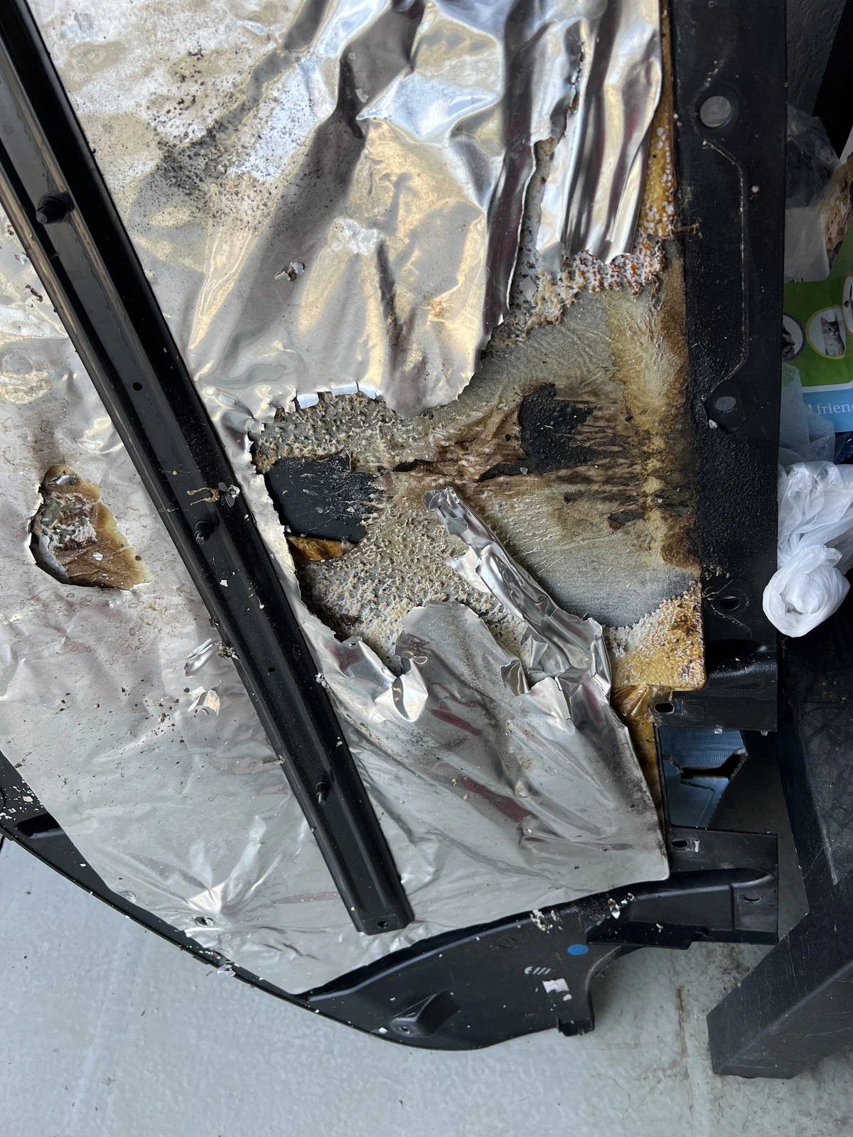

End result of the blow-out was this:

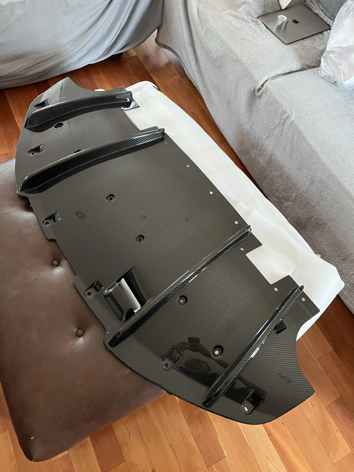

For anyone wondering of course Lotus has no diffusers in NA (They said it would be over a month's wait). So, @GRP to the rescue with a raw carbon diffuser (thanks again Greg for the super prompt service and shipping!):

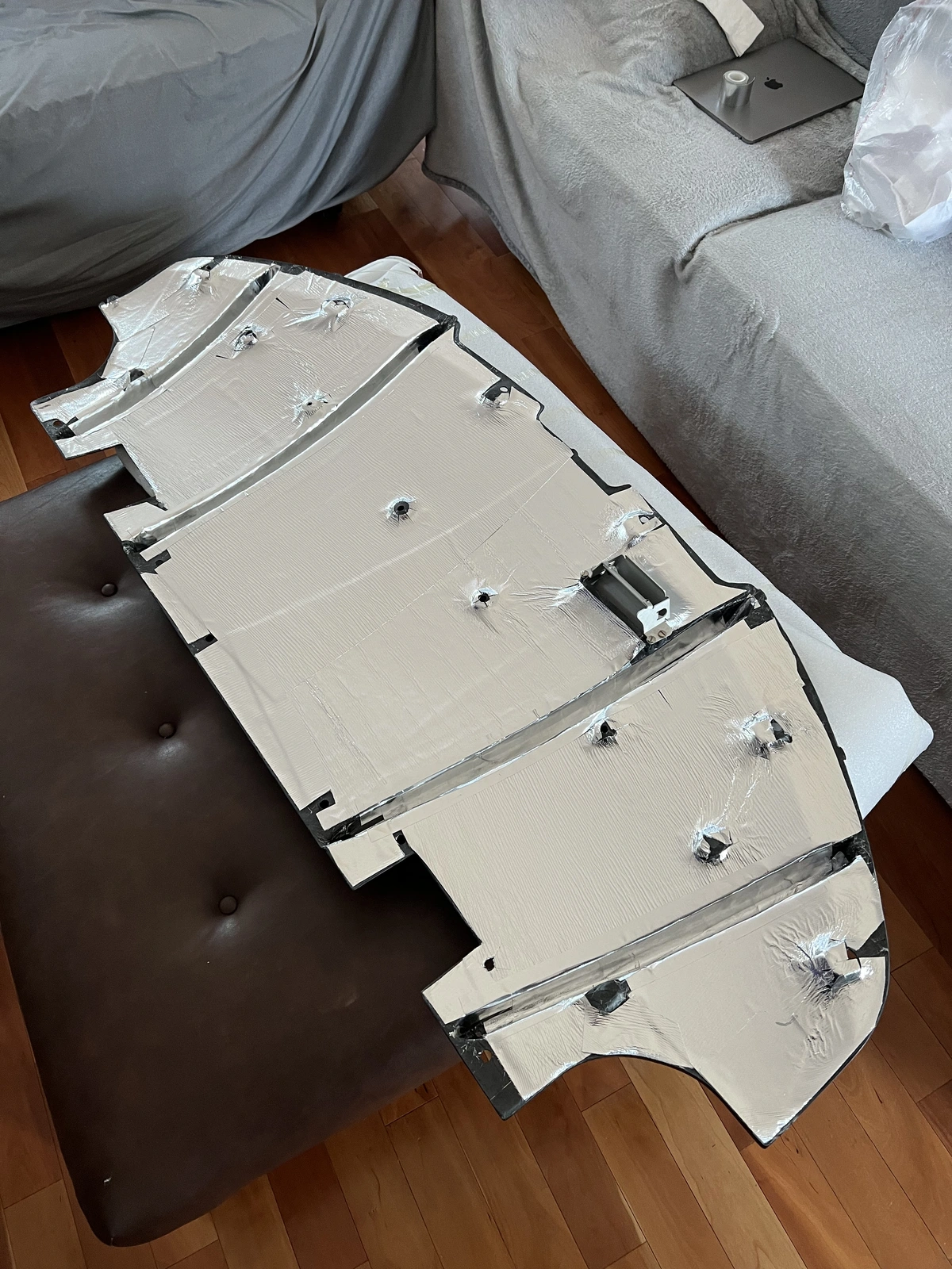

It really is a raw carbon piece. So, I spent another few bucks (and hours in labor) on high-temp radiant heat matting and metallic tape to heat protect this beautiful piece and transfer over the support bar and aluminum cooling vent for the valve controller:
In the end, this could have been a thousand times worse. So, I'm considering myself a bit lucky on this one (just more labor, clean-up and a diffuser). I'll close with the following tip again only for i4 owners given the v6 install is a cake walk compared to the turbo.
For the i4, I would recommend you also remove the lower engine bay cover in addition to the diffuser. This gives you much cleaner access to the "dreaded V clamp." Also, on the new mid-pipe, make sure you place dash marks about 8-10mm from the edge of the lip all the way around with a sharpie. This will serve as a visual point of reference when you are under the car and slipping the V clamp over the mounting lip to ensure it's evenly clamping all the way around and not tilted (I did this the second time when I re-mounted it to ensure this SHIT doesn't happen again!).
Lastly, if you look at the pic with the red outline, you'll see the thin edge that blew, was in fact covered by maybe 1mm of the v clamp. The fact that this held for roughly 600 miles before blowing off was crazy in itself. Like everyone else, we test drove the car right after the original install and that's why we didn't catch this as all seemed fine (except for the needed calibration). In any case, my choke, will hopefully prevent anyone else from making a similar mistake.

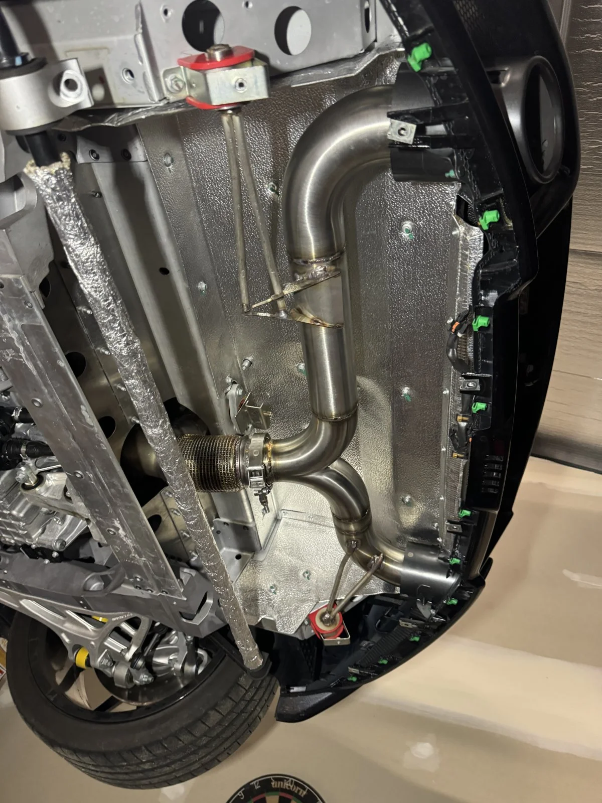

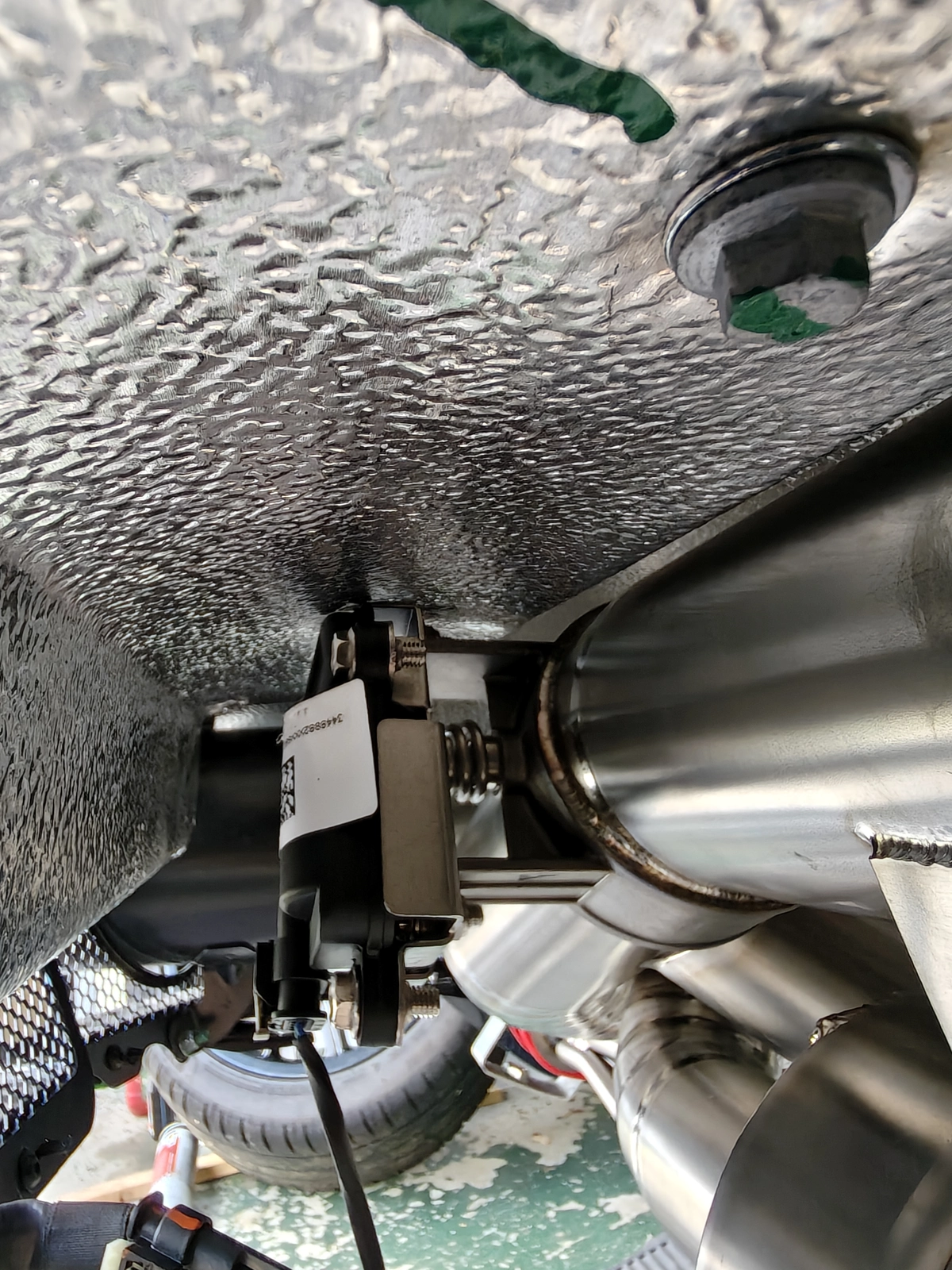

In the process of having a custom exhaust guy local to me fabricate me a 3” SS y-pipe from DP flange to tips with no mufflers or resonators.
We will just leave the valve mechanism connected and mounted up in the rear bumper somewhere to satisfy the ECU/CANBUS signal.

This is what i sent to my exhaust guy for reference. I dont know what his exact plans are but it will be along the lines of this.
The Milltek valve controller connects to the stock valve mechanism. You can switch valve open or close with remote control. Our plans is to just keep Milltek connected and mount the valve unit up in the bumper somewhere. The car should still think that the valve controller unit is still connected to the exhaust so shouldnt have errors.

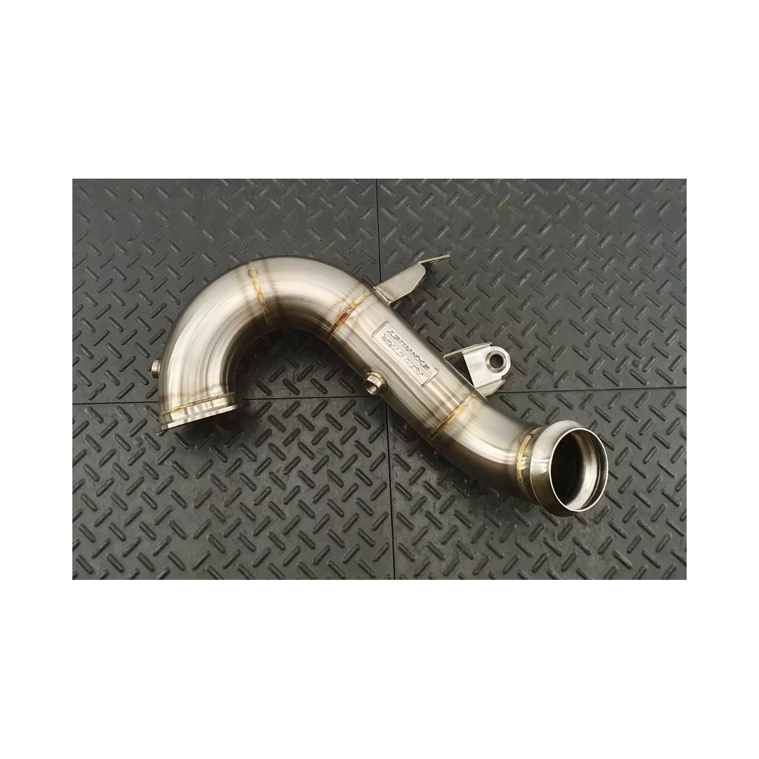

Redstar Exhaust had a link to an i4 Emira specific pipe, but had been recently been removed due to lack of interest. You can still order it through the Mercedes m139 link with a note saying it is for an Emira.
I have ordered the catless version with the heat shielding. Once it arrives I plan to put together some pictures of the pipe and the install process.
