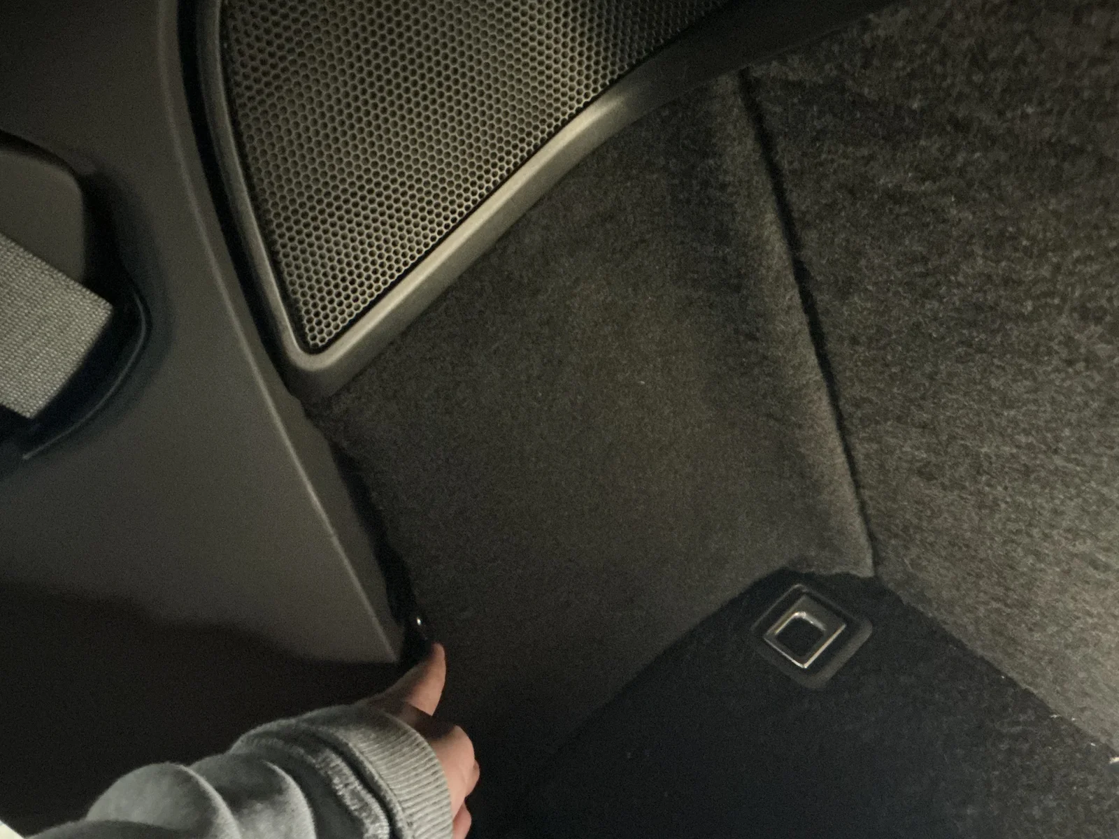

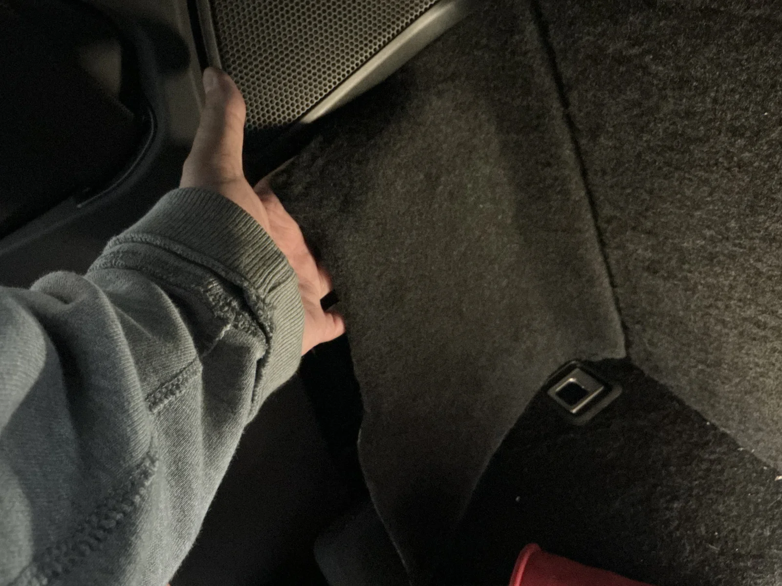

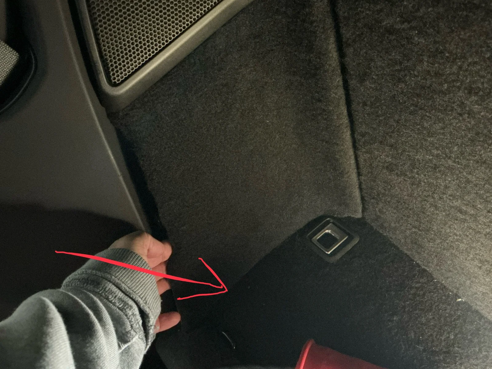

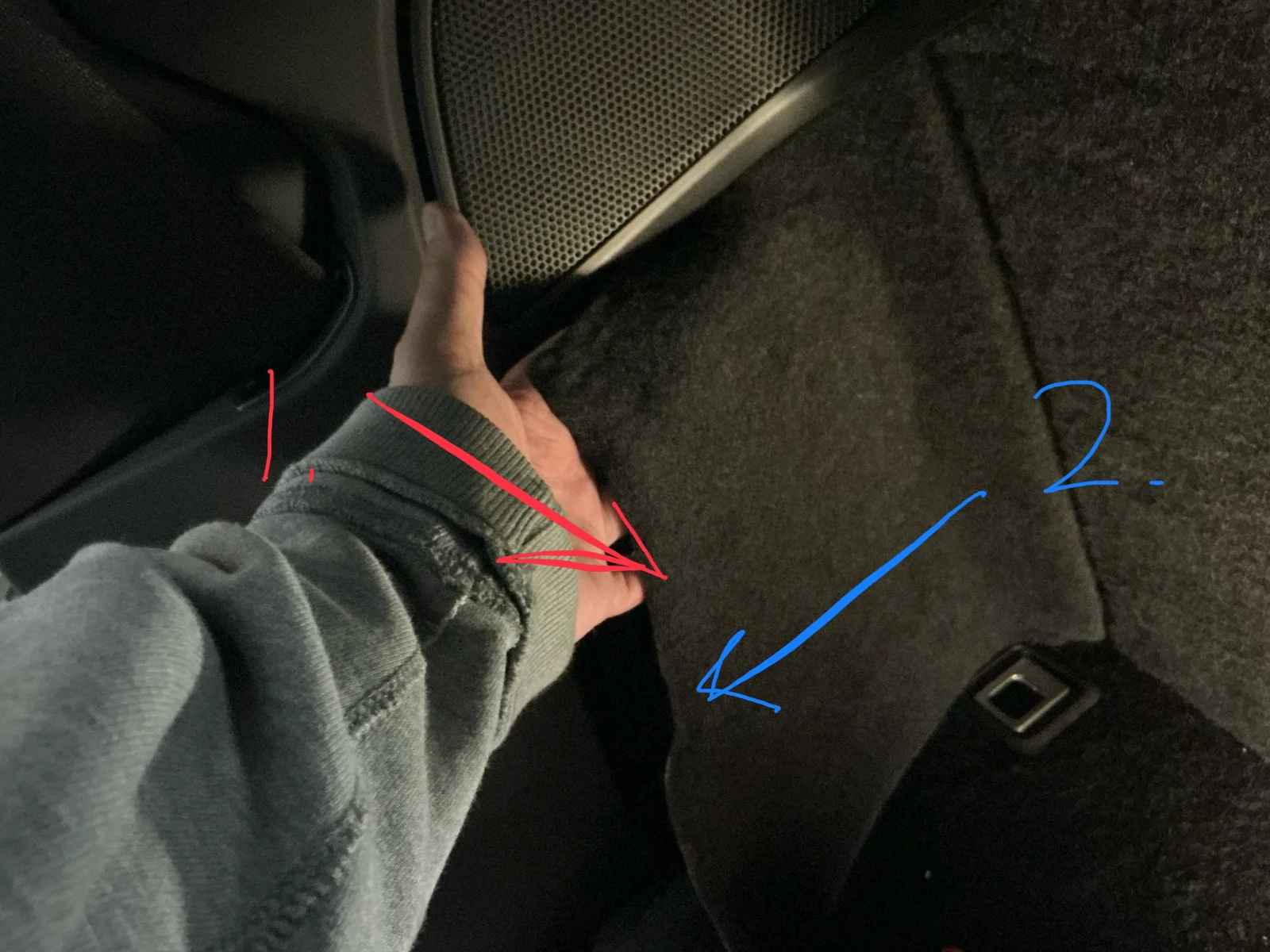

Okay, this is how i remove it. Take it for what its worth.
If looking at panel head on, there is a black bracket on the bottom left of the panel. I stick my finger in there and pull panel out. You will disengage the bottom yellow clip.
I shimmy my fingers upwards towards the top and pull. You will disengage the second yellow clip. Note: why its difficult to remove and reinstall is the top edge of that panel sits well under the plastic trim of the speaker grille. Just pull upper left corner of panel out from under the speaker grille.
Then continue to pull panel out and then forward to completely remove. There are guide tabs on the right side of the panel (firewall side) but no retention clips.

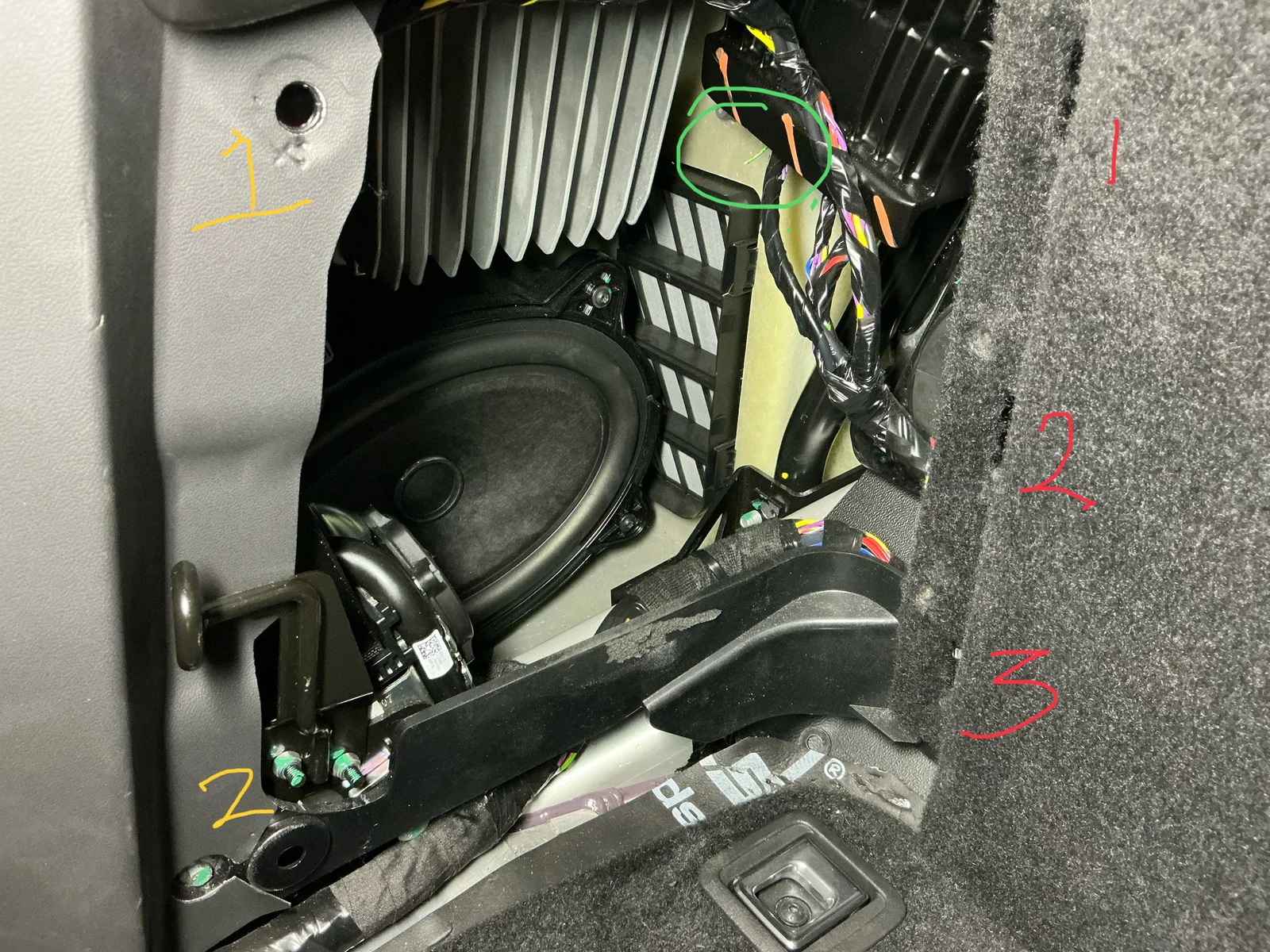

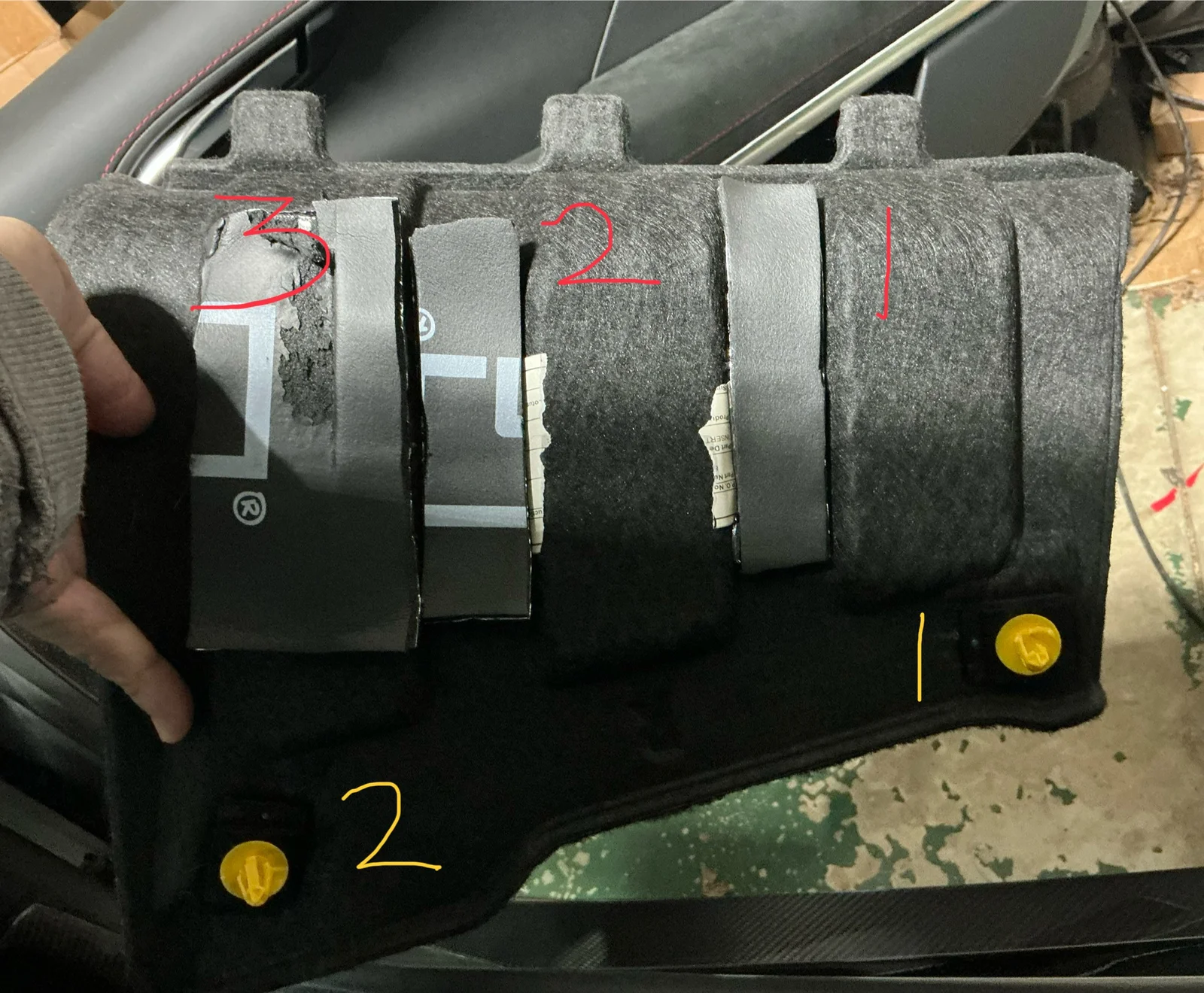

In this next pictures, you can see the 2 yellow clips and the 3 guide tabs and their corresponding insertion locations. (Dont mind the sound deadening material on the panel)
you can see the wire that need clipping circled in green….lol. I didnt tape it off (probably because i was pissed at how hard it was to remove the panel!)
To reinstall the panel is also a major PITA your first few times…i can fly it in there pretty easily now. The best way I do it is lead with the right upper corner under the speaker grille trim first, push panel back towards firewall, bend left upper corner of panel under the speaker grille trim and then push bottom of panel back into original position. Only after i get panel seated back into original position do i then reinsert the yellow clips and guide tabs back into their appropriate slots.

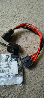

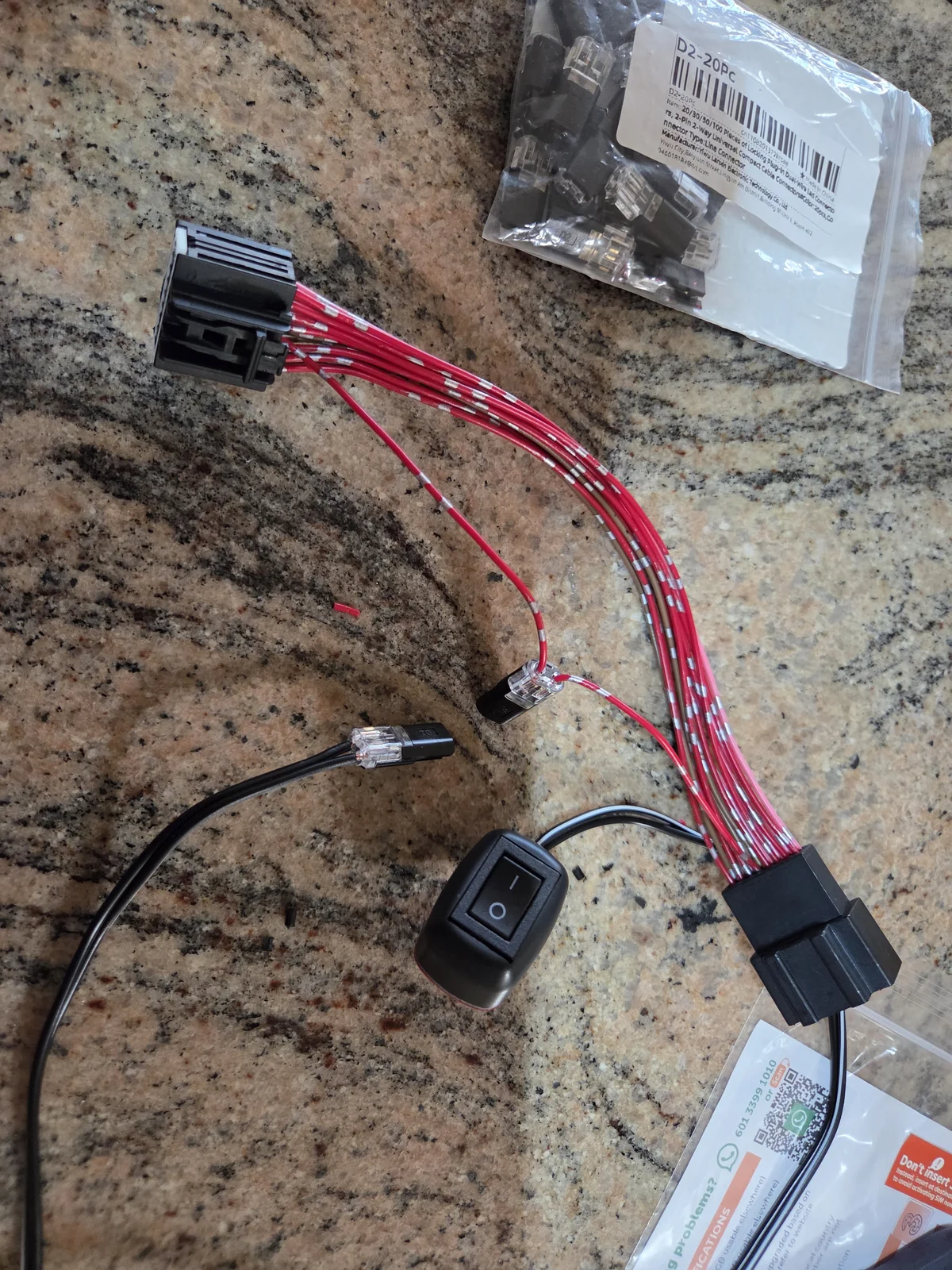

Joining the switch option with an inline harness. Finally got the parts

I put a male connector on one end, and a female on the other end in case I want to plug it back in, but your harness is cleaner and allows for a full factory reset. What is your impression of the lack of fake noise?
I haven't installed it yet. Car is still having paint protection film (PPF). Installed. Many in this thread say it sounds way better without the fake nose. Quieter cabin.
