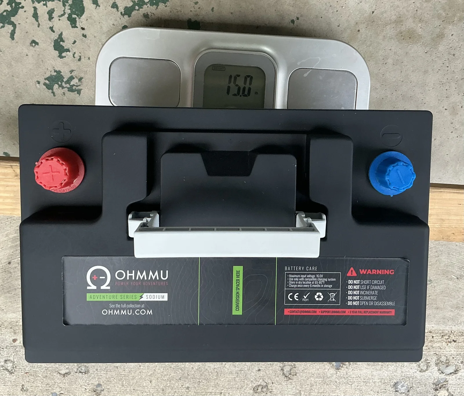

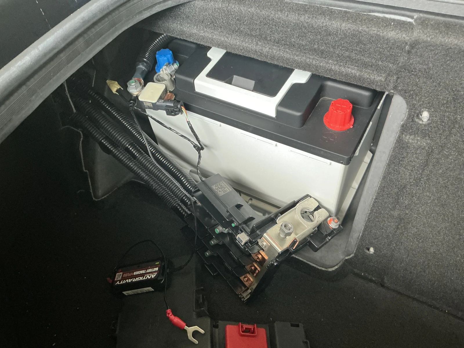

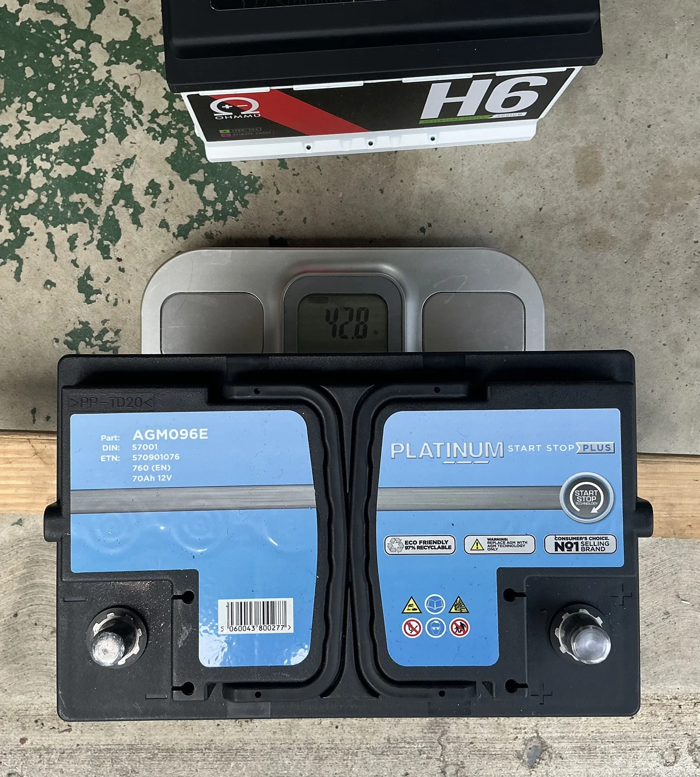

20 min easy swap.
42.8 - 15 =27.8 lb weight loss.

couple days of report on the OHMMU Sodium battery:
nothing really to report, last night saw resting voltage of 12.7, alternator is charging the battery while driving normally (around 13.5-14v) and now after driving the battery is at 12.8V - I'm headed out of town for a while and will plug it into a Victron charger that is user programmable for float, charge, etc. I'd say it's safe to purchase and use it just acts like a normal battery -
