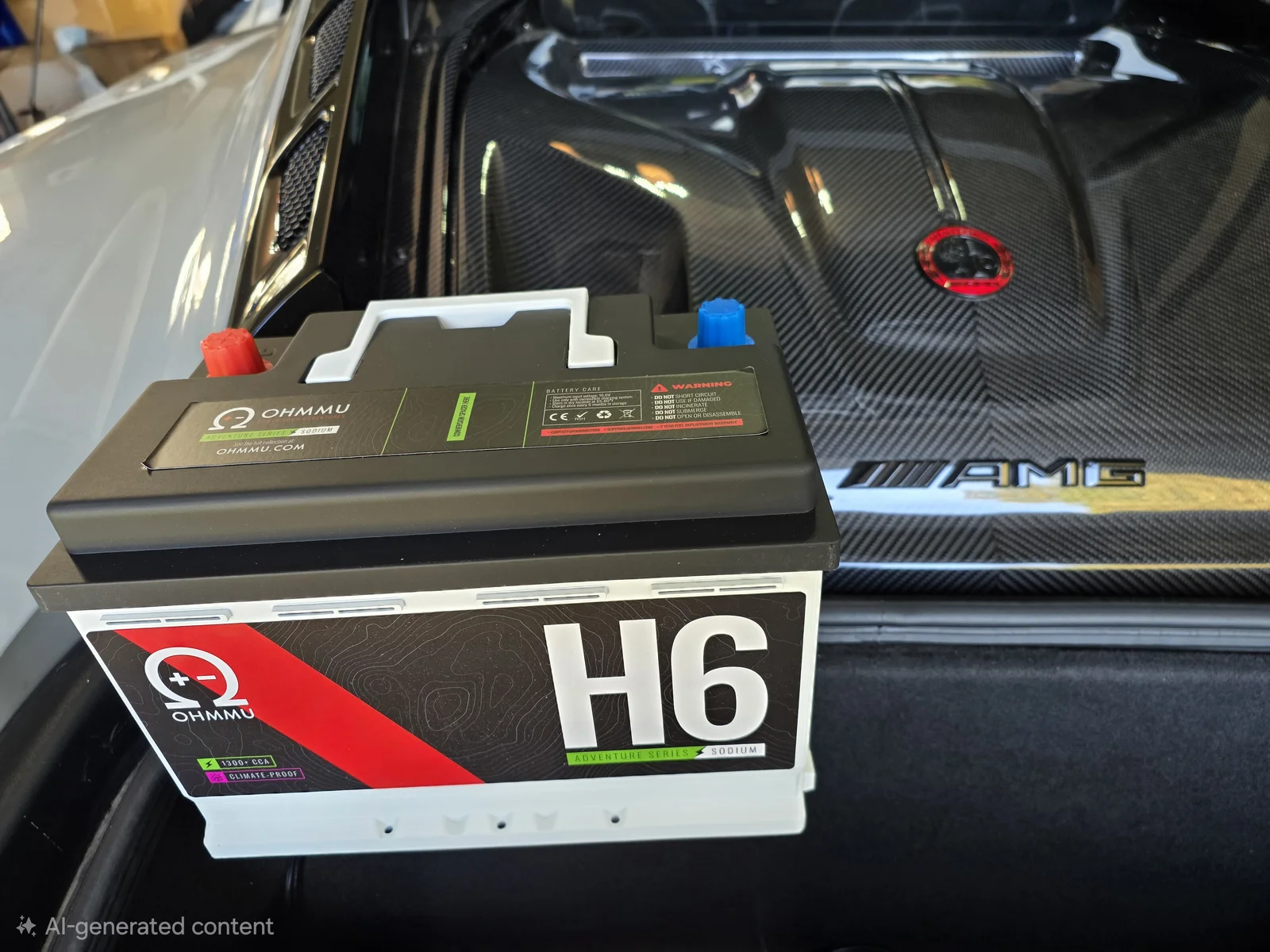

I’ve been using a Sodium Ion battery in my I4 for months. It charges fine, it charges strongly as soon as the car starts and quickly gets up to 100%. It works as the voltage curve is pretty much identical to AGM. LFP voltage curve is quite different and doesn’t play nicely with the alternator algorithm in our cars.
What's the advantage of the sodium ion over sticking with OEM?

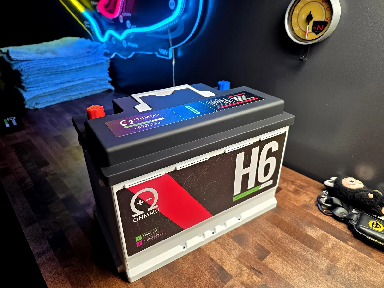

Lighter weight, about 1/3rd the weight of the AGM battery. My battery has Bluetooth, so I can turn off the output if I want/need to.
Sodium ion versus LFP. Voltage curve matches AGM closely, so the I4 charging algorithm just works, LFP doesn’t. NA (sodium ion) can be discharged to 0V with no issues. NA energy density is lower than LFP, so for our H6 you get maybe 35 to 40Ah, but it’s enough, just means it will not hold charge so long without usage, maybe 10 to 14 days IME.

ok OHMMU wrote back and said that their own charger will be coming out this winter and it will be a compact unit with bluetooth built in the charger for remote diagnostics. They said I can use my existing Antigravity charger in lithium mode for now and it will be fine to charge the battery that way. Will report back once it's all installed and I go through some cycles...will save around 30lbs and it's much cheaper than lithium. $11/lb of weight loss is actually very cheap compared to carbon fiber or mag wheels, etc. (dude math)
16lbs, will install and report back - should have no news other than it works 🤞

Kaz had his installed yesterday. I'm installing mine tomorrow.
And yes, this should be easy plug and play with no issues for the i4. Will monitor SOC behavior with battery tracker and report back. ;)
