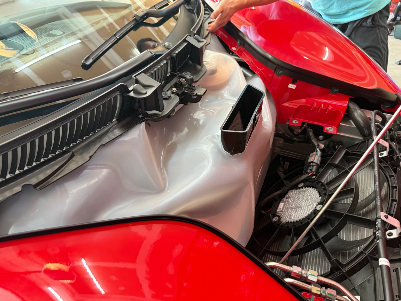

- update. Tech called this morning and said he discovered water in a wiring harness upstream of the airbag module main connector. Cleaned it out and all of the warnings cleared. Not sure how the water got into the harness so he is checking with the field tech to find out if he needs to do anything else before putting the car back together.

It sounds like it could be related to water intrusion problem a number of cars have experienced causing electrical system gremlins. As a result, many have installed a much larger and more durable water protection membrane over the much smaller OEM membrane, which is brittle and subject to cracking, even in the newest cars. My new '26 was already beginning to crack when I checked. There are a couple of threads here pertaining to that issue, and I know your tech is aware of the issue since we've discussed it with him.
We've had a number of very heavy (1-2"/hr) storms in this area, and a car parked in those types of downpours is exactly the type of scenario where water intrusion could happen because of so much water running down the windshield, overwhelming the drains, and flooding through the hood vents.
Below is a picture (without plastic covers re-installed) of the new membrane a fellow local owner installed in his and my car. It's made of a very pliable silicone material purchased from Home Depot. Your tech told us it would be advisable to install this over the smaller OEM membrane to avoid warranty issues associated with removing the factory-installed rubber shield.
