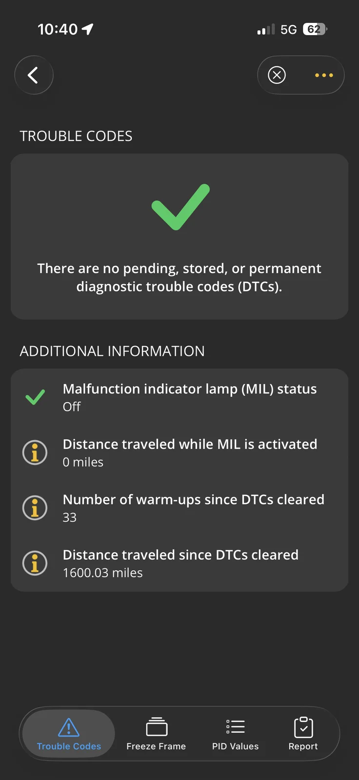

    • No DTCs listed with a code scanner. I have an OBD Link MX2+ that is capable of both high and low speed can bus work, checked both generic, and A and B bus, no codes present.

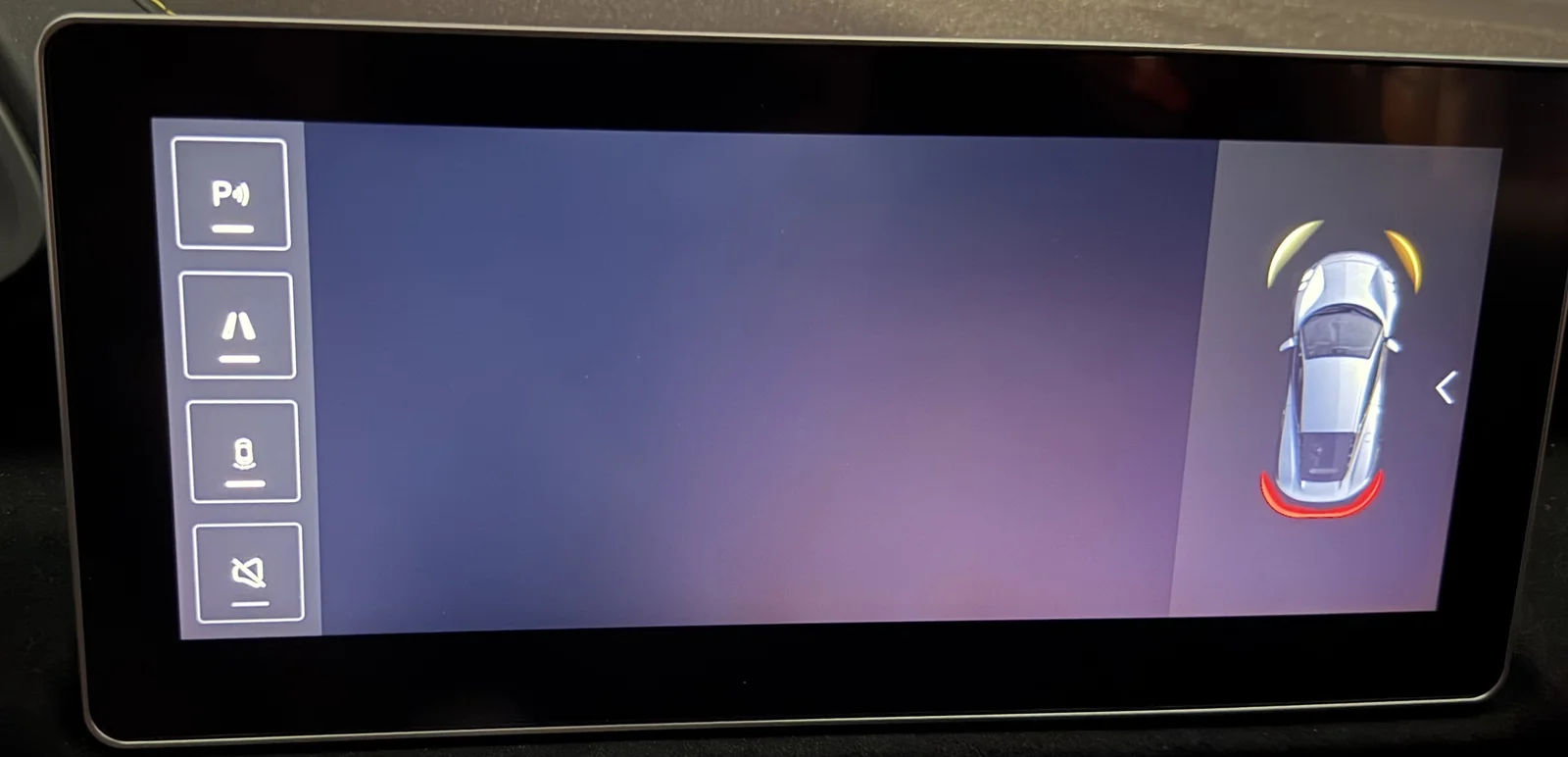

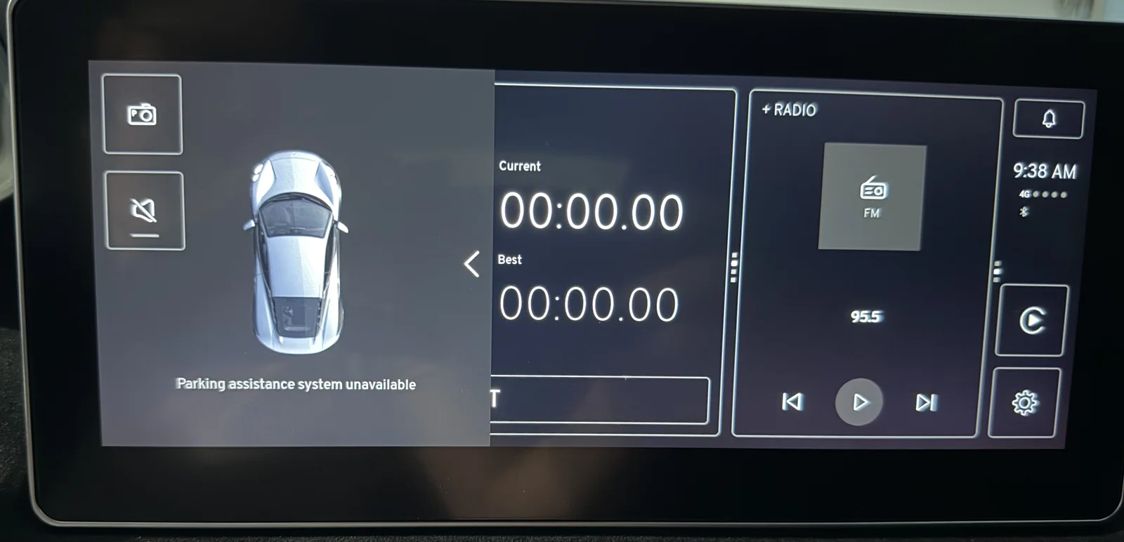

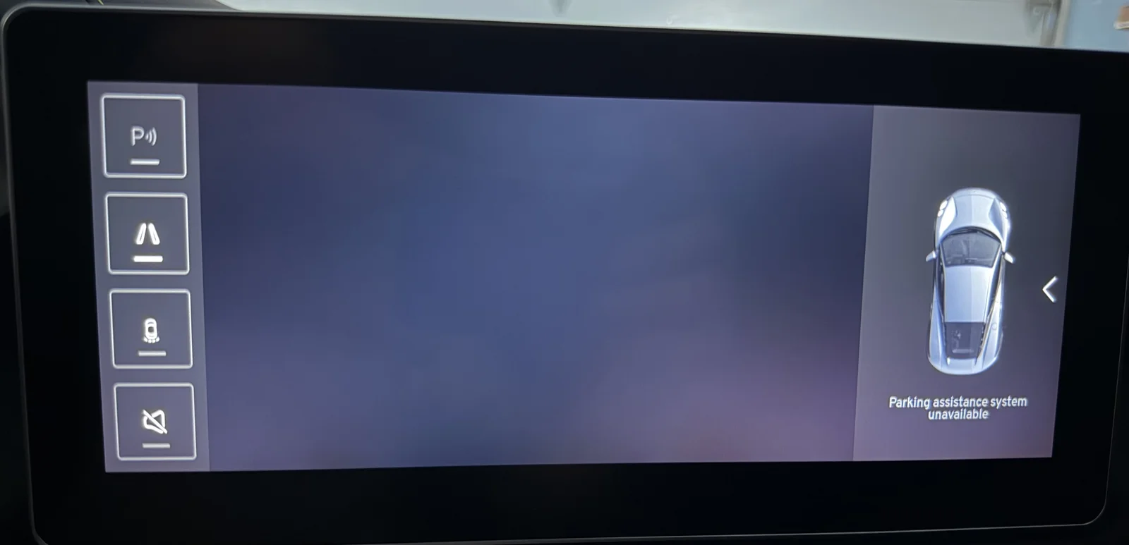

Yesterday, got in the lotus to head to my father's birthday part, and when I started the car, it took a really long time for the dash to come up. I had a progress wheels spinning on both the dash, and the infotainment displays, but it eventually came up. I figured it crashed and was rebooting. Not thinking much of it, I continued on my way, drove about an 1.5hrs, parked the car, and went in.
At night, when leaving is when I noticed the issue. No reboot spinning wheels this time. The infotainment was very sluggish with any button interactions either not happening at all, or extremely delayed. When I the car in reverse it switched to the rear view mode, but just a black screen.

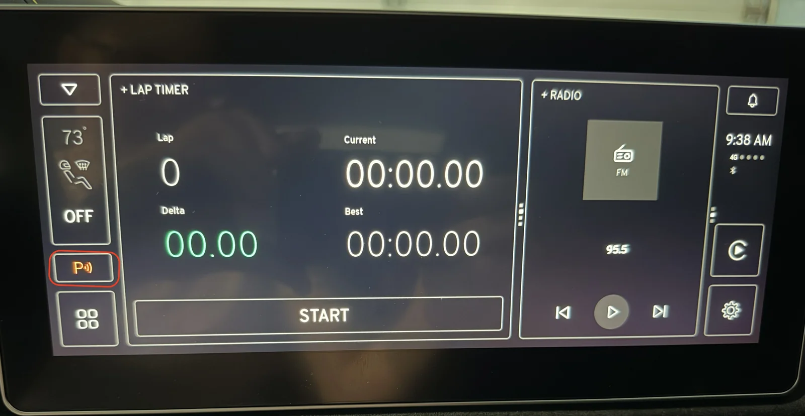

When the camera is hidden while in reverse, there is an orange Park icon that if pressed brings up the sensor mode, with the same message, Parking System Unavailable.
The sensors still work, and audibly alert when getting close.

Would be nice if it had set a DTC I could read, but thats clean.
