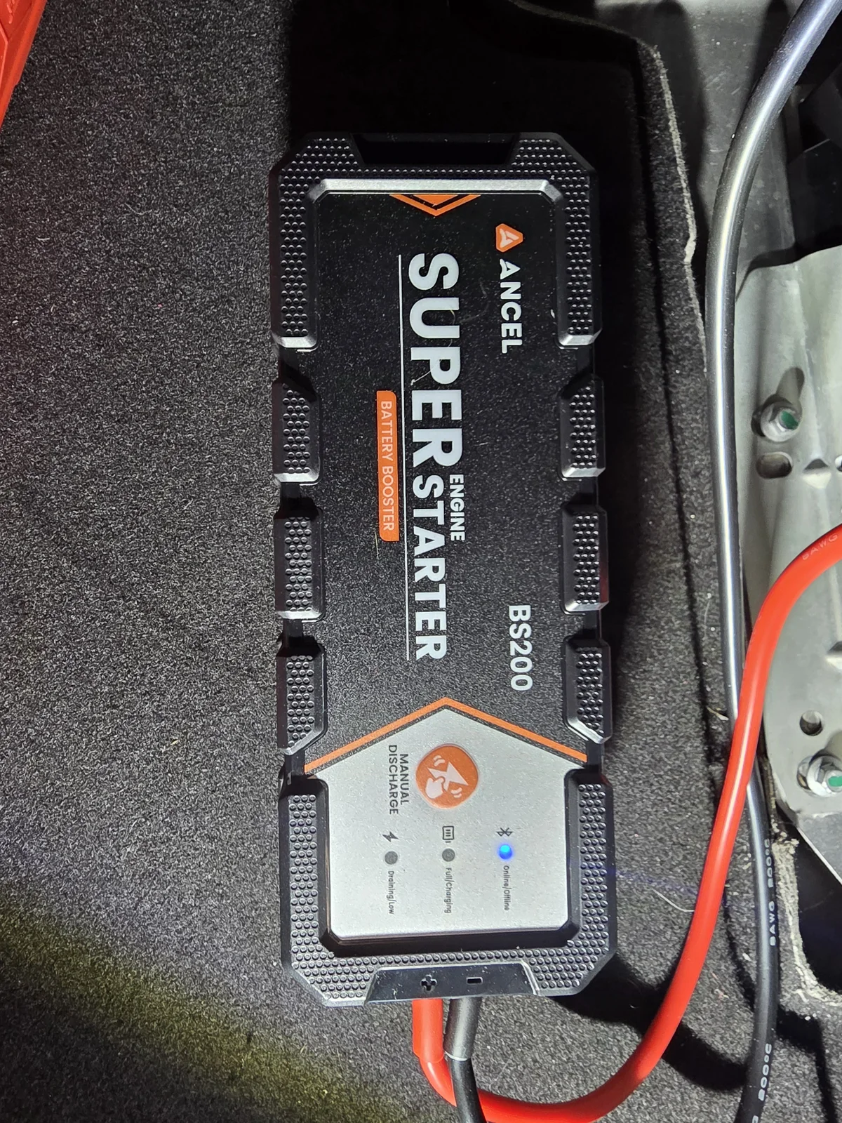

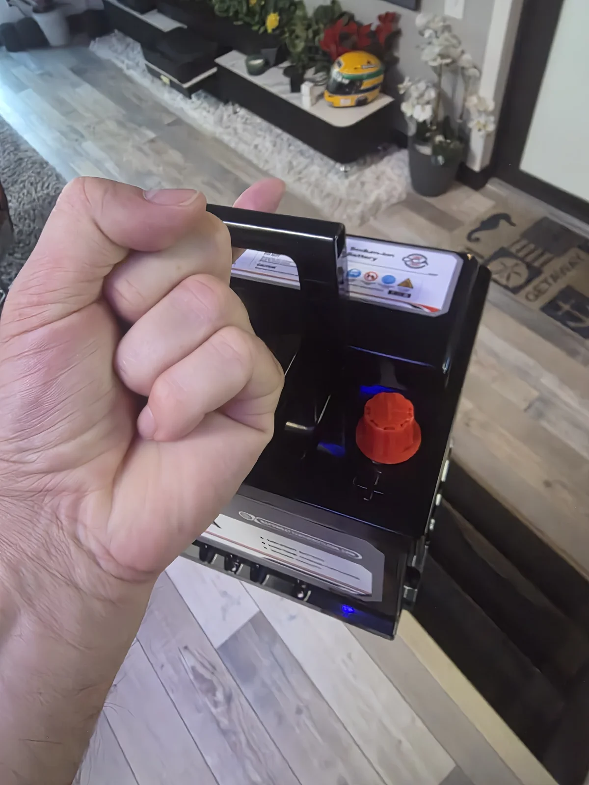

So here are the solutions I have come up with with this issue. I have a solid state lithium battery. I also have a supercapacitor connected to it that assist and guarantees super strong starts, recharges in seconds and minimizes the load on your battery everytime and never needs to be charged when connected to the battery.
Now in a pinch if you ever want to force the cars alternator to charge the battery simply pull the 2 wire plug on the negative terminal. The alternator will go into a default mode bypassing the logic and forcing a charge to the battery. You will get possibly a light on the dash but it will not affect how the car runs. You could run it like this way all the time as well but just keep in mind at least once a week put your lithium battery on a charger so that proper cell balancing can take place as it will not with the cars charging logic. It doesn't reach a high enough voltage to force the battery BMS system to balance the cells

I'm going to keep my supercapacitor connected. It gives me app info and guarantees a high voltage start evertime (not just when low) and pretty much leaves the battery alone for starts. Thanks for the heads up! $215!

New sodium battery it's only about 12 lbs. And reportedly has the same profile as a AGM battery. Seems like a win-win. Let's see how it goes

6640 a.m. I'm using the supercapacitor to guarantee an easy start seems like cheap insurance for a guaranteed start every time
