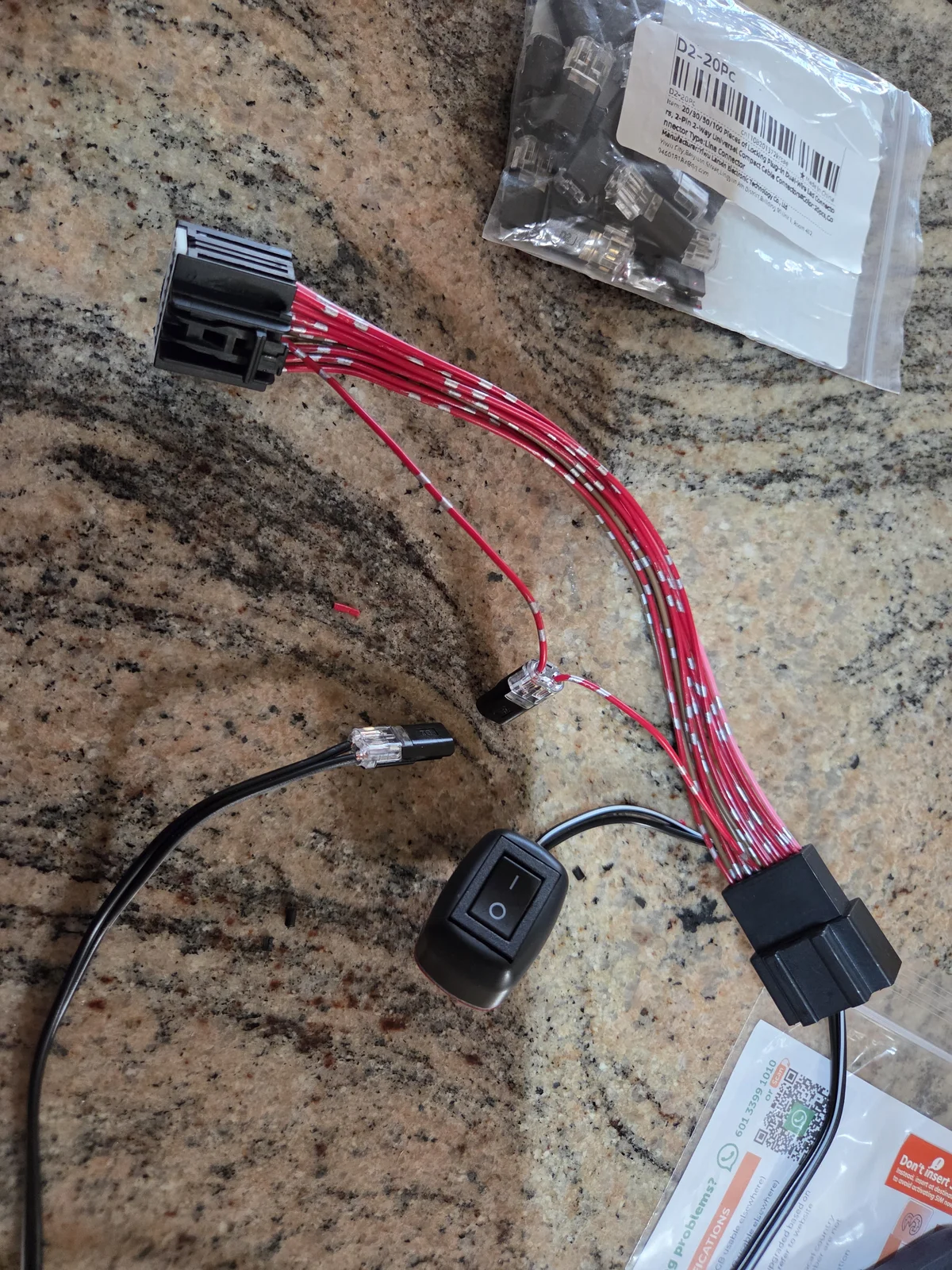

Just completed mine with a harness and switch from AliExpress. In case I ever decide to go back to stock.
