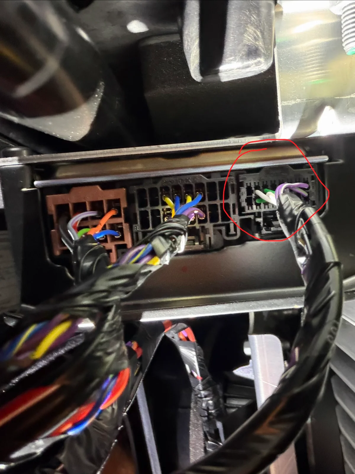

I’m bad at depinning anyone got any pointers to depinning this connector and recommended tools? Don’t really want to cut the wire
If it helps this is the shape of the back of the connector
Edit:
Found the connector. Will make my own bypass https://www.aliexpress.us/item/3256807542658712.html

Do you want to depin or just cut the wire? You could also buy the cable I posted and create a bypass cable by cutting the wire on that, that way it’s fully reversible. Hardest part is probably just getting that stupid carpet corner panel off.

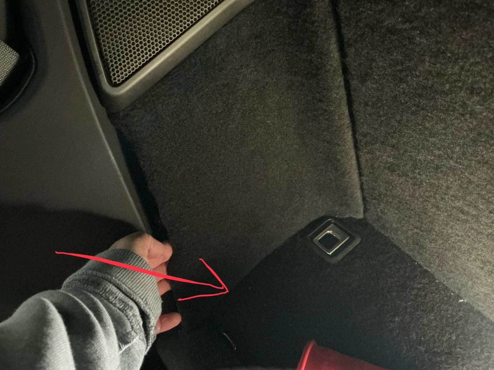

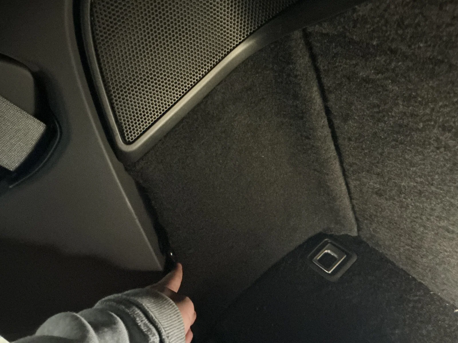

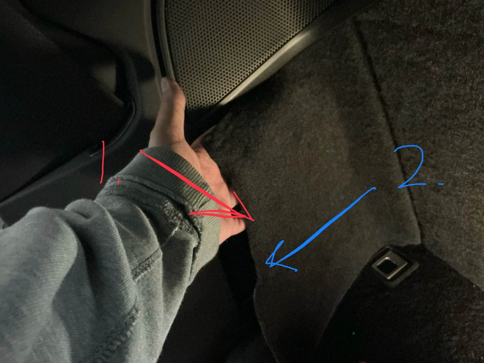

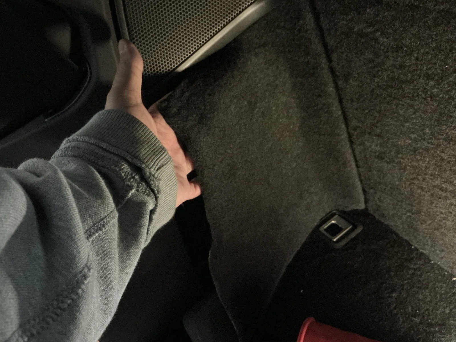

Okay, this is how i remove it. Take it for what its worth.
If looking at panel head on, there is a black bracket on the bottom left of the panel. I stick my finger in there and pull panel out. You will disengage the bottom yellow clip.
I shimmy my fingers upwards towards the top and pull. You will disengage the second yellow clip. Note: why its difficult to remove and reinstall is the top edge of that panel sits well under the plastic trim of the speaker grille. Just pull upper left corner of panel out from under the speaker grille.
Then continue to pull panel out and then forward to completely remove. There are guide tabs on the right side of the panel (firewall side) but no retention clips.

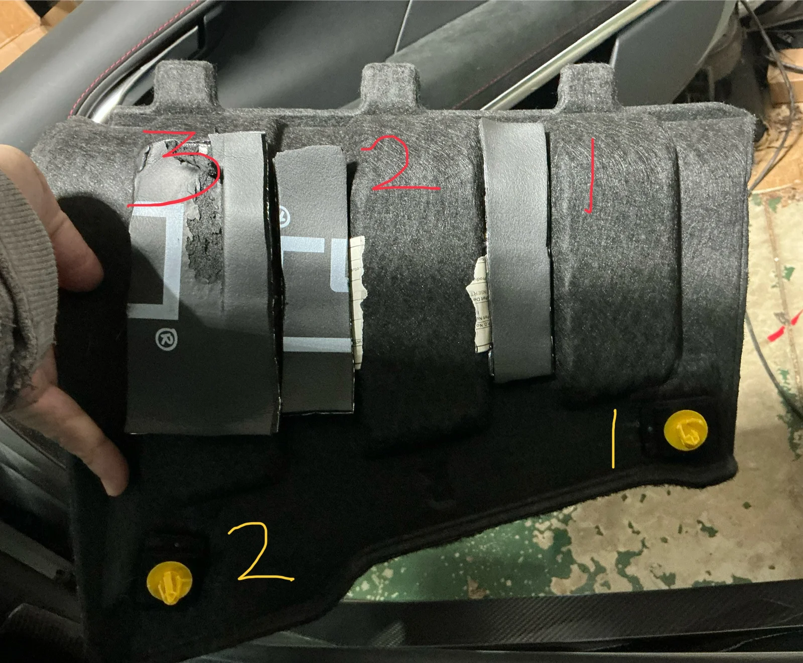

In this next pictures, you can see the 2 yellow clips and the 3 guide tabs and their corresponding insertion locations. (Dont mind the sound deadening material on the panel)

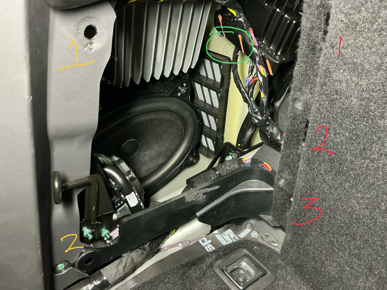

you can see the wire that need clipping circled in green….lol. I didnt tape it off (probably because i was pissed at how hard it was to remove the panel!)
To reinstall the panel is also a major PITA your first few times…i can fly it in there pretty easily now. The best way I do it is lead with the right upper corner under the speaker grille trim first, push panel back towards firewall, bend left upper corner of panel under the speaker grille trim and then push bottom of panel back into original position. Only after i get panel seated back into original position do i then reinsert the yellow clips and guide tabs back into their appropriate slots.
Hope this helps!
