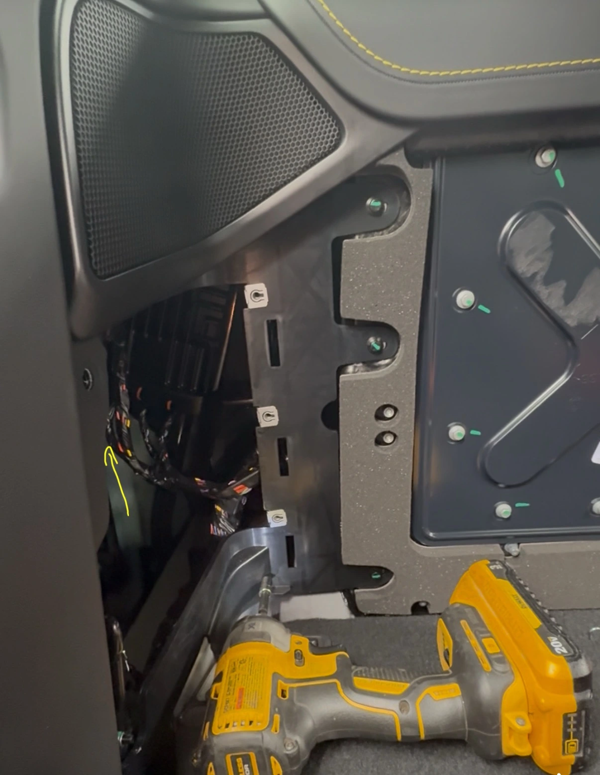

So I looked backed through my photos and realized the video I thought I was recording wasn’t actually recording so all I have is the initial portion of taking the trim off. I tried to screen shot the best I could with a yellow arrow pointing to the wire bundle. I’ll take the trim off and get a better pic today. It’s super easy to get to and should only take about five minutes. Pull the corner trim from the right side (passenger for me). The wire harness you need is the far left bundle of wires that connects into the bottom of the black amp. There are three sets of wiring bundles the connect to the black amp. Cut back the electrical tape on the left bundle and it’ll be the green (with a thin yellow stripe) wire. Wrapped the exposed wire ends and that was it.
Agree, I saw the access was a quick pop off of that side panel in the other video I referenced. Thanks for providing this pic. I think I can see which one it is now with this pic as a point of ref. Appreciate it brother.
View attachment 63687So I looked backed through my photos and realized the video I thought I was recording wasn’t actually recording so all I have is the initial portion of taking the trim off. I tried to screen shot the best I could with a yellow arrow pointing to the wire bundle. I’ll take the trim off and get a better pic today. It’s super easy to get to and should only take about five minutes. Pull the corner trim from the right side (passenger for me). The wire harness you need is the far left bundle of wires that connects into the bottom of the black amp. There are three sets of wiring bundles the connect to the black amp. Cut back the electrical tape on the left bundle and it’ll be the green (with a thin yellow stripe) wire. Wrapped the exposed wire ends and that was it.
This is SUPER simple clear view...if I only had a time machine and zipped forward to see this lol

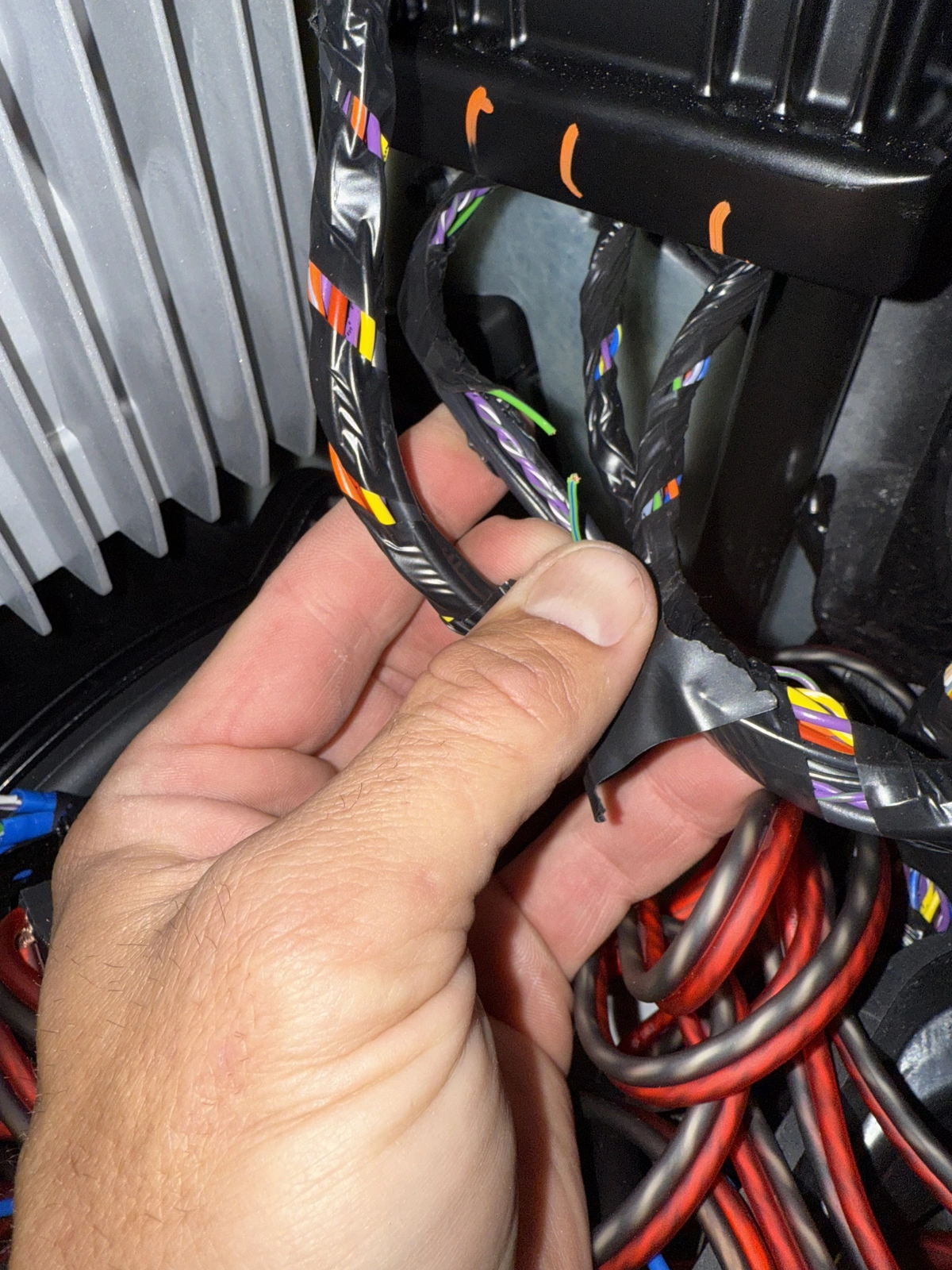

yep and it's pretty obvious when you get rid of the fake noise, but yes verified the diagnostics initially came from Lotus service on where to find the ECM and what it was putting out, then my audio shop ran tests on all the wires and found the rpm signal going into the dsp (the only wire that had variable voltage as they were testing the throttle). And you've seen the video I posted right? I don't know how to demonstrate any clearer and now anytime you hear an AMG M139 you'll recognize the fake sounds.
Kaz went through a much better verification process than me. I just put my ear next to the rear speaker while giving it gas; before and after cutting the wire. Sound was there before and no sound after. Both times the radio was off.
DONE. Easy access, quick work, and soooo much better!! Not over the top great, still needs some fine tuning and testing, but the bass distortion is remarkably less, even at volume.

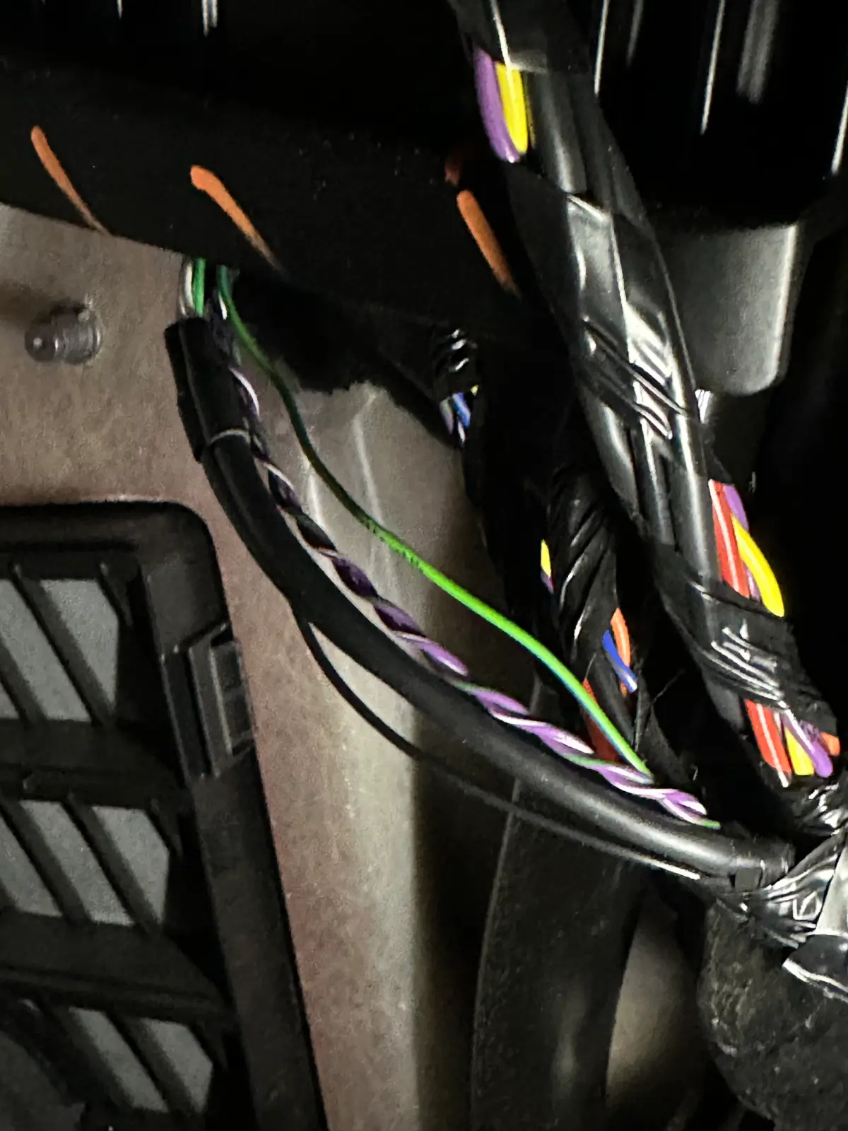

Here’s a better view of the wire. View attachment 63775
Hello, you say in your post green wire with a yellow stripe. But on the pic and on my car, it looks like a green with blue stripe ?
That green wire is alone with the grey/white/purple wires. They are 2 other green wires but they are in pair in thermal/plastic sheath.
