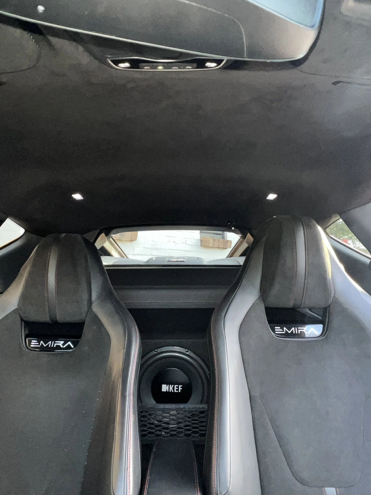

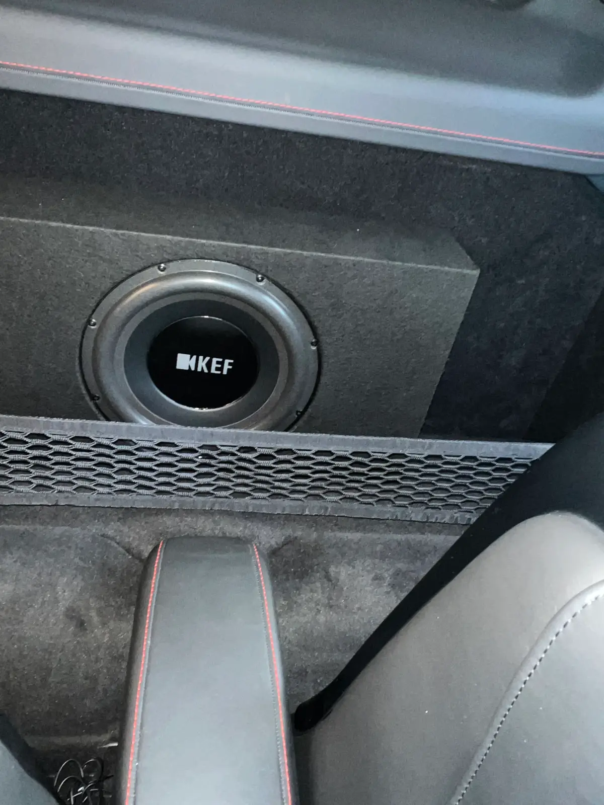

I experienced exactly the same when Tapping into the sub wires to fit my amplified subwoofer
I eventually got round it by tapping into the right + wire and the left - wire of opposite inputs.
I can’t remember out of the 4 cables I did it to without stripping it down but
The fake noise dropped right down to normal levels and provided me the feed I needed to input the sub, I left the original subwoofer disconnect.
The amplified subwoofer now kick some serious bass and really enhanced (along with fitting the tweeters) the sound quality
The fake noise dropped right down to normal levels and provided me the feed I needed to input the sub, I left the original subwoofer disconnect.View attachment 61480
Interesting - will chat with my installer wonder if works for the door speakers
