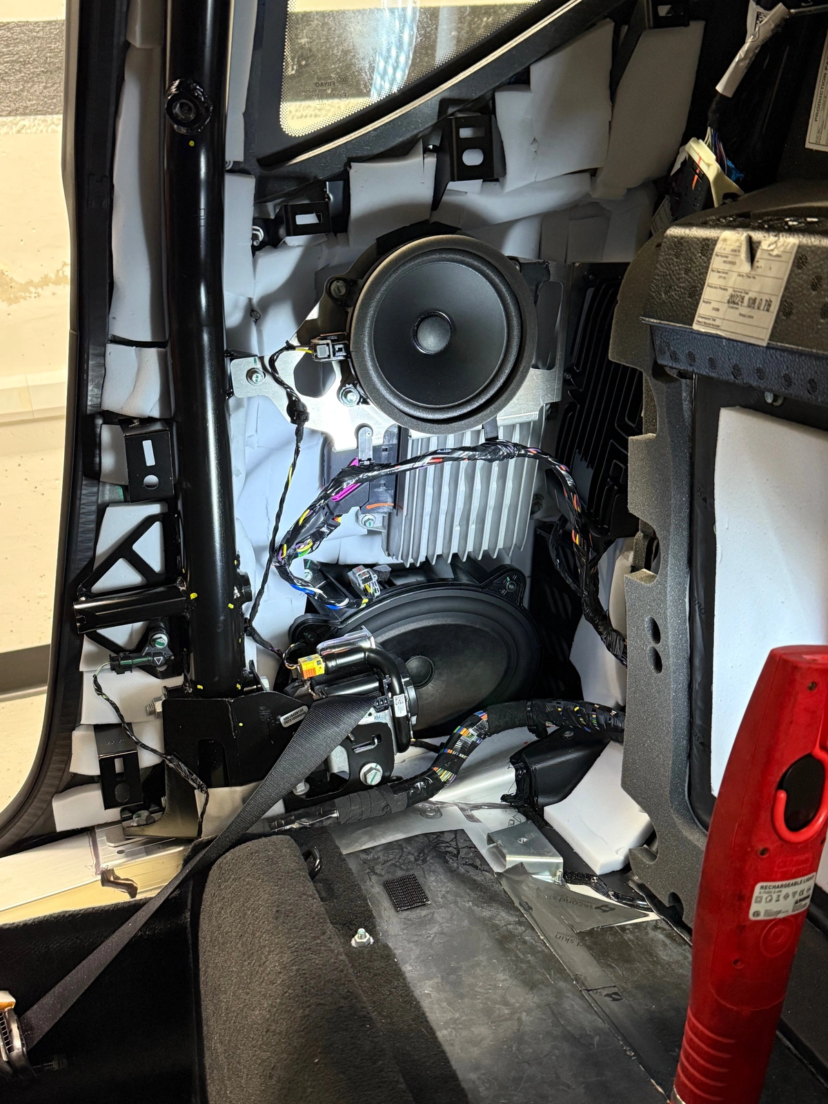

Thank you, this is great news. I know you had a couple of other threads on the sound deadening, etc., but the pics there didn't make it obvious. At your leisure, can you post a pic that shows the general location of the amp and this harness (if you even have one handy)? Trying to figure out if I'm brave enough to start disassembly.
If you look in the electronics sub forum there are incredibly detailed photos of amp/dsp installation from a couple authors, the area is the rear passenger side behind the passenger seat. The stock sub and electronics are all back there. You don't have to but, taking the passenger seat out will save you boatloads of backaches and there are multiple layers of things you take off to expose everything. Easily done in a day. If I were you I would just drop it off at FS Audio, have them soundsskins pro the car while they are at it -

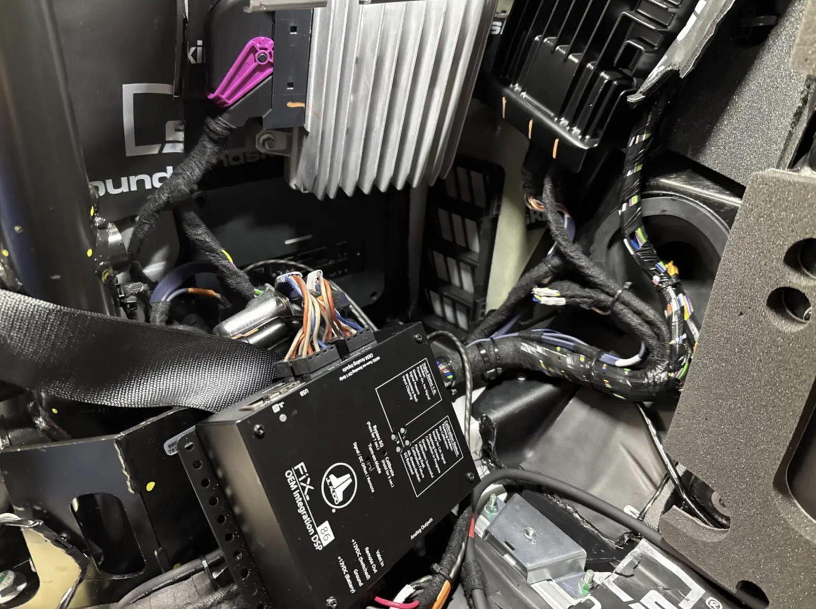

You should be able to just pop off the trim piece in the lower section of that rear quarter trim panel to access the amp wiring. I don't have a picture of how it attaches but it has 2 push in connectors toward the seat area and then pulls out forward once you pop out the front section. That is the only piece you should need to remove to access the amp wiring.
Same view just with more stuff...stock sub and speakers are all removed, Audison amp and JL Audio FIX eventually mounted where sub was -

oh also, in case any of you go cave diving into this, this weekend...there are three wire terminals that go into the stock black amp. Two of them are power, they send signal to the speakers and you'll see a bunch of bare wires converging into the terminal. The third one has two black wire looms and carry signal into the amp...the green wire is in that one, it's the only terminal with those two wire loom bundles covered in black. @docron
