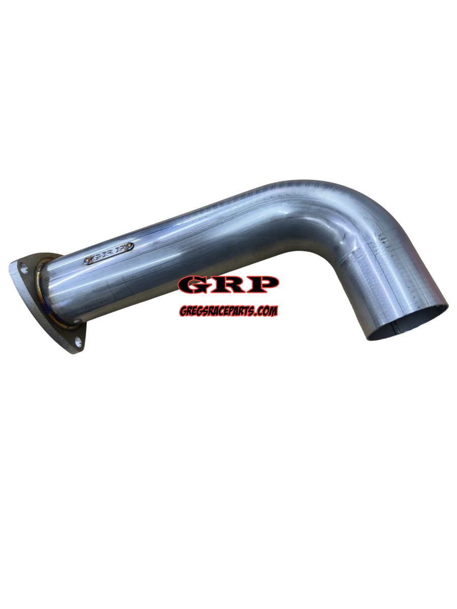

How did you do the cat delete? And, where is the 3rd cat located?
Aren't you the one that started this thread? The third cat is right in front of the muffler, it's the short J-bend pipe that connects the rear exhaust system to the midpipe.
GRP sells a nice one.

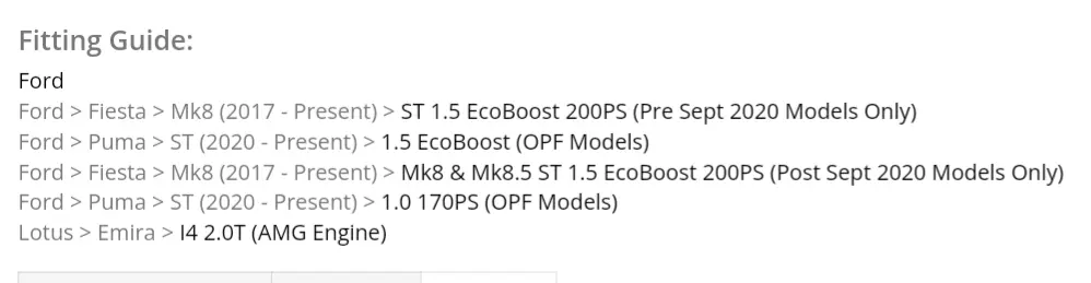

It's my understanding that the Milltek kit isn't explicitly designed for the Emira at all, it was a kit for the Ford Fiesta that just happens to fit the Emira. If I remember right, one of their UK dealers figured out the compatibility.
They still show it blended for the I4 on part number SSXFD413 (F for Ford), though they've made a new part number for the V6, SSXLO6. That number comes sequentially after the exhaust products though, and the valve controller has been available from them since before the exhaust was designed and produced.
That's certainly interesting to know and thanks for that research, however it's still a mystery as to why they would design the by-pass feature of their valve controller to potentially transmit data on a one way basis as opposed to bi-directional as suggested above by EmirOfDenmark and advised by his local Lotus dealer mechanic. It's important for those of us who like to use both OEM valve mode in addition to the Open valve one, without risking damaging the engine. Anyone know how one goes about tagging Miltek on this thread so they can provide clarity to this issue?
I have no idea. I assume it's because the Ford Fiesta didn't require it.
Yes, just making sure we’re talking about the same thing. Thanks.

As for the 3rd CAT delete, the advantage of the unobstructed replacement pipe is that the exhaust fumes can be directed from the engine towards the muffler more freely, faster and without the additional choking of sound, a job that's better left for the muffler to perform. Hope this helps to add some clarity and, by the way, no question is a dumb one.
