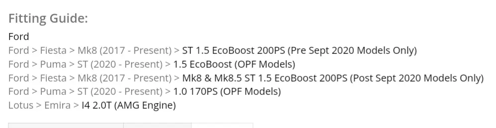

It's my understanding that the Milltek kit isn't explicitly designed for the Emira at all, it was a kit for the Ford Fiesta that just happens to fit the Emira. If I remember right, one of their UK dealers figured out the compatibility.
They still show it blended for the I4 on part number SSXFD413 (F for Ford), though they've made a new part number for the V6, SSXLO6. That number comes sequentially after the exhaust products though, and the valve controller has been available from them since before the exhaust was designed and produced.
