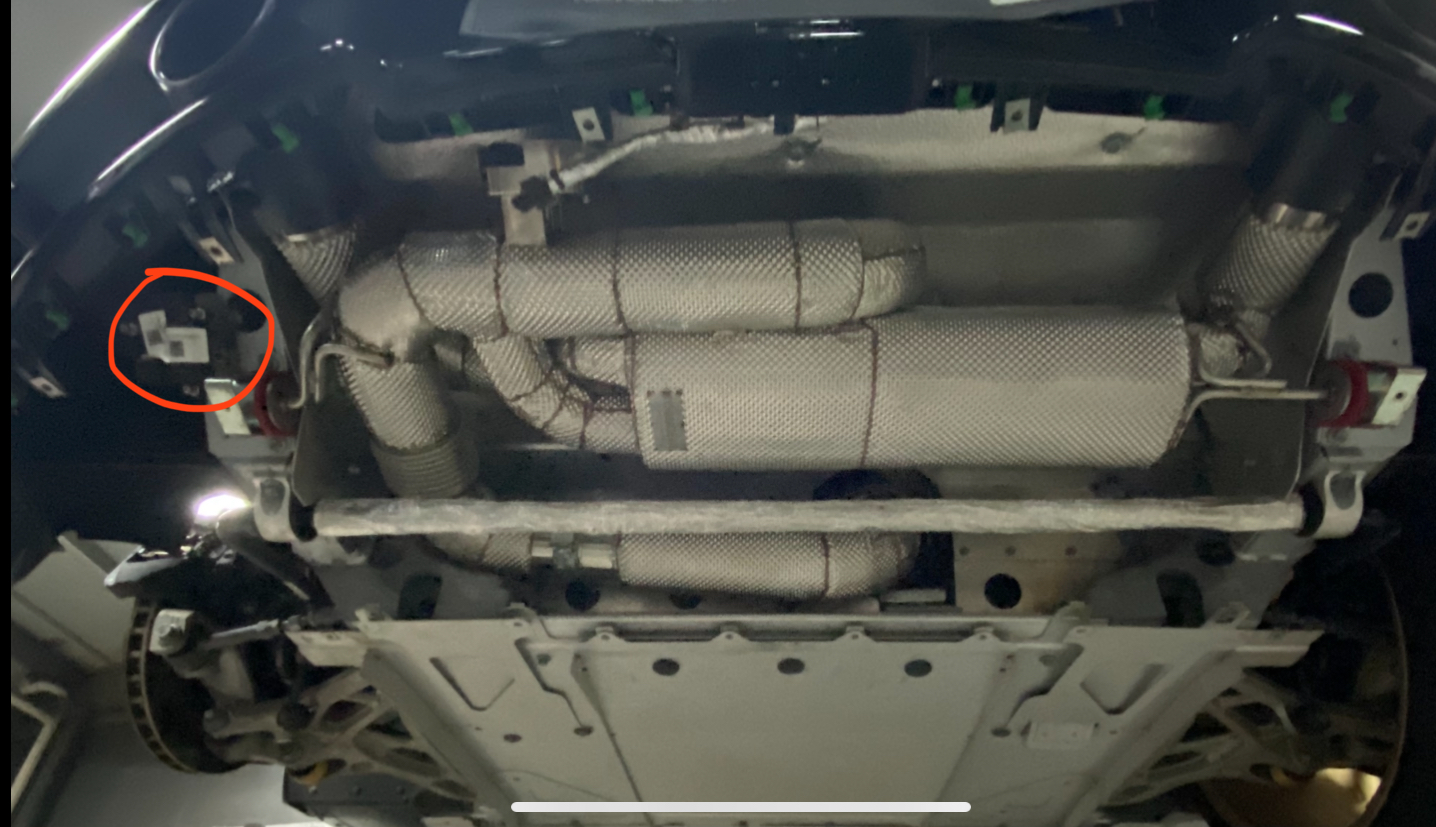

Its something going on with the exhaust valve, either the valve motor itself or the controller.

I don’t think anything melted because nothing is near the exhaust. The 02 sensor issue was there before I tracked . It may be an installation issue with the spring not being used with exhaust, but I won’t know until next week when the diffuser comes out.
The dealer installed it so I hope they didn’t mess up.

The ECU expects a particular voltage range from the sensors. If it doesn't get this voltage, you get an immediate O2 error code. The code will tell you which sensor. The ECU also compares pre-cat/post-cat O2 readings against each other if sensor voltages are ok, that's how it tests catalyst function.
If you log the voltages, the pre-cat and post-cat O2 sensor readings should look like I describe in this post:
Your code, P0158 means that the voltage is too high in sensor 2 bank 2. Sensor 2 is post-catalyst. I'm not sure whether bank1 is the front or rear one, though, as I've not worked on the Emira too much yet. High voltage is suspicious, because it shouldn't happen. The voltage in an O2 sensor comes from the chemical reaction with oxygen and should be between 0 and 1 volts for a narrow band sensor (which is what I think is in the Emira, but it's 0-5V roughly if it's wide band). Anyhow, your ECU is seeing more than max voltage. How can this happen? Maybe some insulation melted and the sensor heater wire is connected to sensor reading wire? Gotta give it a good inspection and log the voltages.

It was a melting issue afterall. Those of you who run the car hard, escpecially if tracked, will have a problem. Insulating it or the exhaust may help.
The manufacturer and those who sell The Milltek valve controller should tell us that heat wrapping and insulation is a must. I assume that's why The V2 version is out now. Don't buy the old version and lets hope the new version doesn't have these issues. Thank you everyone for your suggestions and testimonials.
Sucks so bad that I had to run 2 track days like this, but it will make me appreciate it alot more when I got full power. Considering I was only using about 250 horse power, it really impressed me, even though I was running like a Miata. It did make me focus on my entry and exit lines better.
That's what our experience is tracking in China for more than a year, I have been telling ppl here the potential risk but nobody really listen. If you track a lot, the safest approach is SS exhaust with heat shield, OBD value controller, and move the value motor to a cooler location.
