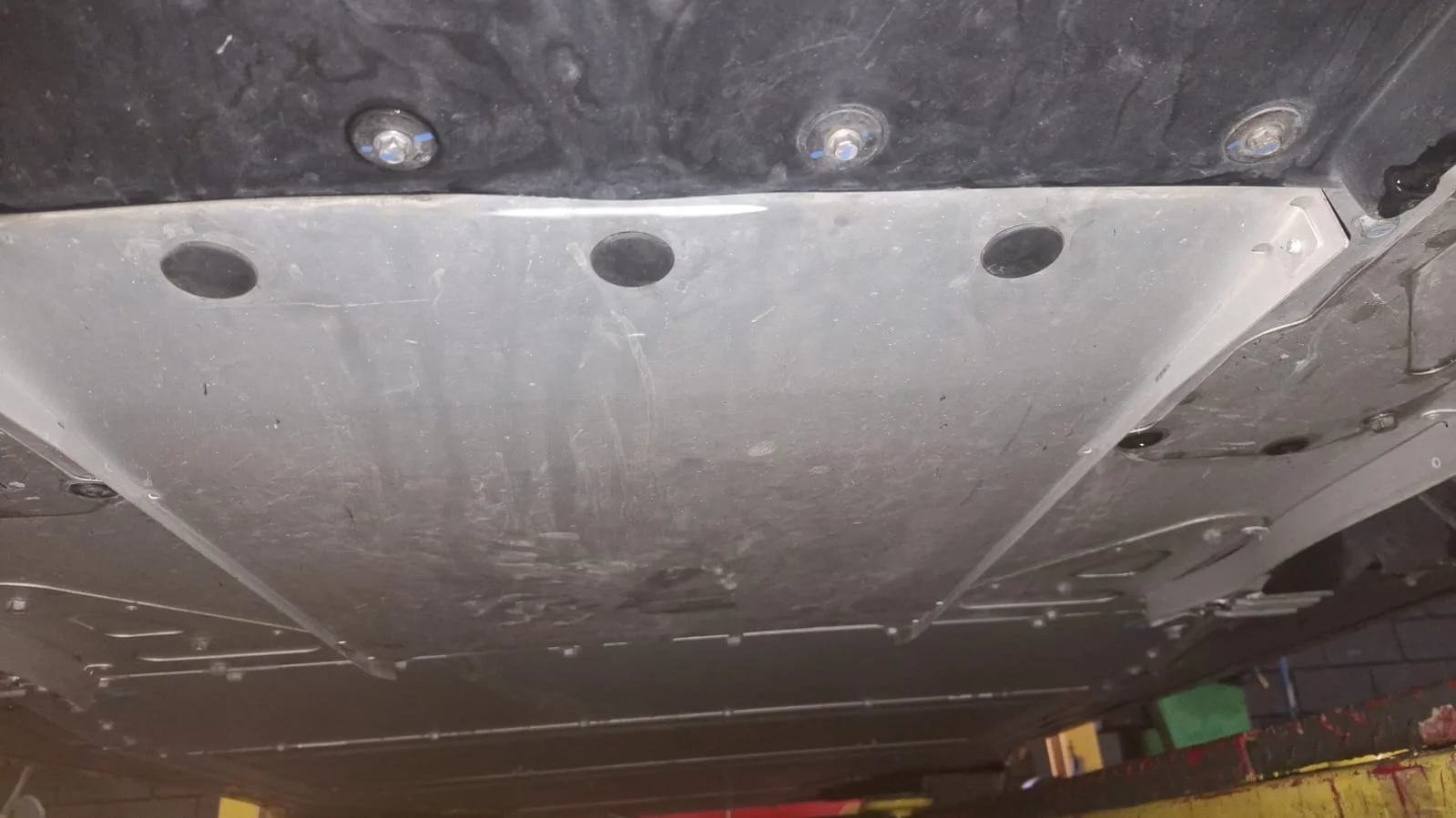

PatrickJS has noticed a difference in transmission not over heating when removing the triangular metal plate cover under the transmission. He will try to post something this week. I will be removing it and installing JUBUs rear plate ventilation kit.

Did not know there was a triangular metal plate cover under the transmission, I will ask the guys to see their thoughts on removing or what it is supposed to do.

I’ll get it done this weekend. I dont remove the triangle part I just open the gap so it acts like a vent. And the vents are noticeably under the oil/transmission. When I had them closed vs open I noticed the transmission didn’t overheat as often when it was opened

Guys were unclear on what triangle part could be removed and sent me a vague photo which I also did not know exactly what you have removed @PatrickJS so have left to just try one thing at a time and will wait for a photo post from you.
