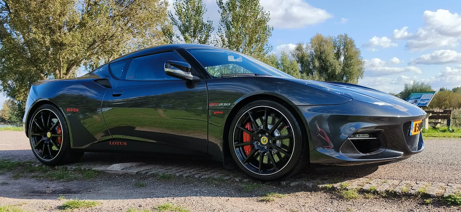

I own a 2021 new purchased Evora GT 410 Sport IPS (automatic)
I installed 3 temp. meters and found that these temperatures during moderate driving at 75 mph and 22 degr. C / 72 degr. F. outside temp. are:
1) Engine oil typically approx. 80 degr. C. / 176 degr. F.
2) IPS oil temp. typically approx. 60 degr. C. / 140 degr. F.
3) Compressor cooling water temp. typically approx. 30-35 degr. C. / 86-95 degr. F.
