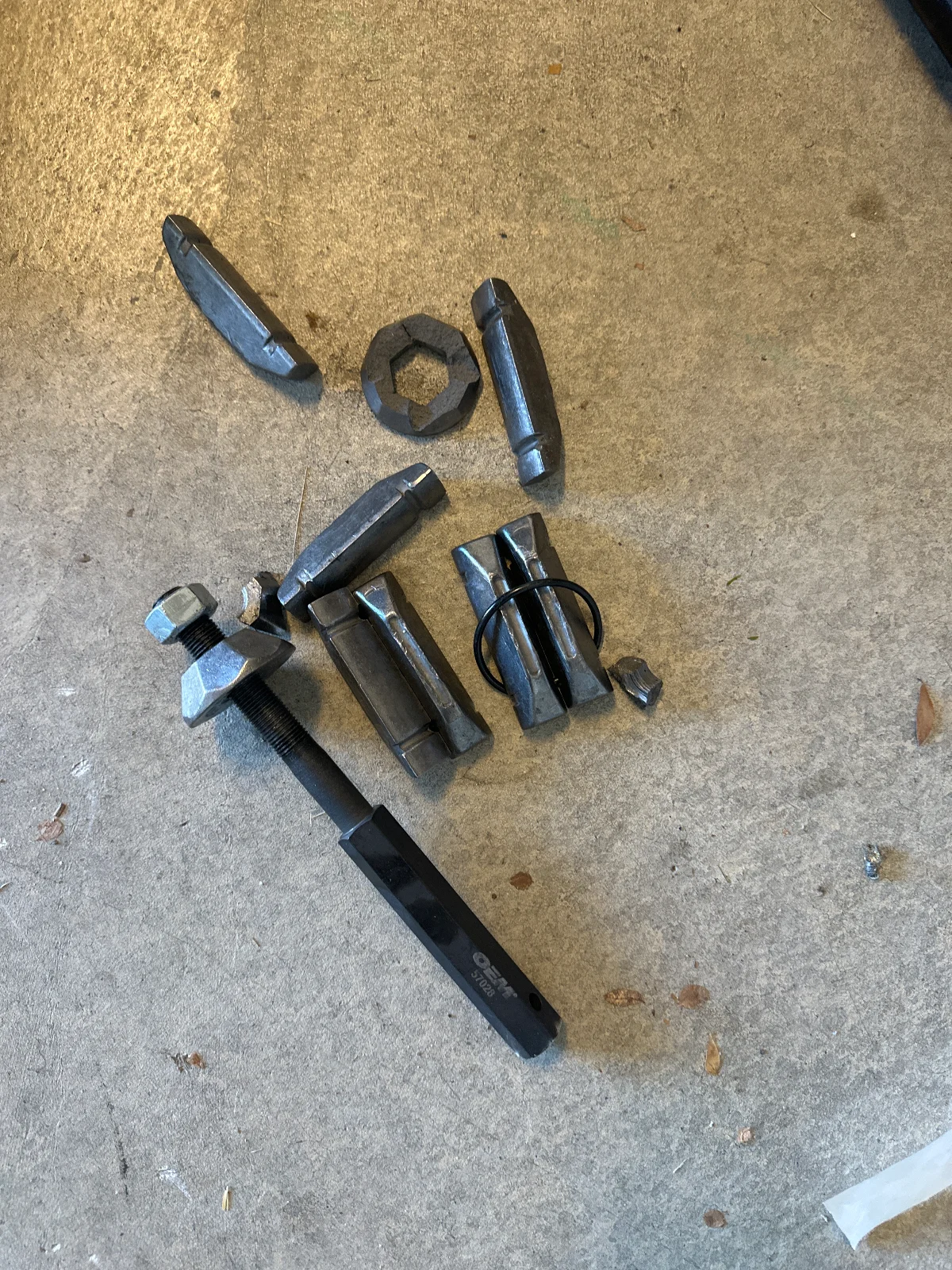

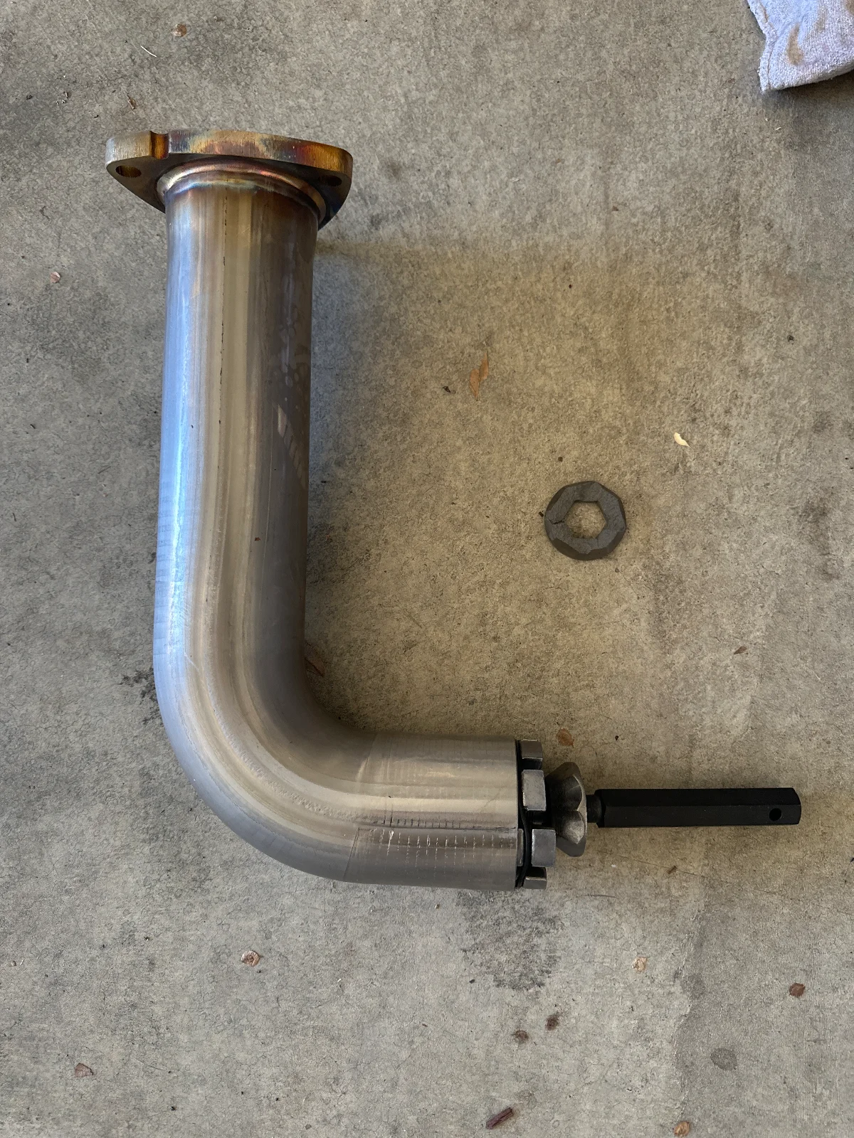

Anyone deal with a pipe expander breaking while expanding the pipe, doing my cat delete/valve controller, needed to expand the pipe, all was well until I decided to remove the pipe expander to recheck fitment, distal end of pipe expander came out the other end (broke) of the cat delete and it won’t retract to original size, stuck in there pretty good

I would suggest shimming the clamp, it works well and is much easier than expanding.

This is what I'd try...
Just need a good vise, a torch and a rubber mallet:
1) Tighten the vise on to the handle of the broken expander
2) Heat the outside perimeter of the 3rd Cat pipe with a torch to expand and loosen the metal.
3) Beat on the pipe from inside to outward and as close to its curvature.
Hope this works for you.

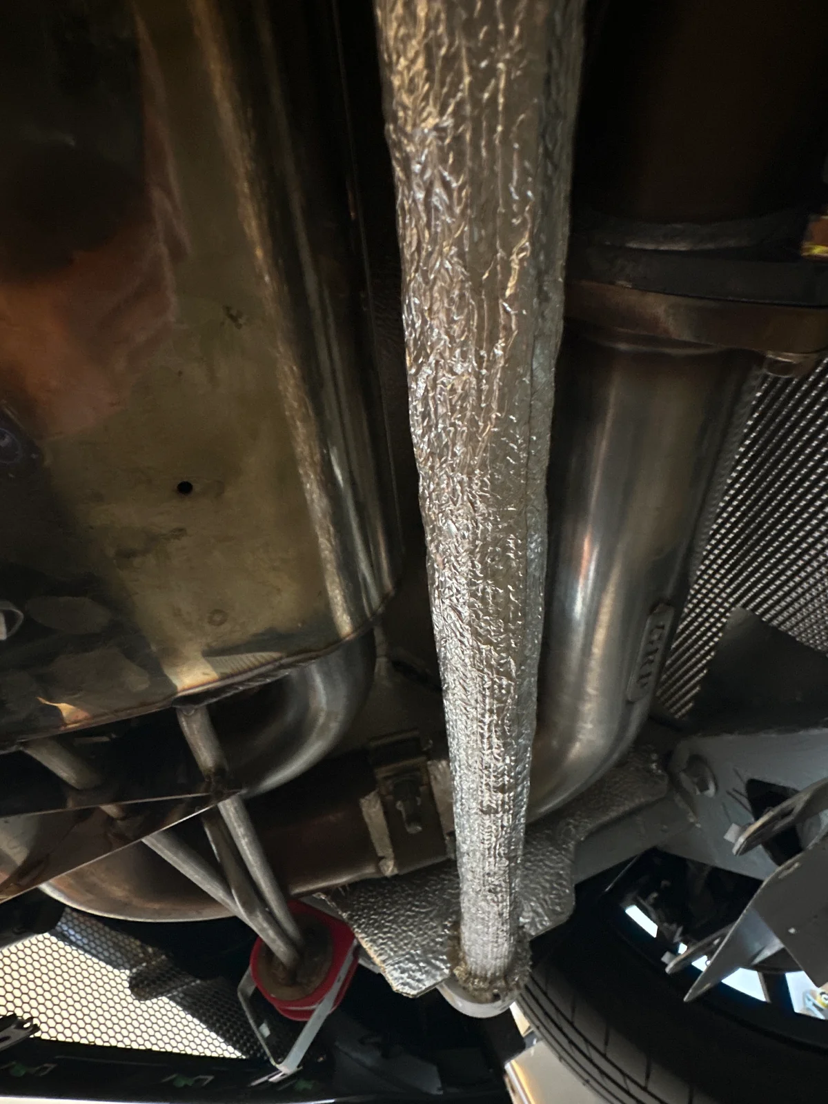

Update, pipe expander just fell apart after half an hour of messing with it. Placed some high heat wrap within stock clamp and was able to get a tight fit around cat delete, took the whole muffler out to make sure. Exhaust is all back together and now on to valve controller, should just be plug and play, less of a headache.

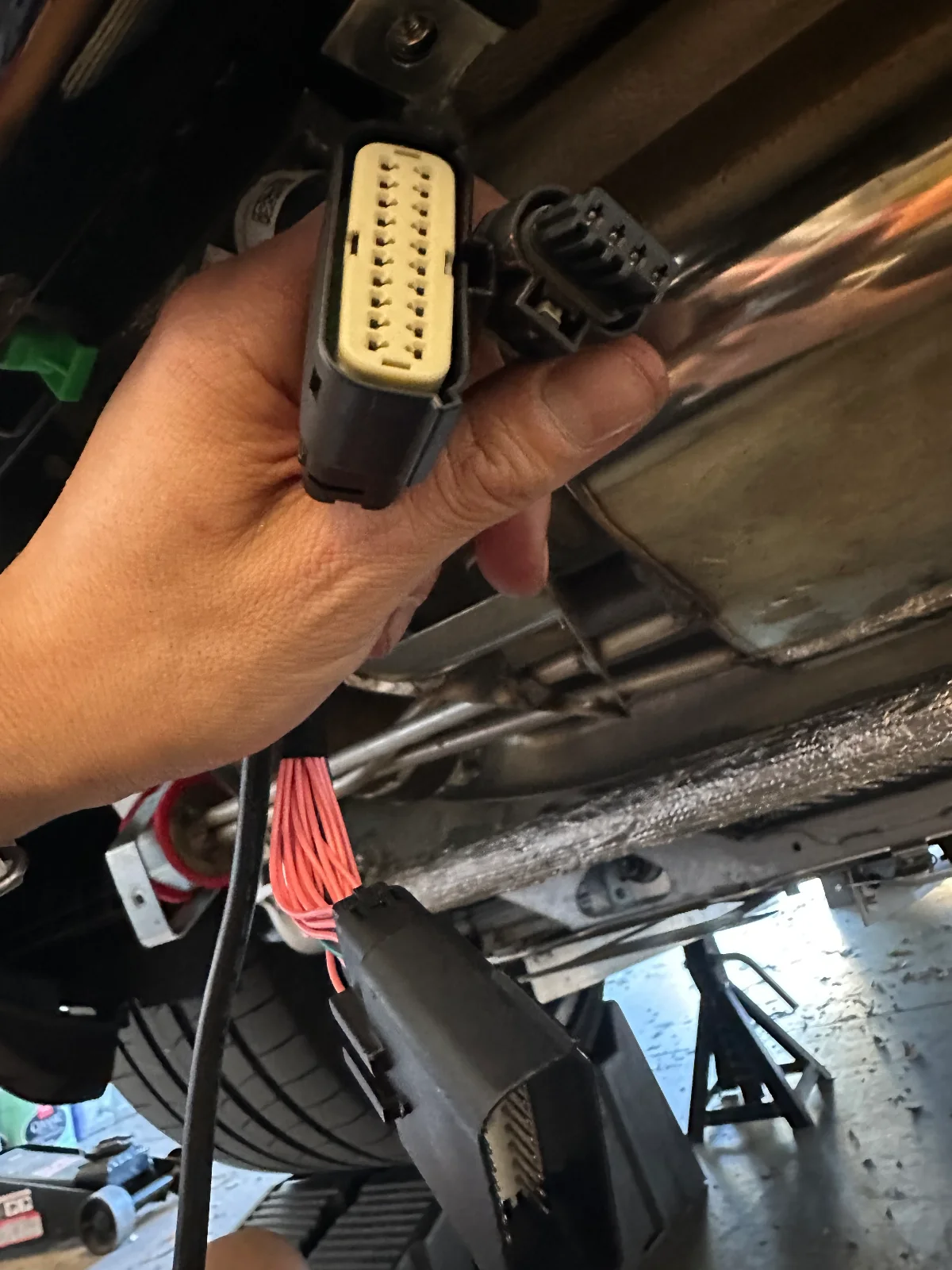

I prob shouldn’t have said anything until job was done. Watching the videos on YouTube for the milltek evm, should just be plug and play but I note the connections don’t match up. It should connect to module physically attached to muffler right? Or is the connection somewhere else?

You have a V2. The V1 connects to the sub-harness near the valve itself, but your V2 should connect to a sub-harness just behind the rear right wheel. You can access it with the diffuser off.
^ This.
See the installed pictures on our site for a good reference.
Thanks! Sun is setting but will do this first thing in the morning. Sounds great with just the cat delete alone, can’t wait to hear the end result with the evm
