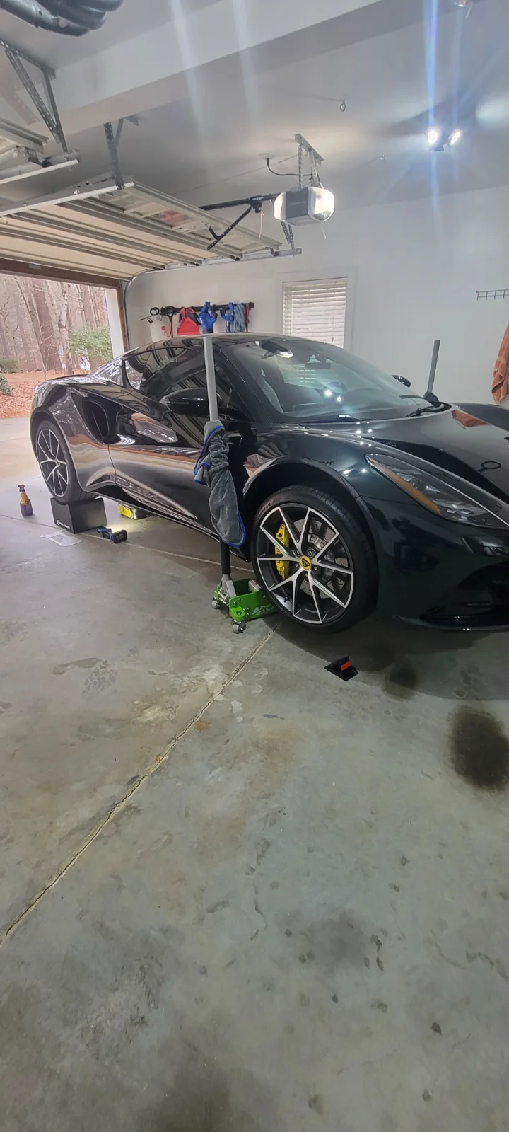

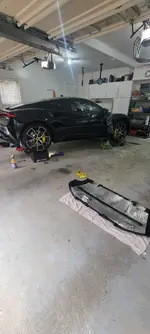

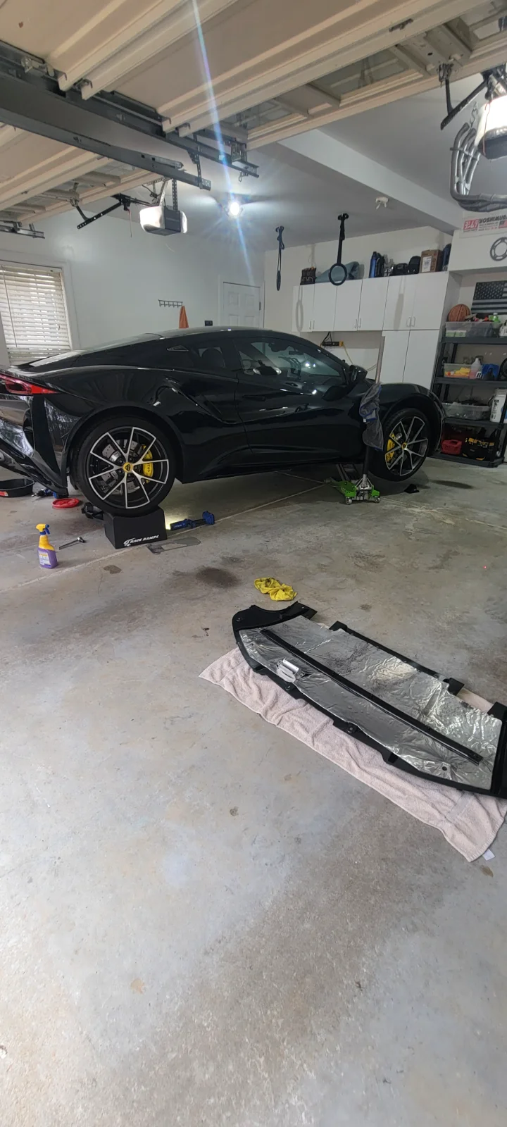

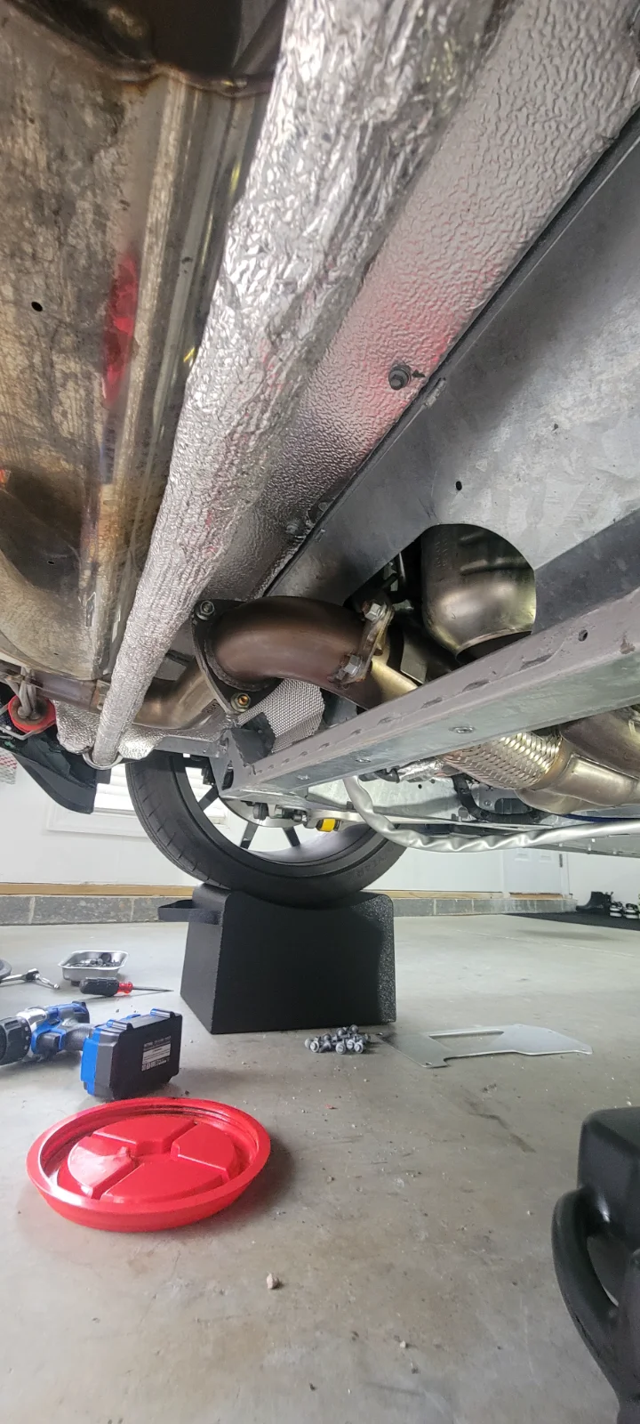

Not taking advatage of having the rear diffuser off and doing both upgrades at the same time is a huge mistake, unless you're really not looking to spend the extra money on one of the parts. The removal and install of the rear diffuser alone is worth doing this job once and being done. The cat delete treats some folks diffently, mine came off and straight pipe installed without too much hassle, the VC is as simple as it gets, routing the extra wire is the pain point here, if any. Do both, or you'll likely regret it later.

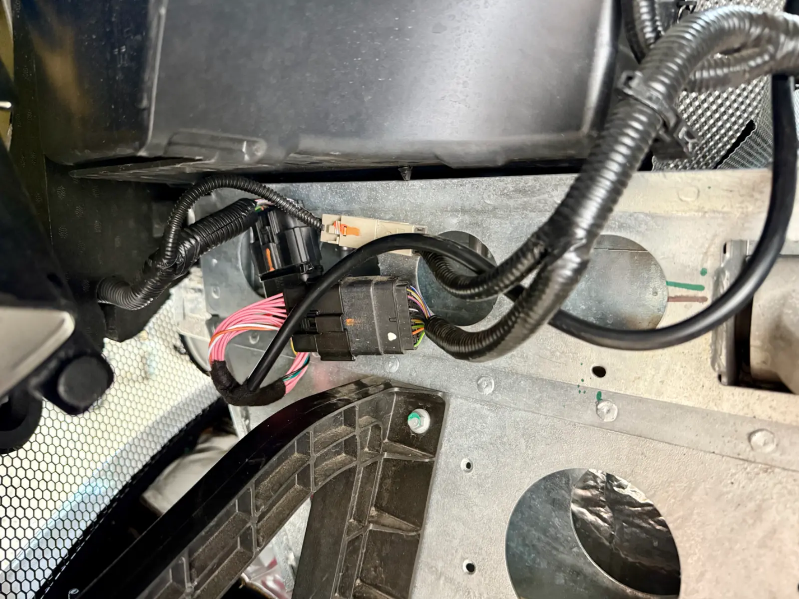

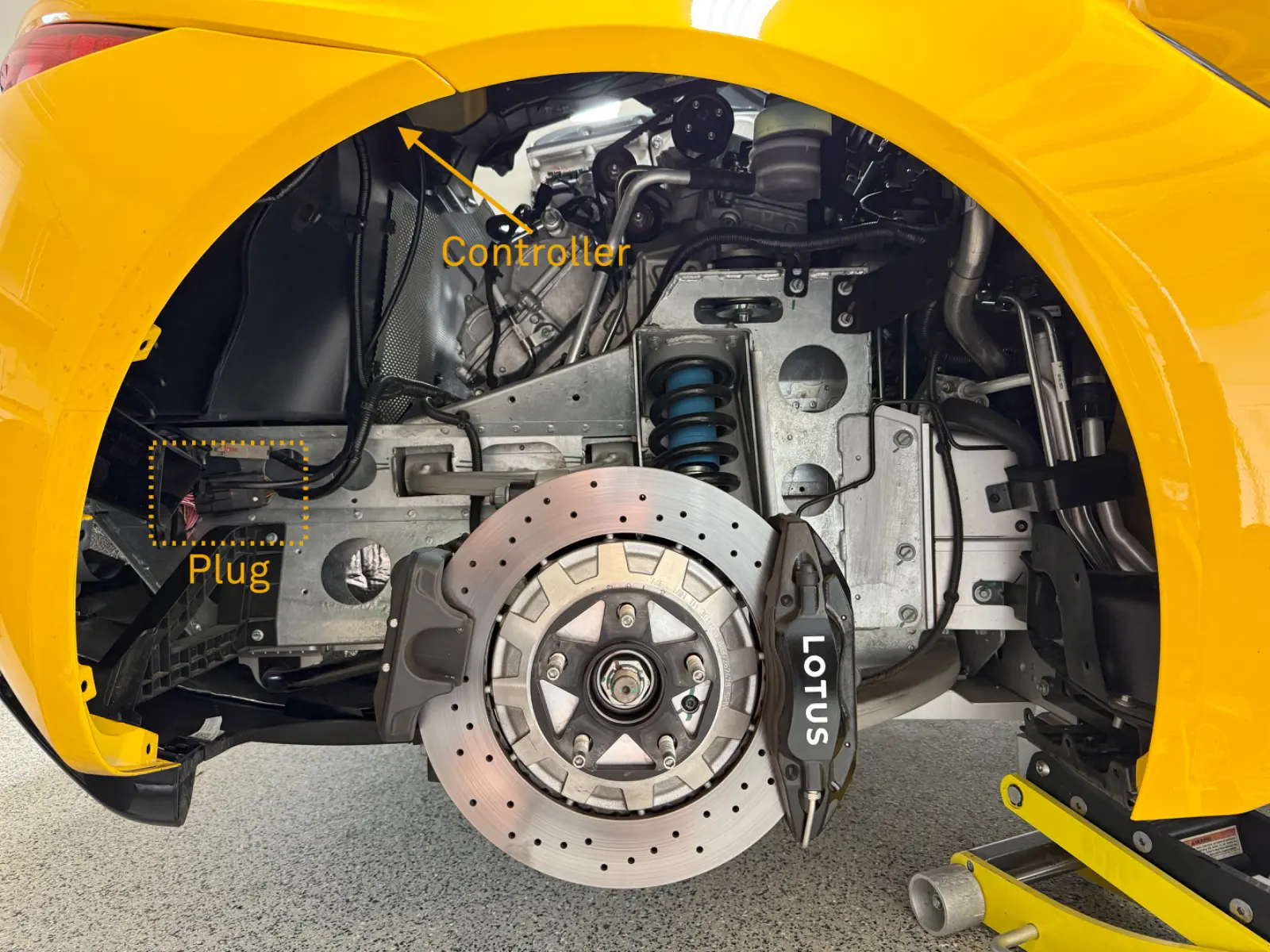

Anyone install V2 of the valve controller? Looks like it plugs in a different place. Wondering how much easier it is to install? I did not see any instructions on teh GRP site.
I was late to the party and have the V2. I never installed the first version, but this was really easy- just needed to remove the passenger rear wheel and fender liner. Attaches in-line and the controller box is mounted in a little nook that seems pretty isolated from engine/exhaust heat and moisture.

looks like it's much more elegantly located and installed. Instead of removing the entire back lower panel to gain access, which most likely requires jacking up the car. Looks like entry point to the valve controller is higher upstream and can be access directly from the rear right wheel. Merely requiring removal of the rear right wheel to install.
