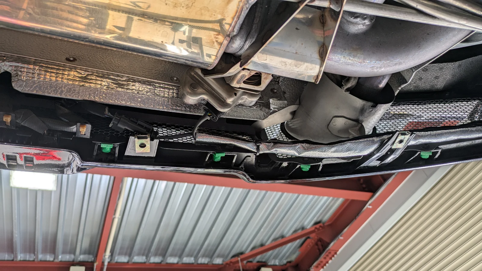

V1 had issues due to placement and getting melted by the exhaust. V2 is placed in the right rear wheel well behind the arch liner. It is quite safe here and I haven't had any issues since installing last year.

I still have a fully functional V1 with no codes that have ever come up. Countless hard canyon drives and a few track days in high heat. I have reflective heat wrap around the wiring and the module tucked away into the wheel arch area as indicated with the instructions on Grp's site.
