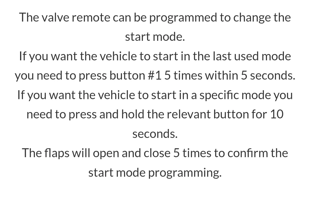

Yes, it's happened to me a couple times. Also be careful clicking the button a lot of times, I think it's something like five times in 10 seconds and it changes the way the controller behaves. Instead of remembering the last mode when you turn on the car it resets to the stock mode. I didn't realize that the first time that happened and I was so confused.
Interesting. My controller never remembers the last mode and always starts open. Maybe i did the reset. Any idea how to fix it?

Press #1 button 5 times within 5 seconds.
Resetting the unit is not easy and a physical button inside the unit. I've done the deep dive on this unit having programmed my own custom valve controller remote.
