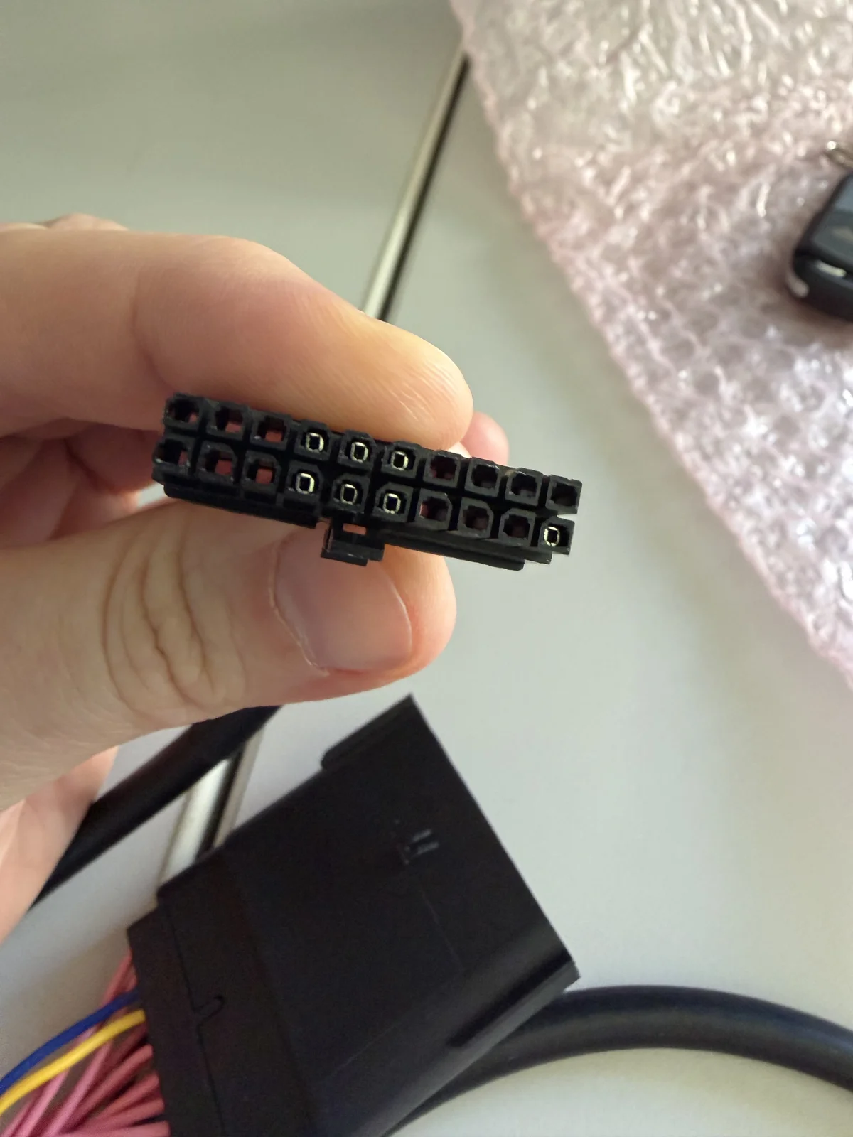

Grrr, paper clip isn't doing the trick for me, all of mine are too large for the 20pin connector.
Bought a pin tool set and none of them fit the connector.
Kinda looks like a ATX 24 pin connector for a computer, but much smaller, and only 20 pins. None of which I have a pin tool for.
@Milk242 What size pin tool did you use?

Just a reminder. If you are going to attempt this and are using a box that will require you to de-pin the harness, do NOT get anything but this tool:
I tried 2 tool kits before this one, 100% junk they screwed up my receptacle to the point where I had to re-crimp 3 terminals, and buy a new receptacle since it damaged the original.
The one below fits perfectly into the cavity, and the plunger will pop the pin out in 1 seconds with an incredibly satisfying click. All the others require you to fit an ill fitting de-pin tool in there, then yank on the wire.
