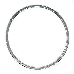

GRP pipe requires a new ring too dont forget. the others might too, cant say for sure but i would assume so
not sure what Lotus uses for gasket rings but it appears to be some kind of braided metal. Mine was toast and was happy to replace it

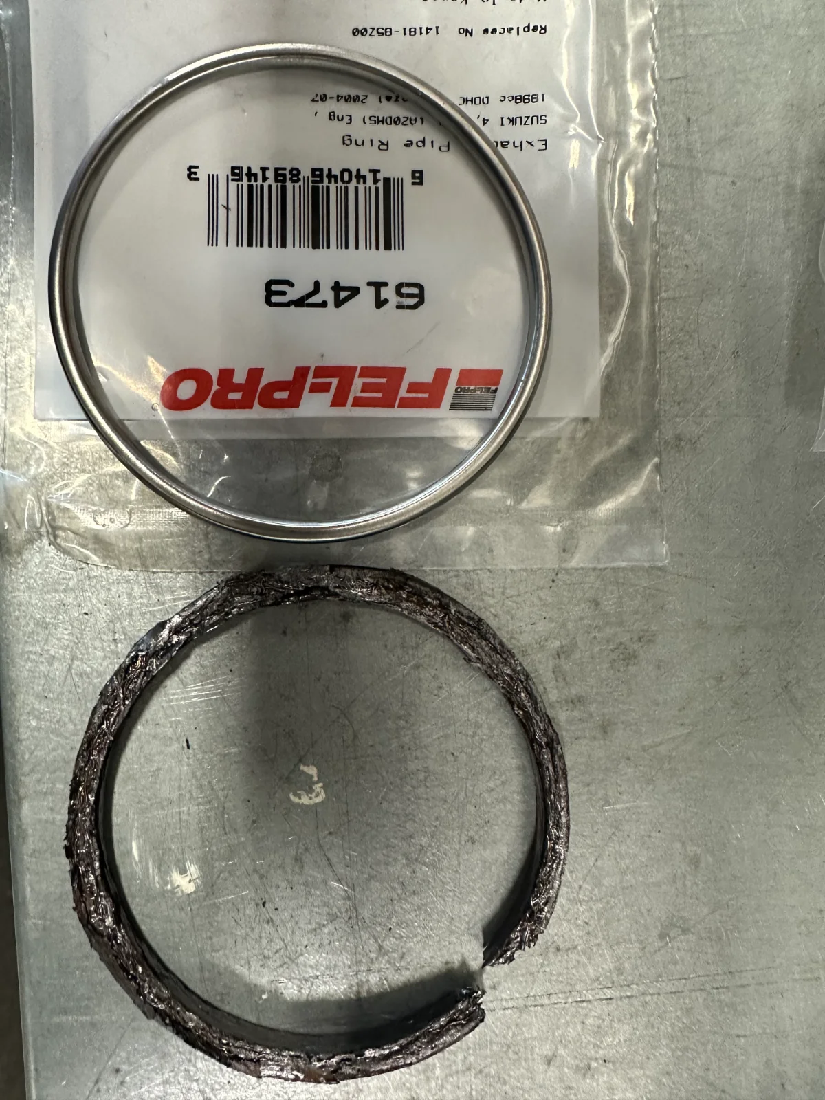

When installing the GRP third cat delete, my OEM Lotus exhaust gasket (a braided material) needed replacement, after only about 2,500 miles (4,000 km). See photo below, of both the old and the new Fel-Pro replacement I purchased from GRP. The old one likely fractured in the one area, during removal. I'd suggest always having a replacement handy, given its low cost of about 10 bucks.
