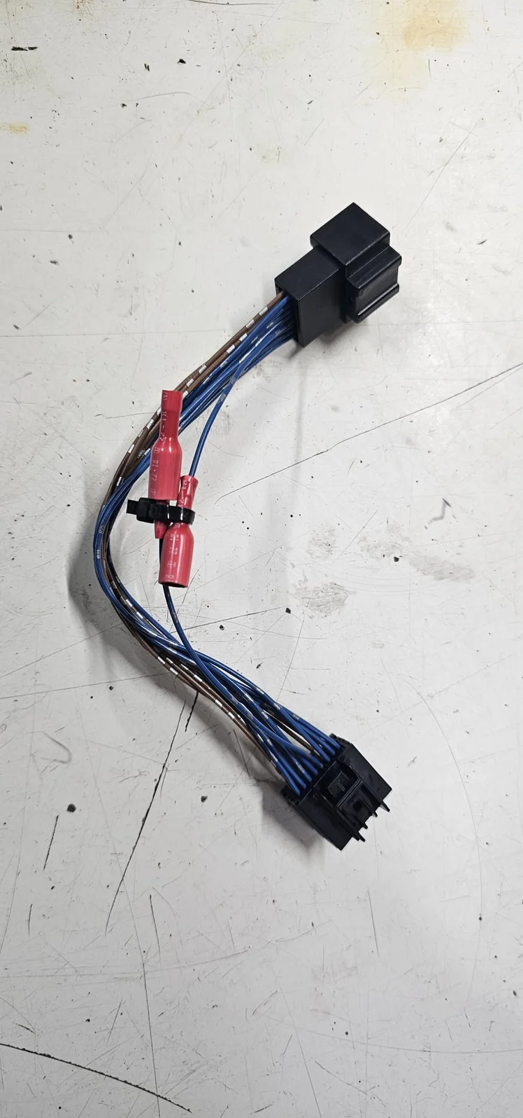

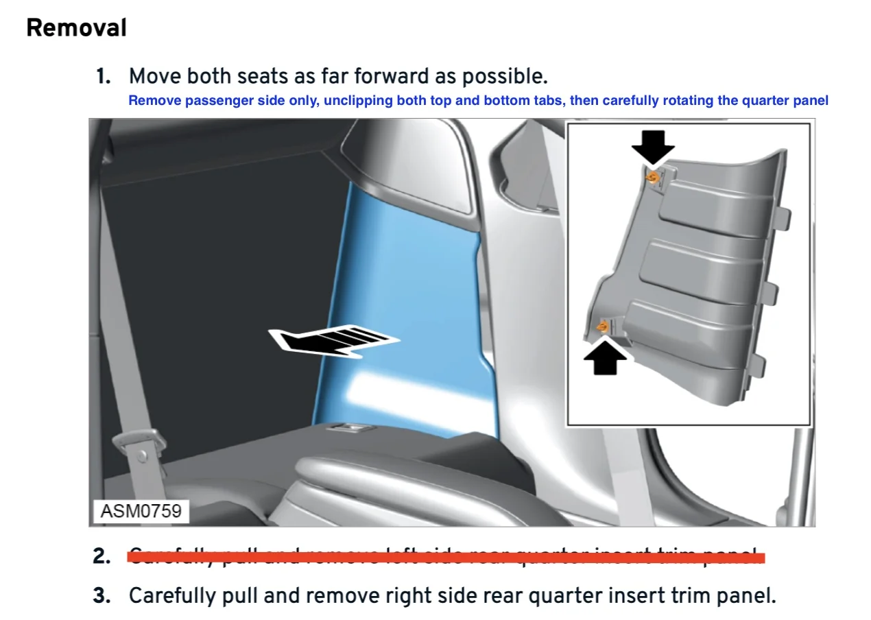

I opted to use the solution proposed by Milk242, as I found this to be the most elegant and 100% reversible. The bypass cable was purchased from the Chinese express site, The fourth cable (green and blue) was cut and fitted with bullet connectors to ensure no contact with other components.
Disconnected the original and inserted the bypass.
Road test is positive, it could be a placebo effect, but I do not think so.
A temporary/permanent modification that is well worth while, and takes the boy racer out of the car.
