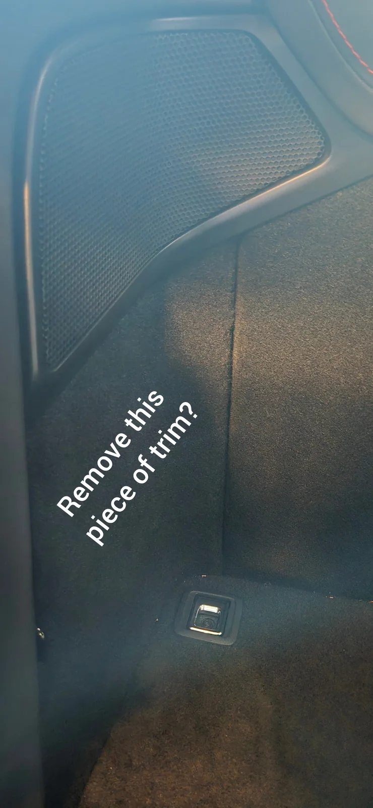

So, the only panel needed to be removed is the one behind the driver's seat? Just want to verify. I might record a video tutorial showing how to depin if you guys want.
Drivers seat.... depends on what side your steering wheel is located ;-)

Which piece of trim am I removing?
I got two clips popped out on the trim, but the trim doesn't want to come out.
