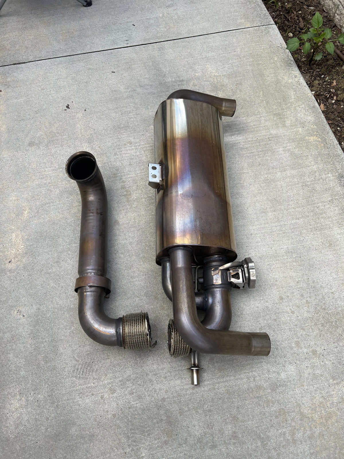

First obstacle, the OE i4 exhaust is big and has an additional mounting bracket dead center. See pic…

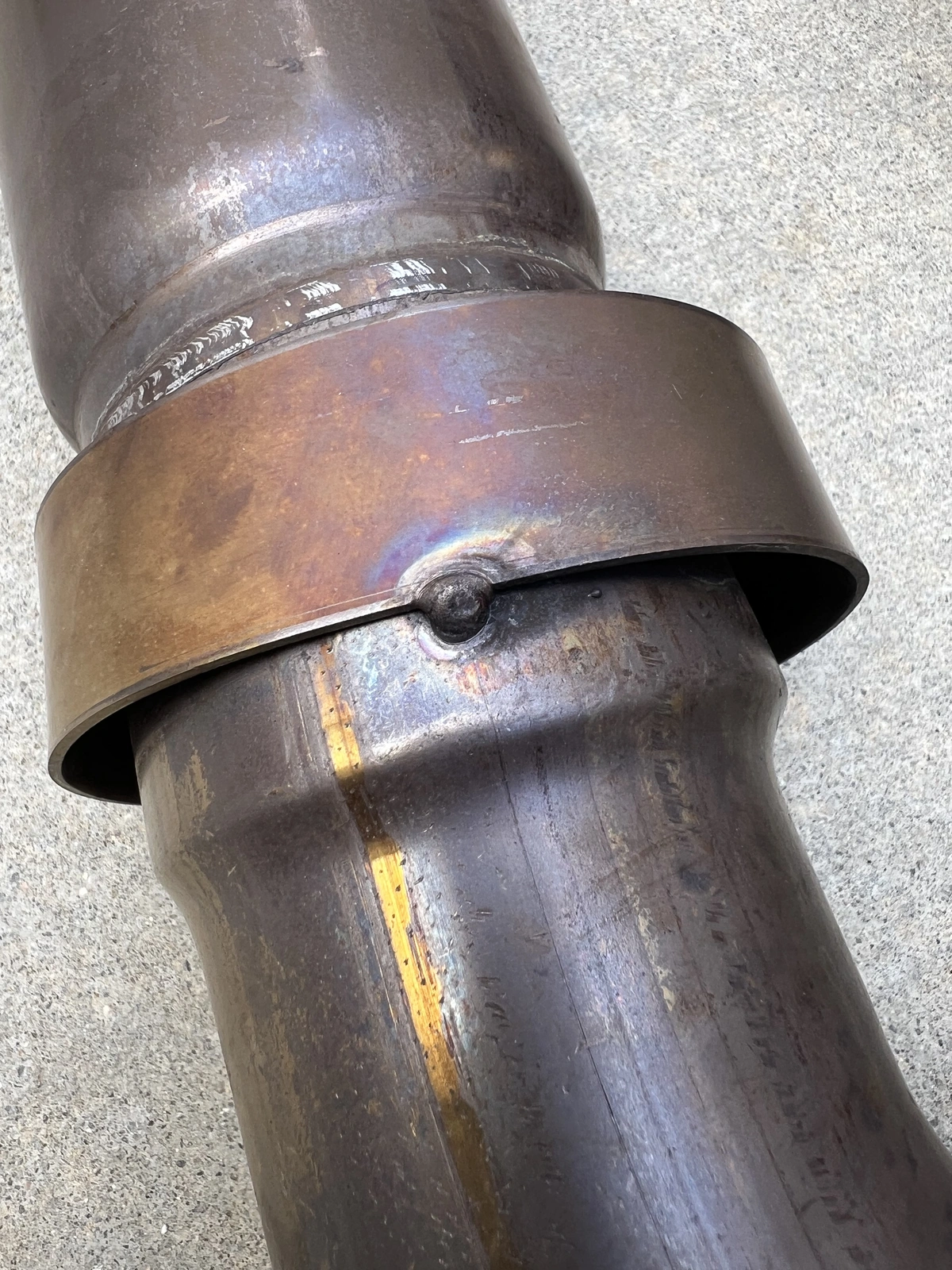

Next problem, the OE decat pipe (no third cat on i4) has a spot weld that unfortunately goes through the pipe making it essentially un-removeable. See pic…

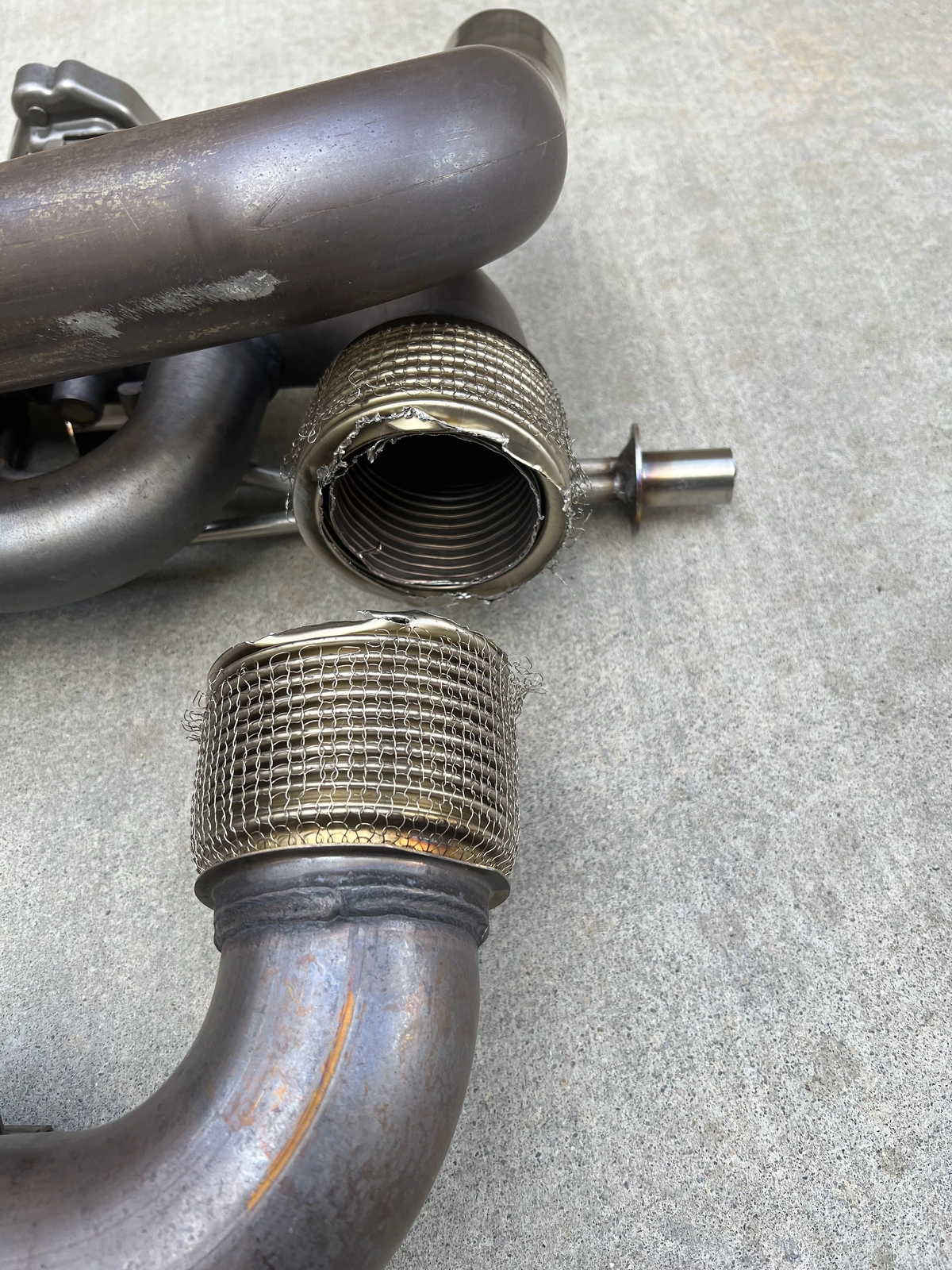

Now next problem, because we couldn’t remove the decat, we couldn't squeeze the exhaust out. So after an hour of twisting and turning, I made the call. Reciprocating saw! See pic…

First obstacle, the OE i4 exhaust is big and has an additional mounting bracket dead center. See pic…View attachment 63324
