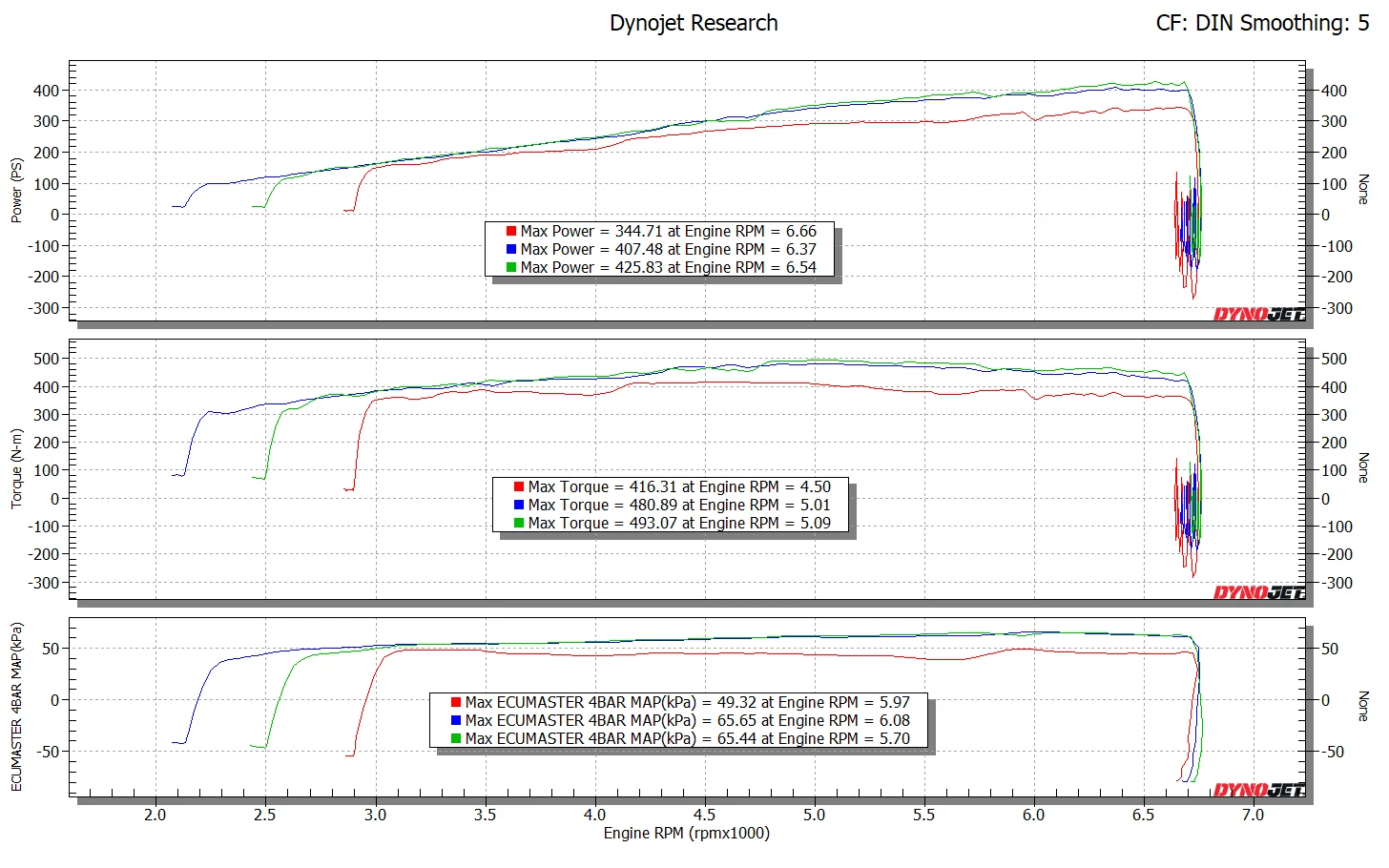

Real life EMIRA V6 measurements at the wheels using Japan (Nagoya area) pump gas. Hope this helps any V6 owners on the fence to decide what they want to do with their cars.
All done within an hour on the same day. Boost figures taken from an extra sensor attached to the supercharger (not calculated or OBD2 data). Modification is 3rd cat delete only, exhaust valve operating in OEM mode)
  • red: JB4 map 0 (OEM)
  • blue: JB4 map 1
  • green: JB4 map 2

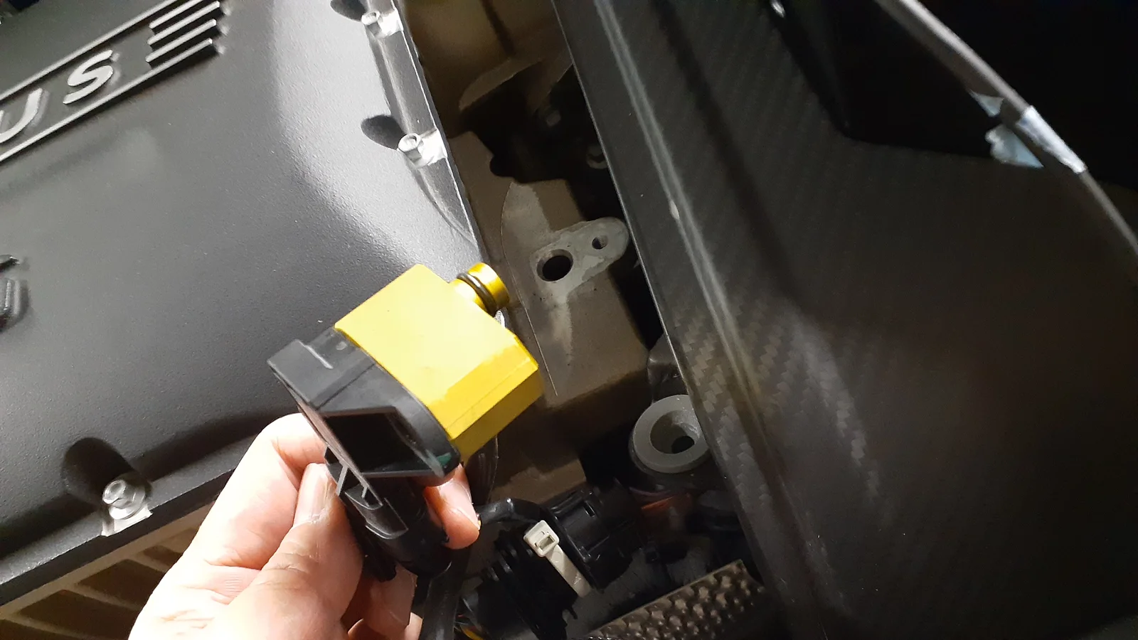

The boost pressure sensor, and where it plugs in:
Wow.
That’s almost enough to make me just buy a JB4.
About the only thing I’d say is the OEM values look pretty low.
I got 380 rwhp / 442Nm on a Dynojet totally standard car.
What mode are people using for their runs?
“Sport”, “Track”?
Does it make a difference?

From the graph it looks like you are assuming 16% transmission loss (taking the 344 at wheel on stock). So this is giving you close to 475bhp (power at crank) on map 1 with the JB4. Is that map1 with standard unleaded fuel?
The dyno figures should not be taken as absolute values. I just use the numbers to see the deltas. The only thing I took away from this session is that the JB4 showed constant boost increase and added over 80 horses over OEM on this day using this fuel.
“Sport”, “Track”?
Not sure if it makes a difference at WOT, but used Track mode.
I stay away from calculating / guestimating crank power from wheel numbers. As for fuel used, it is what is branded as "high octane" in Japan, which requires "at least" RON96. The actual octane content may vary from pump to pump, and you may get RON98 or better in some places.

Great information, thank you for sharing. These numbers are definitely in alignment with how JB4 "feels" compared to stock. I'm not surprised that there is a ~80bhp HP increase because the instant power increase when toggling on/off JB4 on the fly is significant, not just "noticeable". It truly takes the car from "this feels quick, but not altogether punchy" to outright "this is plenty of power" in my view having been running JB4 Map 2 24/7 since last summer.

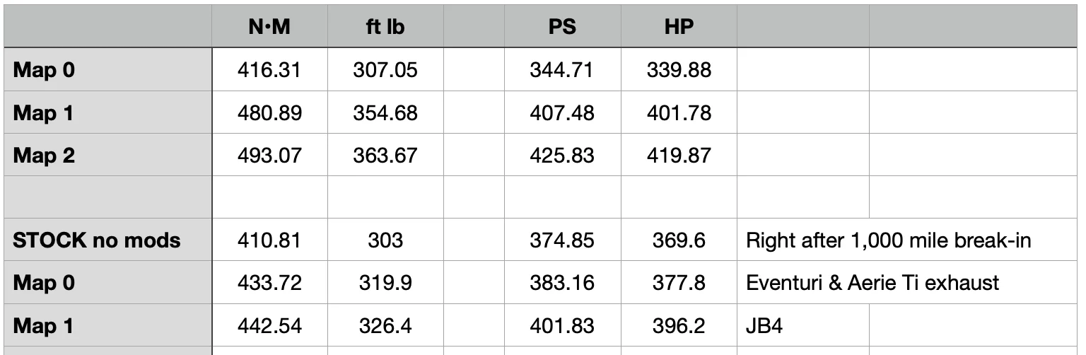

Translating your numbers into ft lb and hp for those of us in the U.S. The metric value PS is equal to .986 HP. For comparison, I put my numbers in below yours. I had a baseline dyno done right after the break-in period when my car was completely factory stock. The JB4 Map 0 and Map 1 numbers are with an Eventuri and Aerie Ti exhaust installed, but the 3rd cat is also still installed.
I'm surprised at how low your Map 0 number is for power; a full 30 below mine. I don't see that as drivetrain loss since yours takes a big jump to Map 1. That has to be a factory tune result. The fact that you were able to get such a noticeable increase to Map 1, and a further increase to Map 2 tells me you're running at least 93 octane U.S. I can't get 93 where I live, so I only have 91 available.
Your Map 1 is within 5 hp of mine (401 vs 396) but that's with mine having an Eventuri and Ti exhaust. The biggest difference is torque. Yours stock is within 4 units of mine, but on Map 1 yours takes a huge jump, which is what you'd feel accelerating. I only gained 23 ft lb over stock while you gained 56 ft lb. That's a big difference. You've gained an additional 28 ft lbs of torque compared to what I got on Map 1, but I'm running actual 91 octane. It looks like you're just getting better fuel than I am, which is not surprising. We're getting watered down E10 where I live, and from what I'm reading it looks like it's going up to E15 beginning May 1st.
Your chart shows the same thing I noticed with mine, which is how much smoother the engine runs with the JB4. It smoothed out the dips at 4k and 6k rpm, and overall is just smoother and more consistent. Thank you for posting!

Awesome! This is ideal dyno comparison runs, the conditions are identical and a critical thing like the boost is measured all back to back. Great info and nice work on the boost referencing!

Do you more info on the external boost pressure sensor adapter? I was looking for one to add as a gauge input. Ended up modifying one from a different application.

You are forgetting different dyno's read differently.
His runs went from 344whp to 425whp.
